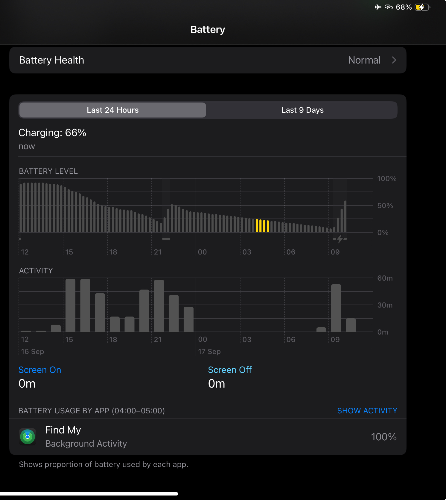

Thank you, never really had to look at it before, I have found this…
Dropped 40% overnight with everything turned off, there is no app activity on the battery settings. Cannot seem to hard restart my iPad. I guess it could be iOS? But this iOS 18 is the current version..
