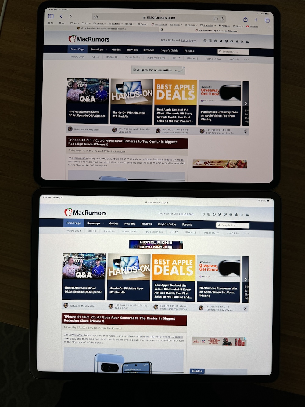

Just got my M4 iPadPro 13" and finished set up. Regardless of whether I have auto brightness on or off, true tone on or off, etc., my M4 iPadPro is disappointingly dim. On the middle brightness setting, the iPadPro looks very dim. It only looks usable when I have it at or near max brightness. Compared to my M1 iPadPro with mini LED display, the mini LED display blows it away in brightness.
Is anybody having the same experience? Or do you think my M4 iPadPro is defective?

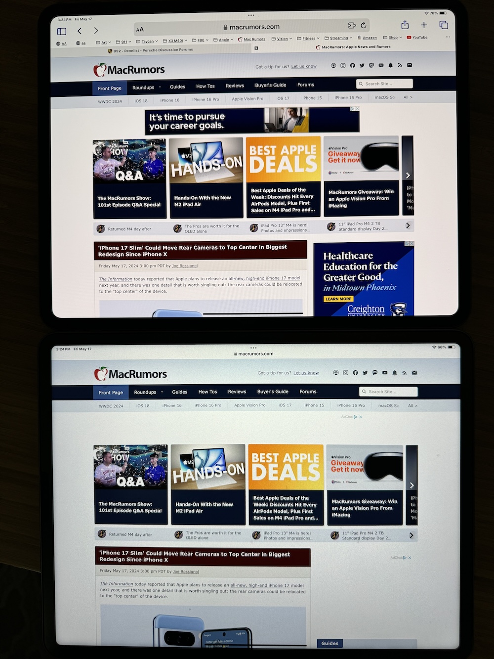

Here's the comparison. Auto brigthtness, true tone, night shift all off. M4 OLED on top, M1 mini LED on bottom...
This is with both screens set to middle brightness. M1 iPad (bottom) looks a good 50% brighter in real life:
This is with M4 iPadPro (top) on max brightness and M1 iPadPro (bottom) on middle brightness setting:

Glad you got that sorted. I used to have that setting on as well. One thing I noticed from your photos is that the M4 display has way better white balance and is overall more pleasing to the eye (assuming other settings like True Tone are even on both). The M1 has a bit of a green/cold cast. I am very sensitive to even the most slight green tint, which is very common in most displays, so this is probably not noticed by many.
