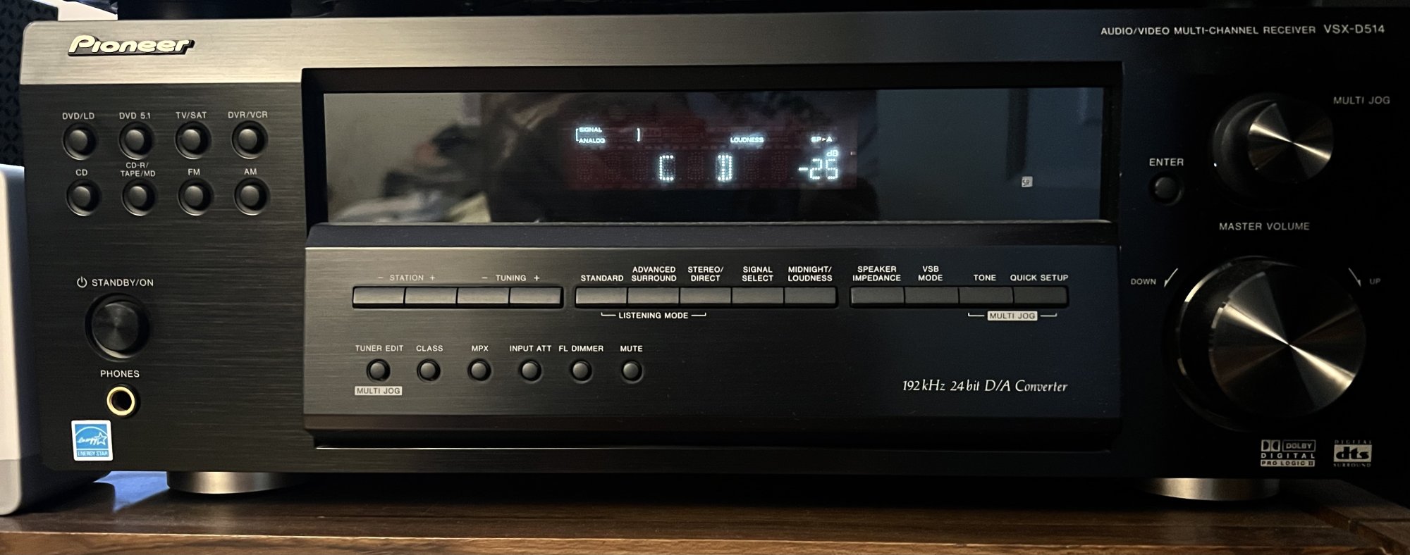

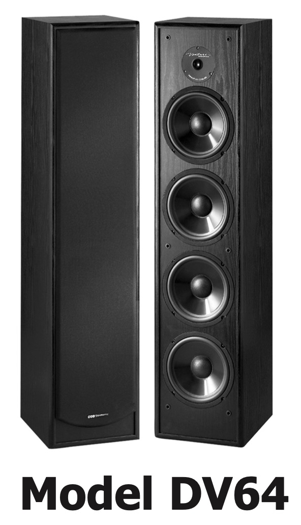

Thanks for the comparison. I connect via shielded cable the headphone jack on my M1 Mini to my Pioneer VSX-D514 receiver which powers 2 BIC DV64 tower speakers. The sound is very satisfying compared to my Sony WH-1000XM4 headphones which are very good but I prefer the tower speaker sound which feels more like a concert arena which headphones don't provide for me.
Here is the question: is there any great advantage to output another way like Toslink digital?
Couple of things ; first of all the headphone socket in the Mini is not designed to be an 'audiophile-grade' line-out: it's a headphone socket, which means there's a small power-amp tagged onto the end of the DAC to raise the volume level to something sufficient to drive headphones. So what you're feeding into your hifi from that socket is not exactly the purest analog signal straight from the DAC.
Second thing, and even discounting any degradation brought about by the 'post-DAC' amplification in the Mini, very likely the DAC in your Pioneer AV receiver will sound considerably better than that in the M4 Mini anyway.
TLDR: yes.
What is the input to your receiver? If it is R/L RCA plugs, then it is likely your Mac mini was sending line-level signal because it has an adaptive audio-out port.
The big advantage of Toslink optical connection is that you let the receiver's DAC do the conversion. It also allows signal processing that you cannot get via 2-channel line-level inputs. For example, while most of my audio files are 2-channel, I have some 5.1 files that if I pass to my Onkyo via optical, the receiver will decode those 6 discrete channels for better sound staging. You can certainly get simulated surround from 2-channel audio (e.g. Dolby or DTS processing) but the separation isn't as good. So, my opinion is that if you have the ability to input to your receiver via optical, coaxial, USB or HDMI/DP/mDP, then that's the way to do it. But of course, there may not be any discernible difference in what you hear because there's only so much that we humans can hear.
What was the input to your receiver? It it was R/L RCA plugs, then it is likely your Mac mini was sending line-level signal because it has an adaptive audio-out port.
Yes, RCA plugs input to receiver.
I have a Toslink cable. So I just need to buy one of these USB to Toslink adapters? If yes, do you think USB A or C or doesn't matter?
Thanks for your feedback
I have not used one of those before so I cannot comment on it. It looks like your receiver is a bit old, around 2010? You should check to see what file formats it can decode. I only rip to Apple Lossless or AAC. You should verify your receiver’s DAC can decode whatever file formats you use.
I do not like Toslink. Coaxial digital is just as good and the cable, and the jack is much better than the optical cable and jack.
Oh jeez, good point. Receiver manufactured in 2004! Manual states "This receiver can only play back Dolby Digital, PCM (32kHz, 44kHz, 48kHz, and 96 kHz) and DTS digital signal formats. With other digital signal formats, set to ANALOG". But shouldn't it work because I used to play music through it when it was connected to my AppleTV 4K with Toslink cable from my LGOLEDC1 TV to the receiver?
If I understand you correctly, your Apple TV was connected to your LG TV via HDMI cable, and your TV was connected to your receiver via Toslink cable. And there was no connection between your Apple TV and your receiver? So:
Apple TV out > HDMI cable > LG TV HDMI in
LG TV out > Toslink cable > receiver
Is this correct?
Is this correct?
@Cave Man That is correct.
@transmaster Yeah I just bought a new Denon AVR-X1700H for my ATV and LGTV. That AVR replaced my Pioneer receiver which I moved to my Mac Mini M1 to power my tower speakers as mentioned in above post. The cost to buy a new AVR for my home office seems too high for a marginally better sound experience, assuming my ears would detect such. I'm interested in a small investment replacing my analog cable with a digital cable to my Pioneer.
I think the best thing to do is what you are doing now; 3.5mm from Mac mini to RCA R/L input. Looking at your receiver's manual online, it has Dolby ProLogic II and a "5-Channel" audio setting that I'm not familiar with. But because you only have two speakers, it probably isn't worth the effort to get the Toslink adapter because the signal processing that your receiver does will pretty much be the same regardless of analog (RCA) or digital (Toslink) connection.
