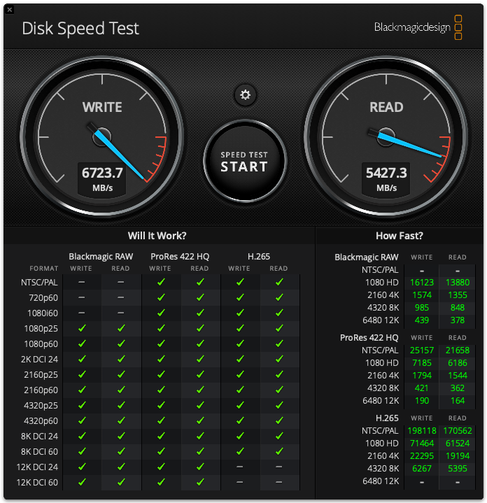

5427.3 Read / 6723.7 Write
2TB SSD results from fstoppers.com review of the unbinned M4 Pro model.

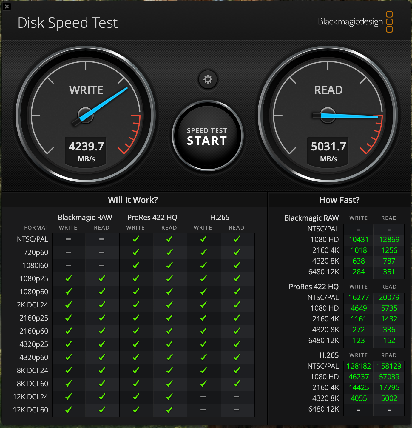

3318.6 Read / 2899.5 Write
1TB SSD (Blackmagic Speed Test) results from tomsguide.com review of the M4 model.
