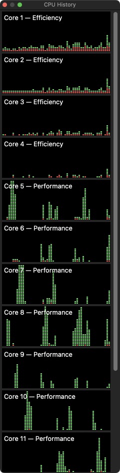

I recently moved from a 16" M1 Pro MBP to a 14" m4 Pro MBP and it seems like the power drain on the M4 Pro is much faster than on the M1 Pro! It's not a case of me pushing the machine and quite frankly, I initially attributed the power drain to me working in Capture One Pro. It turns out that even when I'm barely doing anything, the power seems to be running down at an amazingly fast rate.
It's not an indexing thing. This machine's had plenty of time to index.
I could go all day doing everyday computing on my M1 Pro. I don't think my M4 could do even 6 hours. I suspect there's some software related bugs here, but it's still a bit disconcerting. Has anyone else noticed the same drop in power performance?
My Activity Monitor output is really curious. Even in low power mode, some of the performance cores are hitting 100% usage every few seconds and this is after I've quit all programs and I'm not doing anything.
In the Energy tab of Activity Monitor, WindowServer is very active. I'm a heavy user of spaces and it goes through the roof when I swap screen spaces, but even when I just sit there and stare at the screen, it's still very active.

FWIW, after I rebooted my M4 Pro, everything's back to normal and I'm back on track to get 10-12 hours if I'm just doing everyday computing and 8-ish hours doing my typical daily work that involves photos and crunching software.
So the M4 isn't more power hungry. It was just that something was wrong. After I rebooted, I stopped seeing performance cores spiking to max levels for no good reason. I also saw the efficiency cores handling nearly all of the load.
I have some thoughts about what may have caused my issues. For one, I turned off the switch that throttles low priority background processes the night before and spent 8 hours backing up my new 2TB drive to a Time Machine network drive. I did turn the throttle back on though so that shouldn't have been the cause of my weird power issues, but it wouldn't be shocking if it remained stuck in max power mode until after a reboot.

Re cores running to 100% in activity monitor briefly on low power mode: the percentage is of the current clock speed. On low power mode the clocks are lower. Also, better to run one core at 100% briefly and then sleep the whole cluster than spread the load over more cores or at a slower rate and have to keep the cluster(s) powered up for longer.

It was a software bug that was fixed by a reboot. I'm back to getting 10-12 hours doing everyday computing things and 8-ish hours doing my everyday work.
I have one idea what could have caused it. The day before, I needed to perform a full Time Machine backup of my 2TB drive to my NAS so I disabled throttling of low-priority processes from the command line. It took 8 hours overall, but 12 hours total due to some interruptions caused by accidental disconnects.
When I was done, I turned throttling back on. Either switching throttling back on didn't work until I rebooted or something else went haywire.
I'm not exactly sure what this does:
sysctl debug.lowpri_throttle_enabled=0
But I presume that it might be similar to setting the computer to Max Power.
I was disabling background tasks, quitting anything I could, and force quitting background processes like crazy and it wasn't doing a thing. I basically had my M4 Pro stripped down to its underwear and it was still acting like I was running stress tests on it... but the reboot fixed everything.
