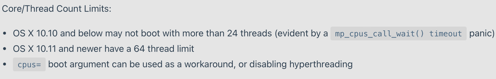

Since the thread limit for macOS is 64, and hoping for a quad chip configuration (Mn Extreme) at some point, I would think the Mn Max would stick to the current 12P/4E (16 total) CPU core counts; dual chip gives one 32 cores & quad chip gives one 64 cores...
What's the source of the 64-thread limit, and how fundamental is it to the OS—would allowing more than 64 simultaneous threads require a minor rewrite, a significant rewrite, or a complete overhaul to the OS?
Knowing that would tell us whether the current thread limit constitutes a significant barrier to Apple offering an Extreme with >64 cores.
[To forestall potential confusion from others: You may have read that MacOS can support thousands of threads, and that's true; but that's not thousands of simultaenously-operating threads, which is what Boil and I are discussing; the latter is limited to 64.]
Edit: According to https://dortania.github.io/OpenCore-Install-Guide/macos-limits.html#cpu-support , it seems one can go beyond the 64-thread limit....
It's not really an issue for Apple. If they want to ship a CPU with more than 64bit, they will just rework that part of the kernel and increase the limit.

We're discussing the max number of threads (and thus the max number of supported cores) for MacOS, not the number of bits. The number of bits is entirely different, and determines the size of addressable memory.
A bit of history (no pun intended!): MacOS began its transition to a 64-bit kernel with Panther, and completed it with Snow Leopard:
