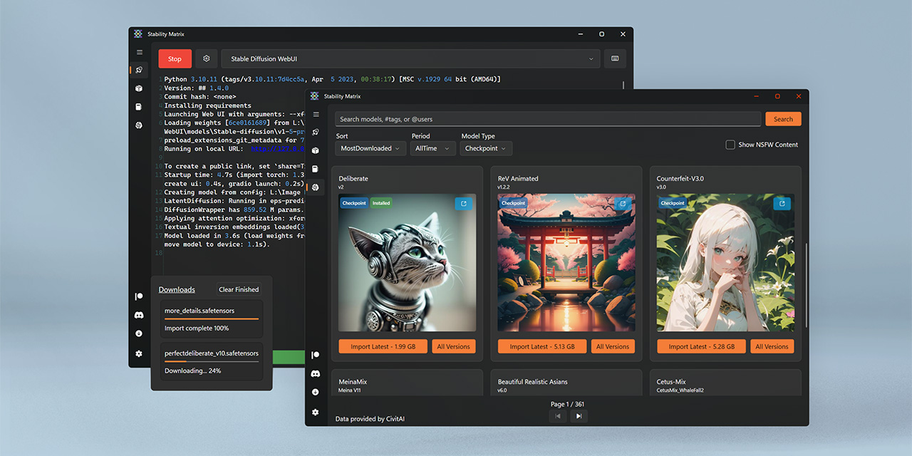

I wouldn't use Draw Things, it's frankly pretty ******. Stability Matrix will set up any of the major platforms automatically with MPS support:
As for performance compared to the CUDA backend for pytorch: it's bad. If this is what you mainly intend to do then using the money for a 3090/4090 is a better use. It's anywhere from 2x to 4x slower depending on the LORAs you're using, from my experience. (I have an M4 Max Studio with 128GB of ram, and a system with an RTX4090 FE fwiw)

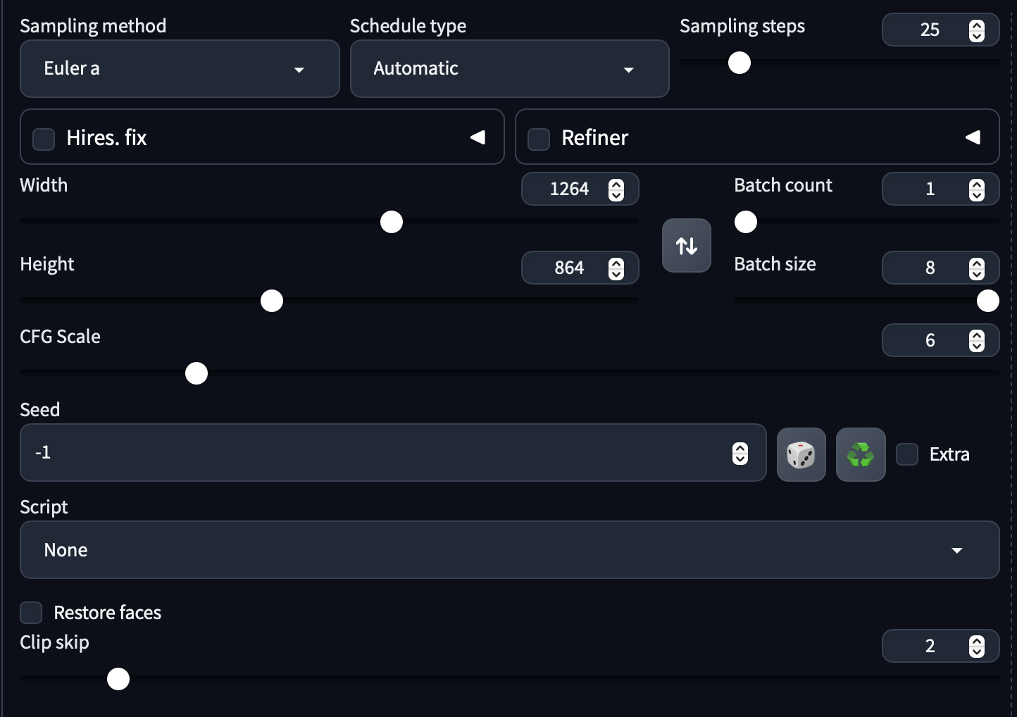

Here is the same exact prompt and settings on my Studio M4 Max (40 core GPU, 128GB ram) vs my system with a 4090. This is IllustriousXL with 5 LORAs and fairly large so it's a pretty good representation:
4090:
M4 Max:
  • Love
Reactions: mjs916 and pksv
4090:
M4 Max:
Thank you sooo much 🙌🙏🙏
I see batch size 8, so for one image around 11 seconds on 4090 and 42 seconds M4M.
Wow, this is indeed v bad. Even half speed would be acceptable for me but not 1/4. The waiting time will add up very quickly.
