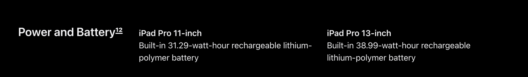

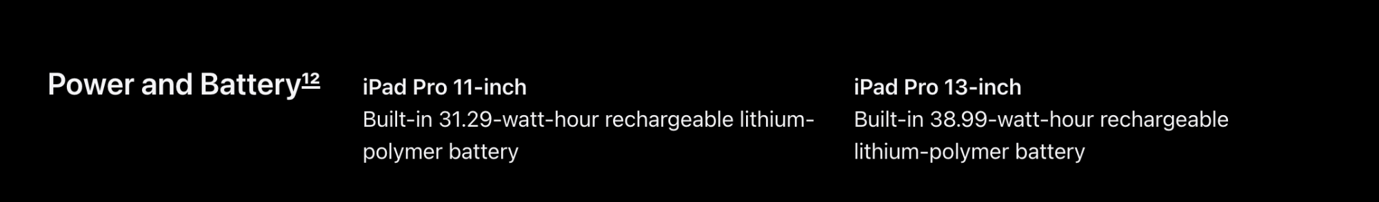

According to the Apple website, the battery capacities are 31.29 WH for the 11" and 38.99 Wh for the 13" I think this is similar to the previous model so, expect the same battery life as always, fluctuating between 8 to 12 hours depending on usage.
