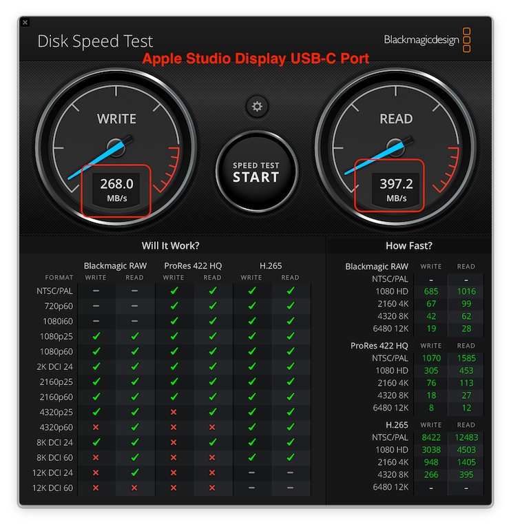

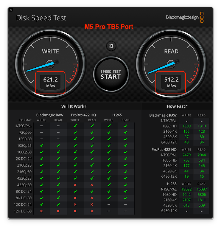

As an example, I have a Seagate 2TB external USB3 SSD (SIDE NOTE: I bought the drive for $129 on Amazon in December 2023, now it is on Amazon new for $649!!!! This timeline sucks for memory and storage). Here are the results when it is plugged into my MBP and when it is plugged into my ASD. Be aware that the speeds are slower in the ASD vs using TB in the MBP. If you are ok with that, you're good to go. P.S. Other option is a TB hub as mentioned above.
Write 131% faster in TB5 vs ASD USB-C
Read 29% faster in TB5 vs ASD USB-C
