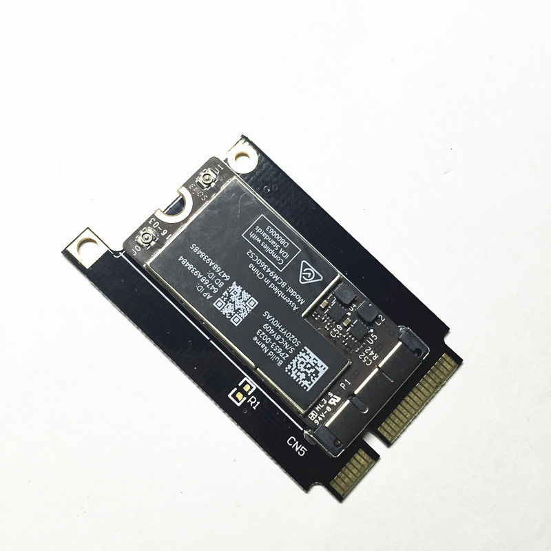

I have a Mac Pro 2008, and recently bought a new BCM94360CS2 card to enable hand-off/Continuity. If I am not completely wrong, I believe the new card which has both 802.11 and Bluetooth, the 802.11 goes over Mini-PCIe while the Bluetooth goes over a USB interface, in which case, I believe I need a USB connector to splice into for the Bluetooth portion of the card.

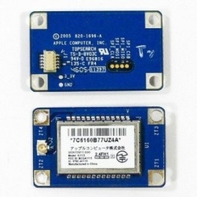

I know the original Bluetooth card (MA687ZM/A) operates through a USB interface, but it uses (what I assume is) a custom 10 pin interface. Is there anyone familiar with the Mac Pro 2006-2008 Bluetooth card that would know which pins are USB D+/D-?
