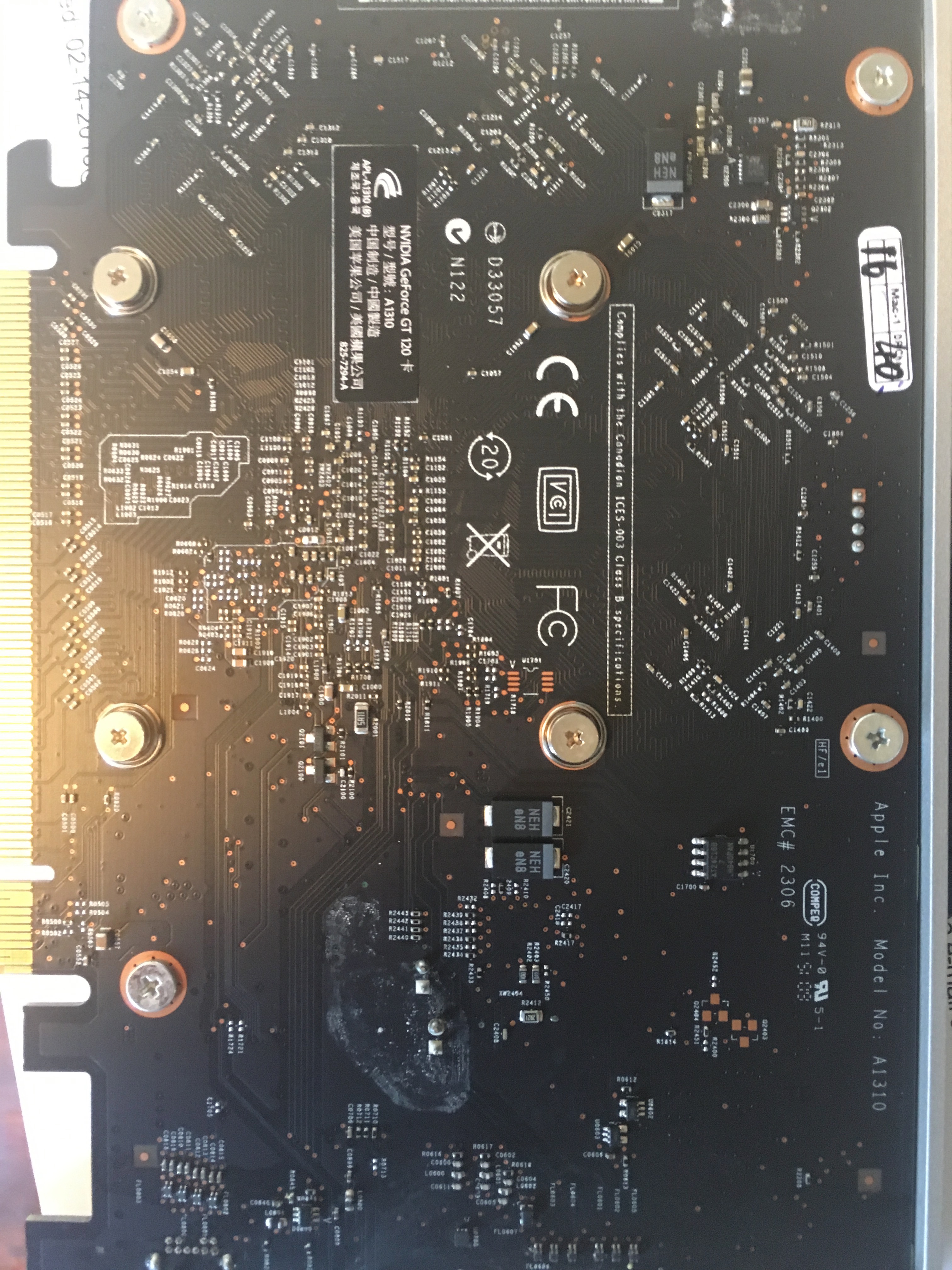

Is the GT120 a PC card, or an official Mac card? Believe the official GT120 Mac version only has Mini DisplayPort and a Dual-Link DVI ports with a large vented case/cover incorporated with the fan assembly.
My card is official Apple, I attached a picture for reference. I am using a DVI(to Mac) to HDMI(to monitor) cable that I used to use for my old PC. It could be the cable I guess. I just discovered (while typing this) that when I plug the mDP and DVI at the same time the GT120 was extending my desktop (face palm) so I just adjusted it to mirrored and now I have both cables connected. I still don't know why the DVI isn't working on my 27" Asus 2K monitor. I think I should try a proper DVI to DVI cable first. I wouldn't really care so much except for getting into the EFI.

is this going to be a problem with DVI to high res displays or a HDMI cable that cant deliver 2K resolutions ?
DP out is better than DVI if it's an option. DVI has the single DVI/dual DVI + problems at high resolutions (i think still on 1080p 😳)

I just need to get my hands on a 24 pin dvi to dvi cable. Then I can give a fair test. The DP is my preferred connection too but I just don’t know why it doesn’t output the Apple logo at boot up. Something to do with the 2K output? Maybe the basic drivers during boot up don’t support it? (After all the Mac 4,1 is from 2009)
well you dont need to see the apple logo at boot, iv been using a PC GPU for 5 years+ now and not seen the apple logo since then with no problems.
why dose the apple logo need to be seen ?
if it was me id just use DP and be happy.

You're right. It doesn't really matter except when I first got it I needed to do a bit of work in the recovery boot to turn off and on SIP to enable the 5,1 flash and I had troubles getting my SSD to work as the primary boot after cloning with CCC. So it was a total pita to have to keep swapping cables between DVI and DP as the DVI stopped working once I got to login.
However this has all changed now. (well almost - DVI still doesn't work after booting into OSX) BUT the DP started working yesterday. I did two different things that may have effected it. First I did an incremental (seemingly) non-related OS update. The other was I swapped out my RAM from the stuff in there when it was shipped (ECC 1066 corsair and another unbranded) to some 1333 G-Skill that I stole from my PC. I wanted to see if there was a noticeable difference before I bought any more. Today I did a reboot and bam the logo is now showing up. I haven't yet tried to swap back the ram to see if there is a difference mostly due to (as you said) it doesn't really matter all that much 🙂
