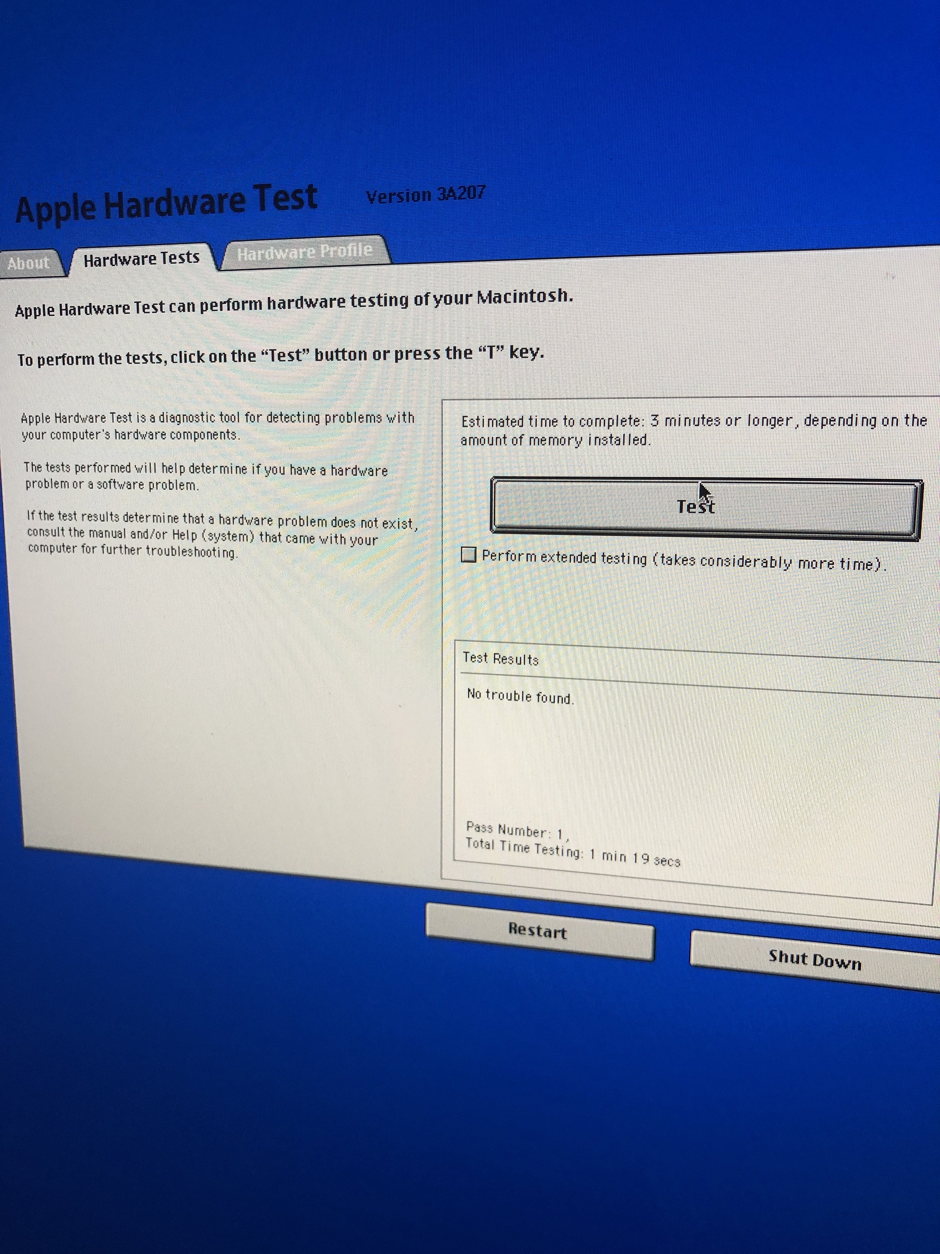

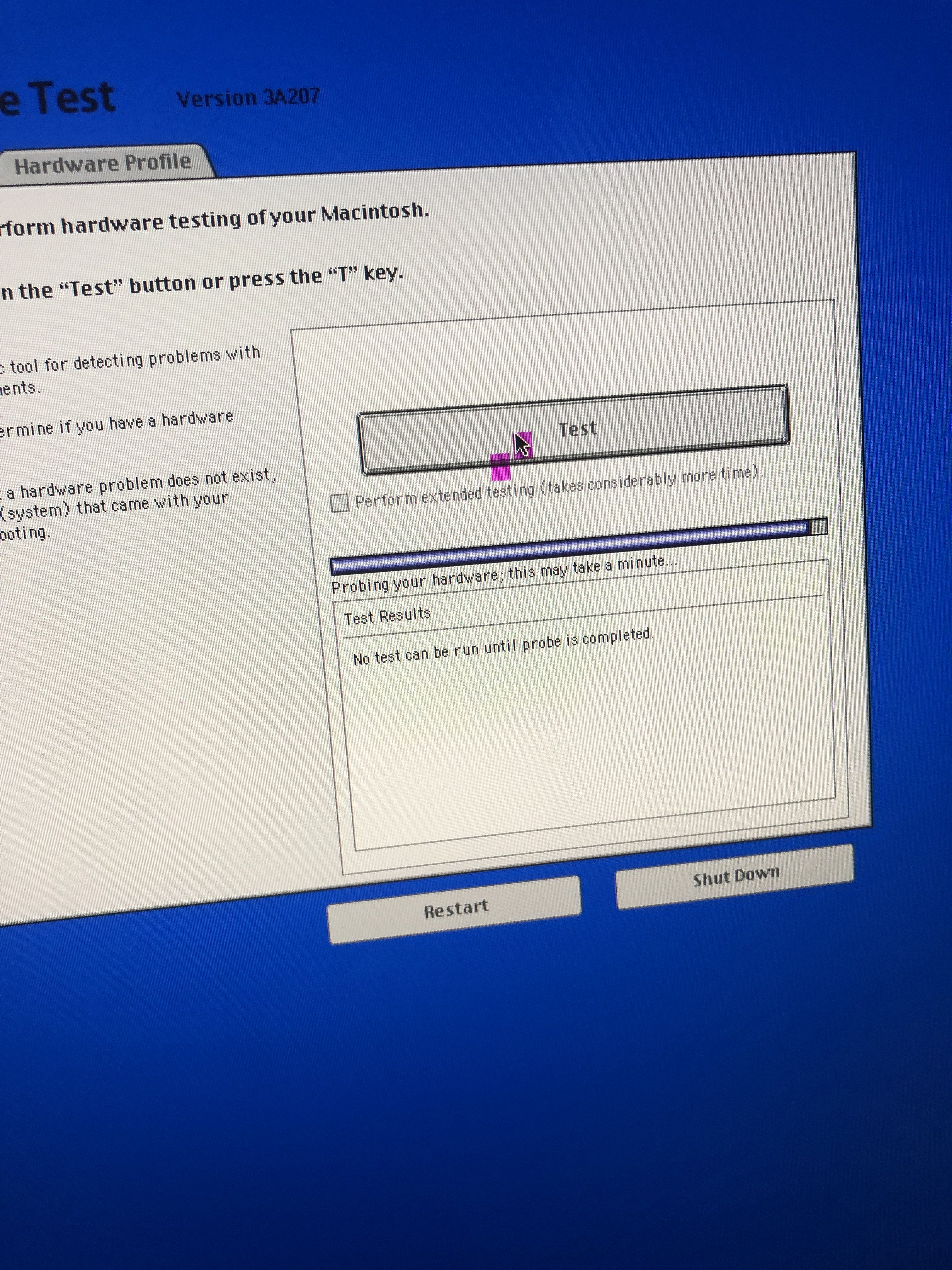

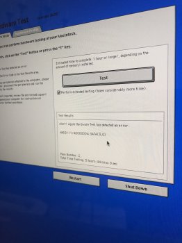

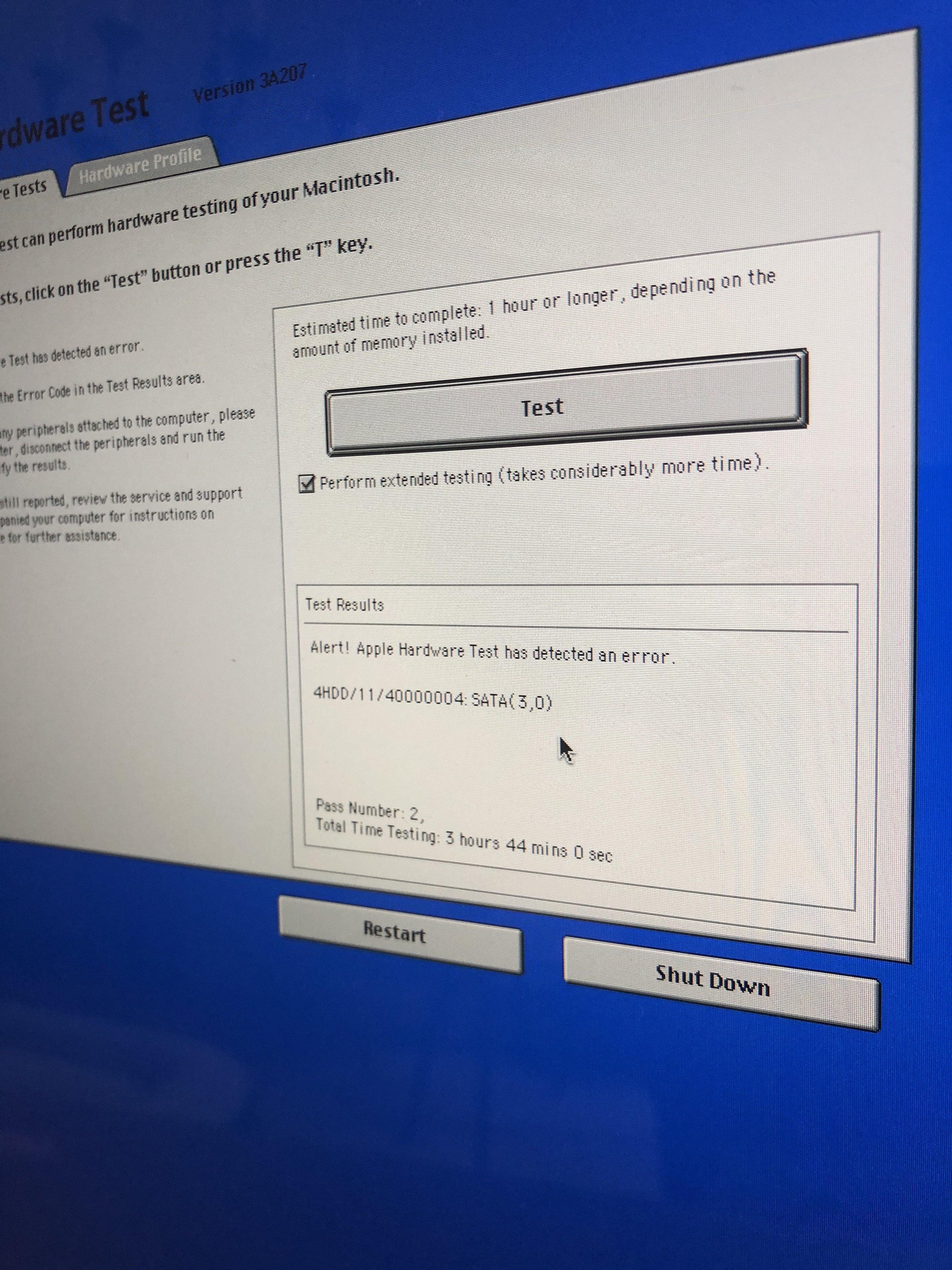

Hi guys,
I can't run AHT but I can now log in into Sierra. Everything works almost ok. Right now only wi-fi is getting disconnected. Also I had a chance to test RAM and all 4 modules are ok. Do you guys have an idea how I can test the hardware in another way?

Thank you for your suggestion. I could run AHT yesterday but I can’t run it anymore. I did not wait until the end because with all my memory it was taking too long. 2h and rly small progress. Wanted to shut down and restart with less ram but didn’t work 🙂
Yea you also said you had verbose booting at one point, therefore your card has UGA, so I doubt that's the case.

I have tried different keyboard but still I can't access AHT. With D pressed it takes much longer to boot (white screen)
but I am getting apple logo instead of AHT computer icon.
Verbose mode was twice when I was trying to boot with USB installer but without any success. Now all of it is back to normal. I am just sure that anytime I might still getting those issues again.

Flehman thank you too. I will try it. Anyhow I have some updates.
USB with AHT was corrupted so I could fix it and run AHT.
First try- some pink glitches (squares) and then freeze. I had to restart
Second try - quick test and success. No errors.
3rd try - extended test and error
4HDD/11/40000004:SATA(3,0)
I’ve seen it might be false error.
Anyhow I have removed 2nd and 3rd drive (ssd and hdd) I have also used aid
On main Ssd.
Btw does (3,0) mean it’s third bay?
4th try- extended test with one SSD.
All good, no errors.

6th try only 1ssd - graphic glitches and freeze before test.
I started to think it might be gpu.
Still no clue what it can be it is very random.

You should run AHT with the stock hardware only. Any 3rd party hardware (including your K5000) may cause erroneous result.
Yea at this point, revert back to my earlier statement, pull everything and go barebones. It's the old fasion way, but the best way.

Like I said earlier, AHT/ASD requires an Apple OEM to GPU run all tests. 3rd party GPUs like K5000 fails the GPU test.

And the AHT NEVER decided to handle K5000 regardless if that's Mac Edition or not. AHT won't able to understand / decode the parameters from the K5000 correctly. AHT won't even know what K5000 is.
AHT is very very very very very hardware specific. Even 4,1 / 5,1 has different version of AHT, cannot be mixed use.
If OP want to know the cMP is working correctly. He should revert the cMP back to the original factory config, including DIMM, HDD, GPU. Any deviation from the factory hardware may cause erroneous result in AHT.
And if AHT shows OK at that config. Then he may assume all original hardware is fine, then test the 3rd party hardware one by one (by other method, e.g. MemTest for DIMM) .
