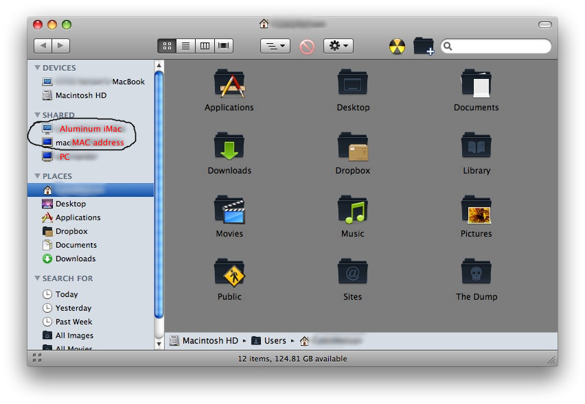

I've been having a problem with my network. I have an iMac hooked up via ethernet to a Netgear router that broadcasts my network. On my MacBook in the Finder, the iMac show up in the sidebar just like it should. However, there's a "PC" just below it that's called mac************. I verified that ************ is the MAC address of my iMac. I was curious to find out if anyone else has experienced this issue. I have a networked printer hooked up to the iMac, but nothing changes when I turn it off. I've attached a picture below. Clicking on either of the two circled items produces the same effect, opening the shared contents on my iMac.

Try downloading MainMenu or OnyX and clearing the caches. It might just be caching the MAC address as the hostname for some reason and can be cleared.

Didn't work. I cleared all the caches on both computers and it's still there. Any other ideas? I'll check the PC in the house to see if it's showing up there.

Nope, no virtualization on either machine. I did have the trial of VMware Fusion on my MacBook but that's long gone. No Boot Camp on either machine anymore.

One more thing you could try: Making another account on the machine affected and seeing if the issue persists in that account. That would narrow it down to whether it was a system-wide glitch or just related to something with your account.
Adding an account to both the MacBook and the iMac made no difference. The MAC address still show up in the sidebar. I'll mess around with the printer. I'm wondering if it could be that.
Edit: I turned off printer and screen sharing in the iMac's prefs, and nothing has changed yet. I'm at my wit's end. Here's to Snow Leopard.

I noticed that you are using the ethernet port to connect ot the network. Is airport also on? I would like to know if the MAC address shown in Finder is for airport or ethernet. I ask because I played with my iMac's network settings and managed to make my iMac appear as a PC server when browsing Finder on my other macs. It appeared only as a PC, not as a mac, but I can't seem to recreate it now.
Is there more that one DNS server on the network? I assume that the netgear is running DNS, maybe there is another that you may not be aware of.
Here's my setup. iMac and another PC plugged in to wireless router via ethernet cables. MacBook connects to said router wirelessly. MacBook shows iMac, MAC address, and PC in Finder sidebar. Clicking on either of the first two shows the shared contents of the iMac. Router set to get DNS automatically from ISP.
New symptom: the MAC address shows even when the iMac is asleep, but not when both the iMac and PC are asleep. I'm almost sure this has something to do with Windows file sharing.
I don't know if there's another DNS server. Is there simple way to check? Sorry I don't know this.
New symptom: the MAC address shows even when the iMac is asleep said:
When my macs sleep they do not appear in Finder, which may lend more credence to a DNS issue. Then again I do not have a PC on my network.
Try this, got to System Preferences > Network and let me know if both AirPort and Ethernet have a 'connected' status. Only one network interface needs to be enabled unless you are running some kind of custom routing or internet sharing.
Also, in Terminal, ping the iMac by name and then ping the 'MAC address' PC by name. Note, in terminal, spaces are represented by '-'. So to ping a device called 'mac mini', the command would be "ping mac-mini". Let me know if the reply is the same IP address. If it is then it is most likely a DNS issue. If it is not, then the iMac has more that one network interface enabled.
If it is the DNS, try rebooting the Netgear router. If the 'MAC address' PC still appears after the reboot, then you will need to check the DNS server settings on the router. I'm sorry, I do not have Netgear and am unfamiliar with their configurations.
I had this problem, I fixed it
I had been searching everywhere to fix this. It drove me crazy to see my mac address in the sidebar.
All you have to do is go the sharing preference pane and at the top there is a computer name.
If it's blank you will see the mac address.
I think this happens when you get on a network with another computer that has the same name as yours.
