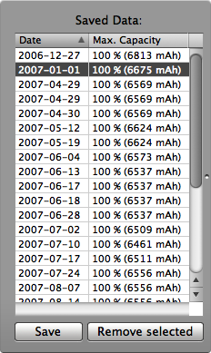

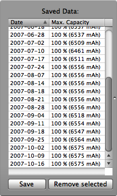

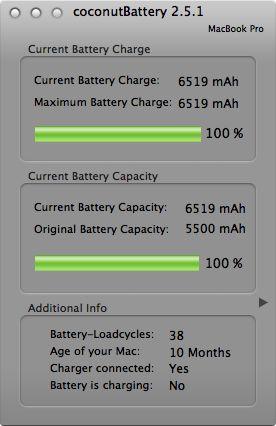

I've been keeping some stats since I bought mine, have a look for yourself, it hasn't gone down significantly, even though it's probably been plugged in with the AC and battery for about >95% of the time since I first bought it.
