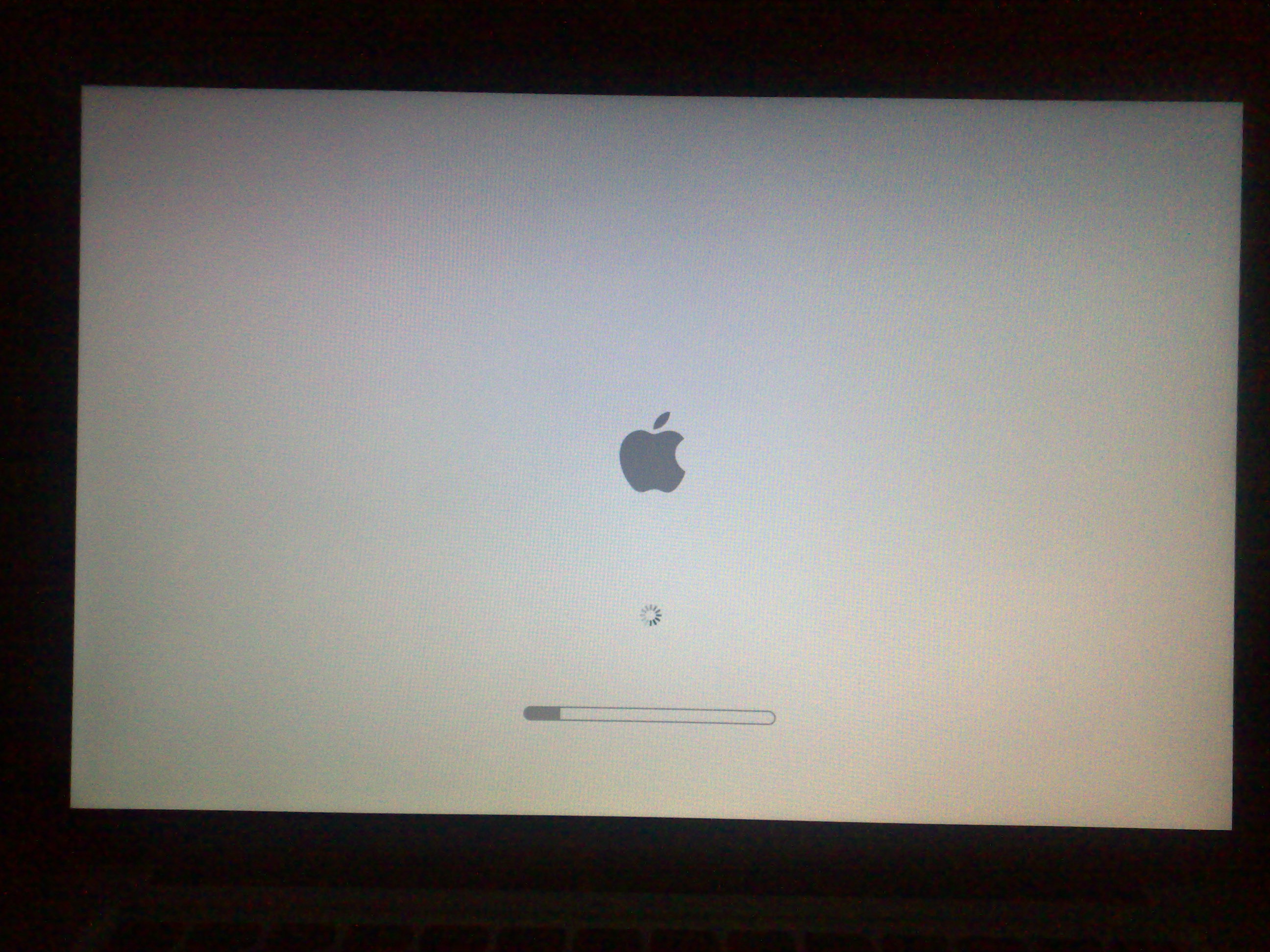

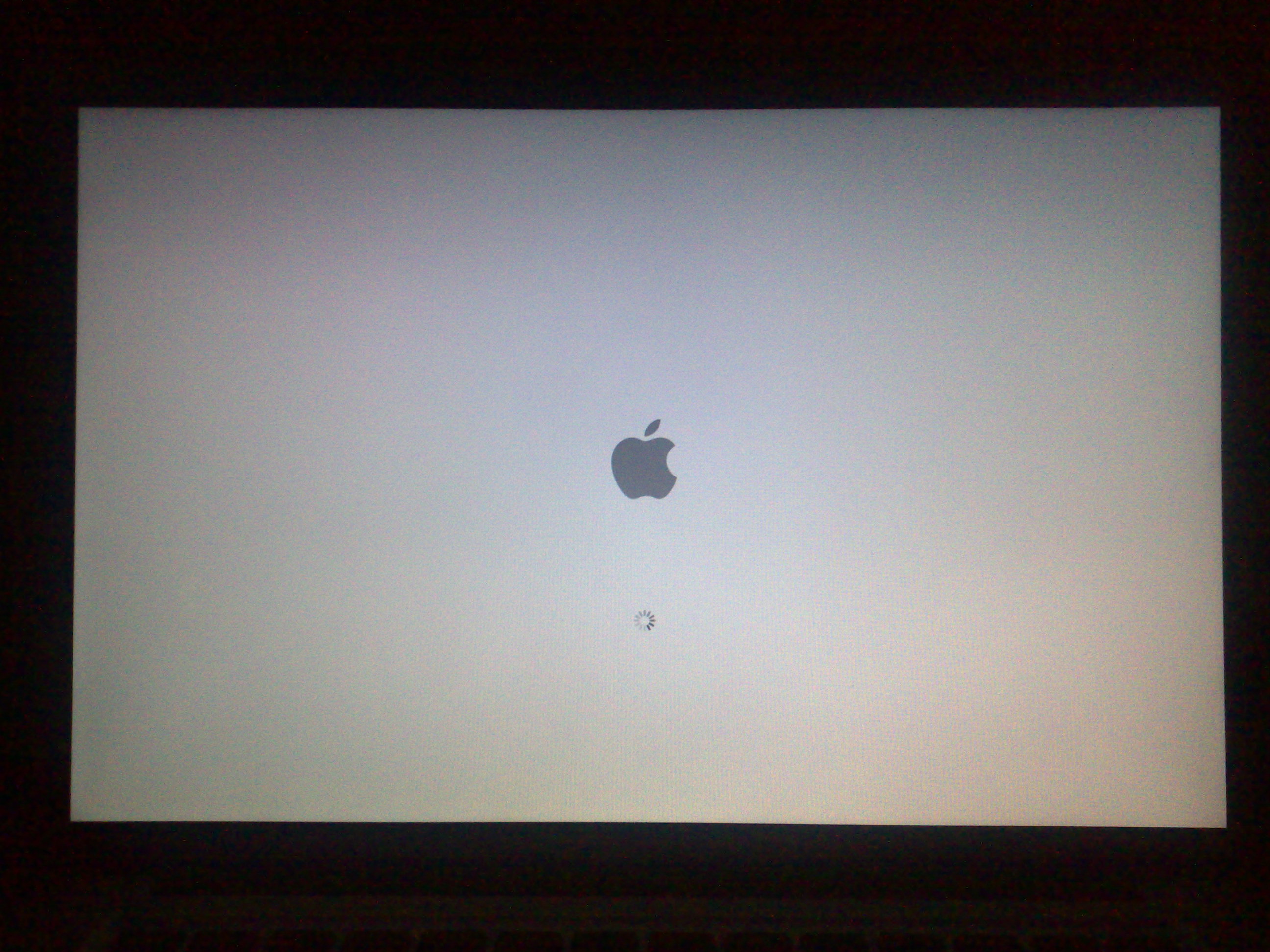

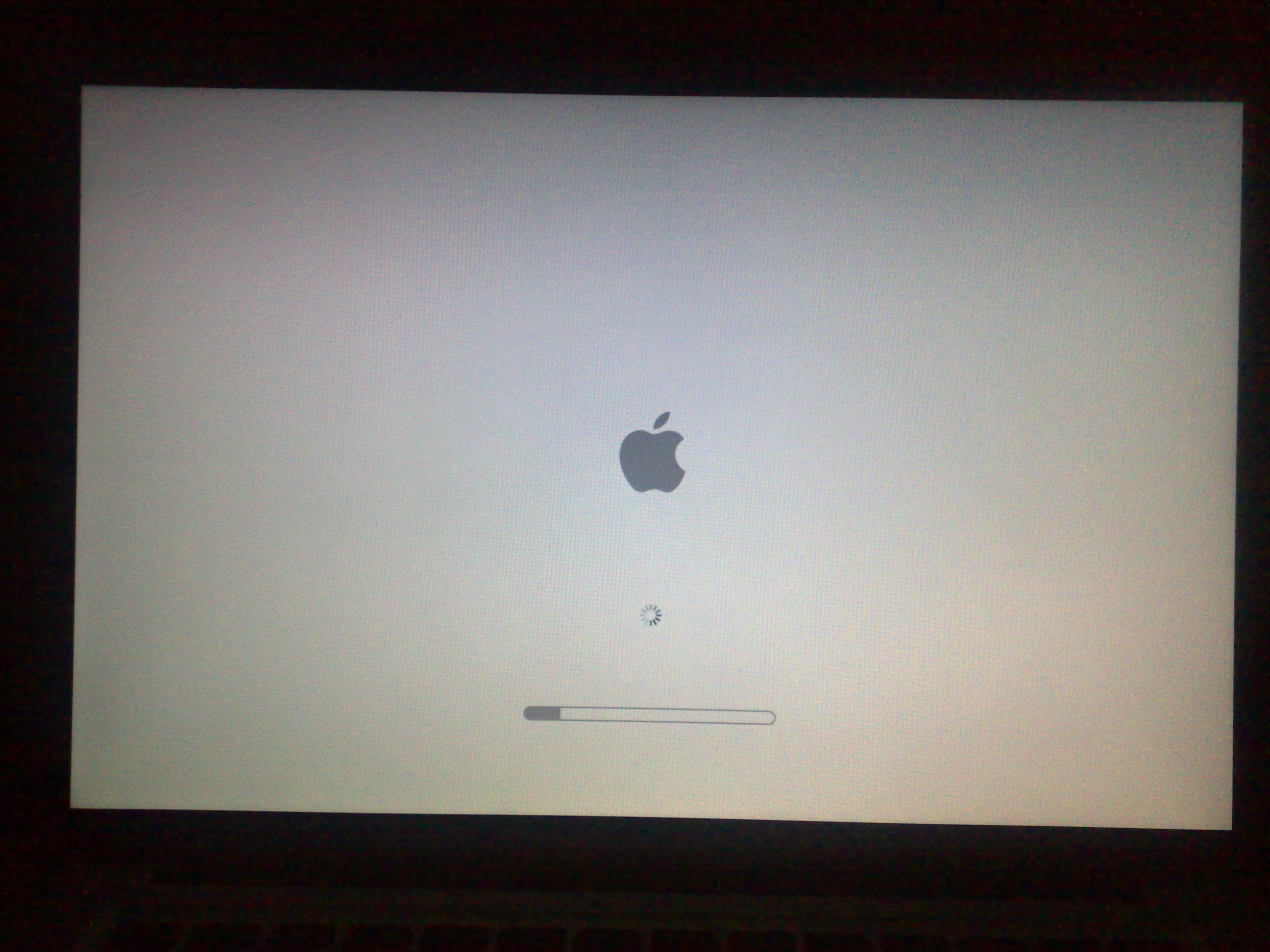

Couple of weeks back i need to reformat and reinstall os and other softwares due to booting issues.It wont boot to mac os, eventually it shuts down aftr showing mac symbol for a while(screenshot attached).

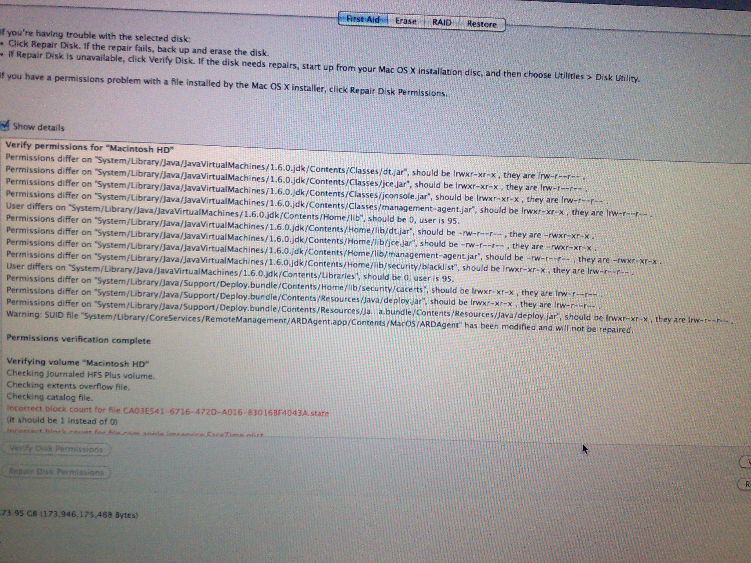

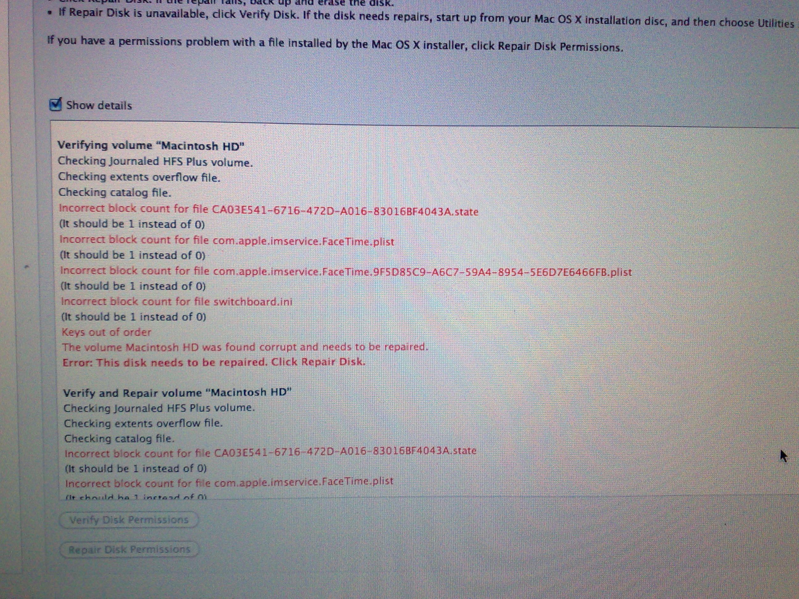

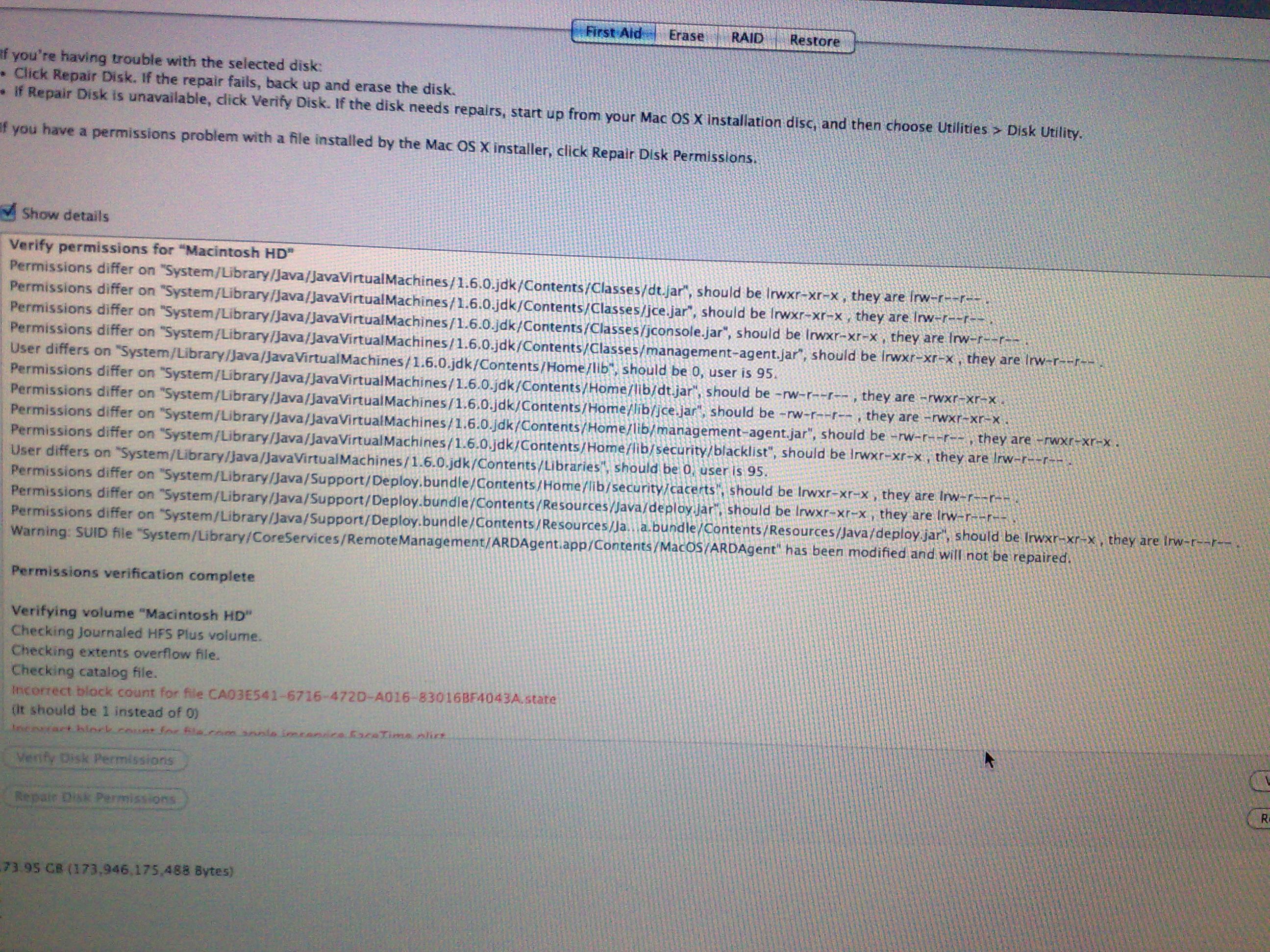

Now the same issue popped up again,with a difference.. it vl boot to the system but i am unable to open or save any of the documents or files in it,but i could open softwares in mac.Mac drive shows out of 175gb, 35 gb is used and rest is free which never be possible.I took th backup of files i have in mac and tht seems to b well over 120 gb.

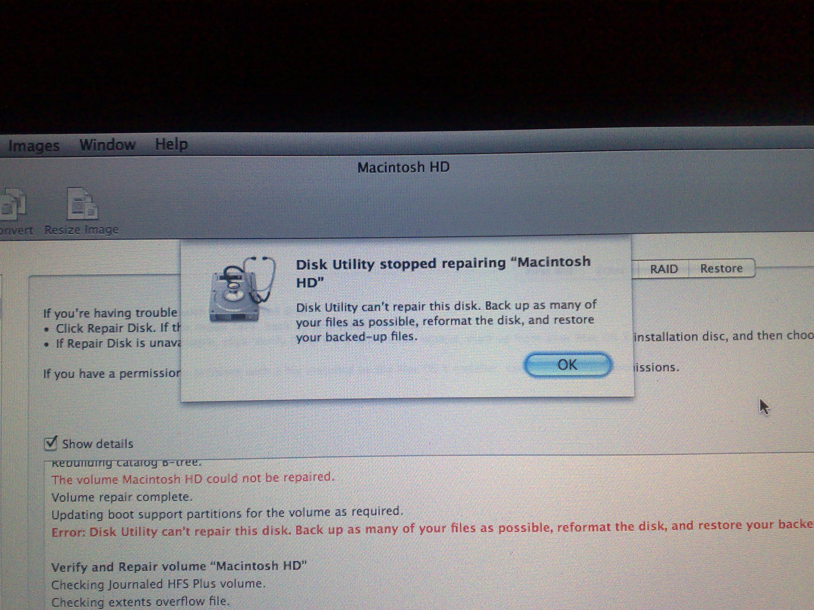

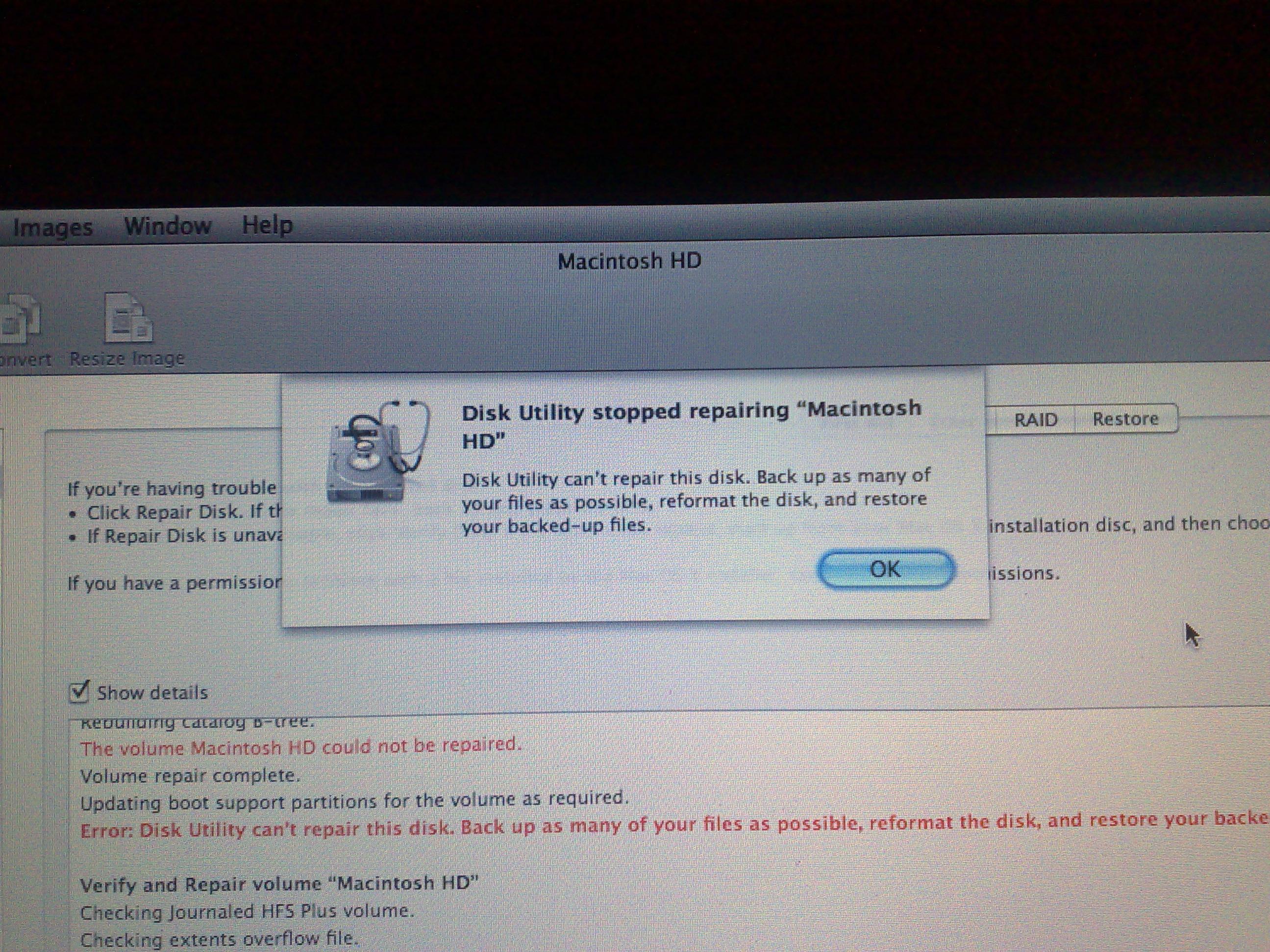

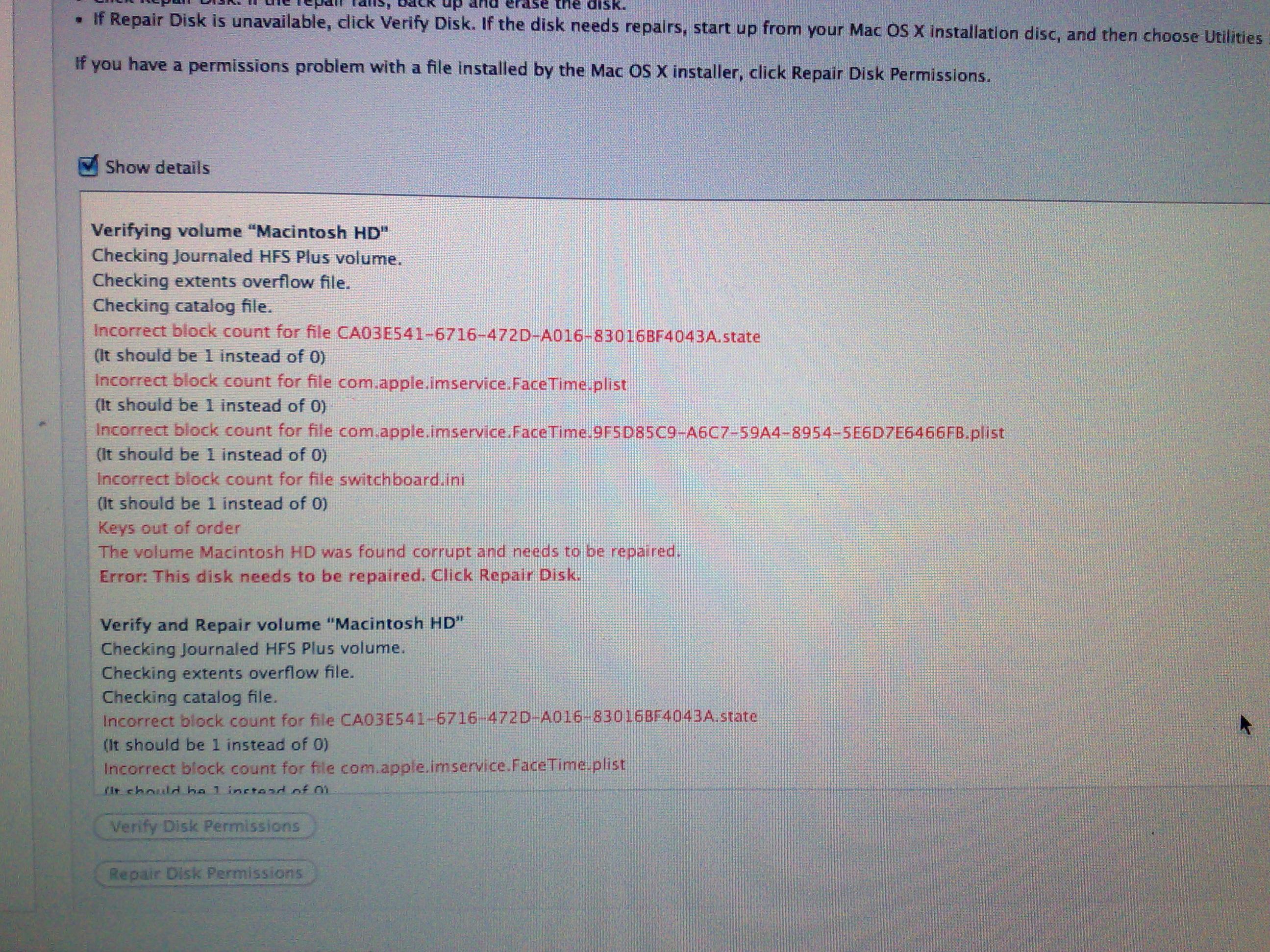

the dvd drive spits out all the original os dvds and other software cds.So i have taken a copy of SL 10.6.3 and try to boot it frm the dvd and used disk utility to repair the issue.Fortunately the drive accepted th dvd and i performed the disk verification and repair functions and it showed few errors.Someone pls explain what does it mean
i have attached the screenshot of issues
pls do the needful

The good news is this: You can indeed wipe just the affected volume and reinstall Snow Leopard onto it, without touching your Boot Camp stuff. The Driver CD is specific to Boot Camp as far as I know.
so can i use SL 10.6.3 retail dvd for formattig the mac drive and reinstall it and no need to bother about any other driver dvds right ?
where can i find the guidelines for formatting and reinstalling the mac os ? i havnt done ths risk b4
In a forum i found "Macbook Pro 15" 2011 Install DVD 10.6.6 | MacOSX | 6.23 GB" is it compatible with my macbook pro 15" 2009 model ?
and i 4got to mention tht i did disk utility repair with SL 10.6.3 where my mac has got the latest update 10.6.6,is tht the root cause of the errors ?
1. Correct.
2. We have a guide for this, here: http://guides.macrumors.com/Clean_Install_of_OS_X_10.6_Snow_Leopard
3. No. That's a machine-specific DVD, which will only work with the Mac it came with.
4. No. Odds are strongly against this being the case. Far more likely is that the filesystem got corrupted somehow before you attempted to repair it.
