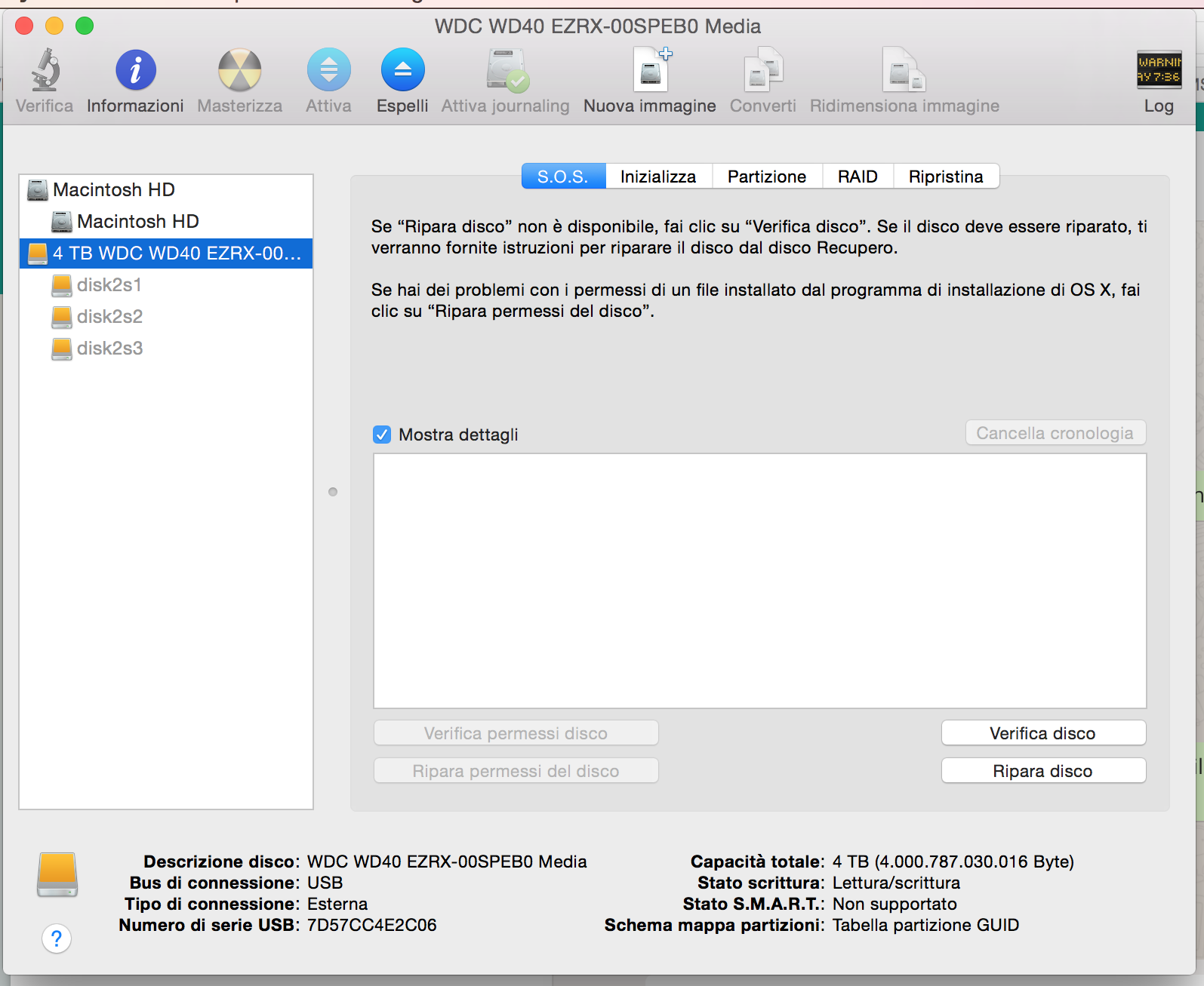

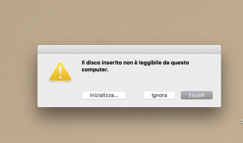

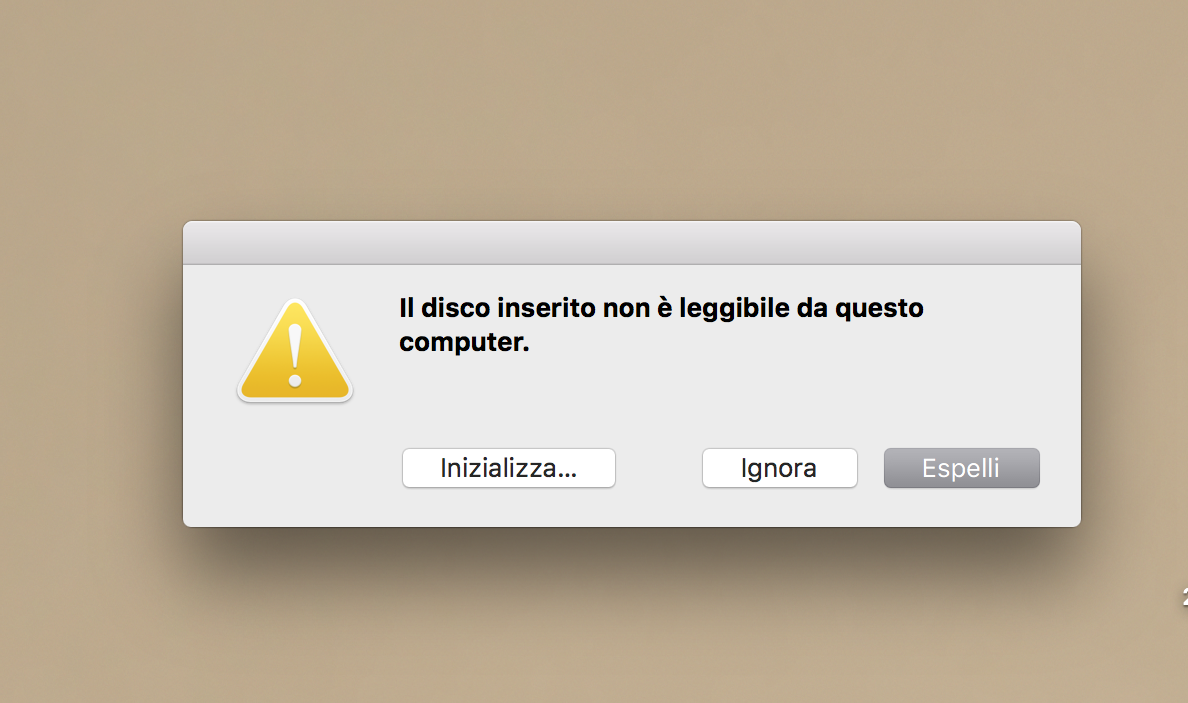

When I switch on the hd I get the error message (see attachment 1, in Italian, but should be understandable):
"The connected disk is not readable by this computer"

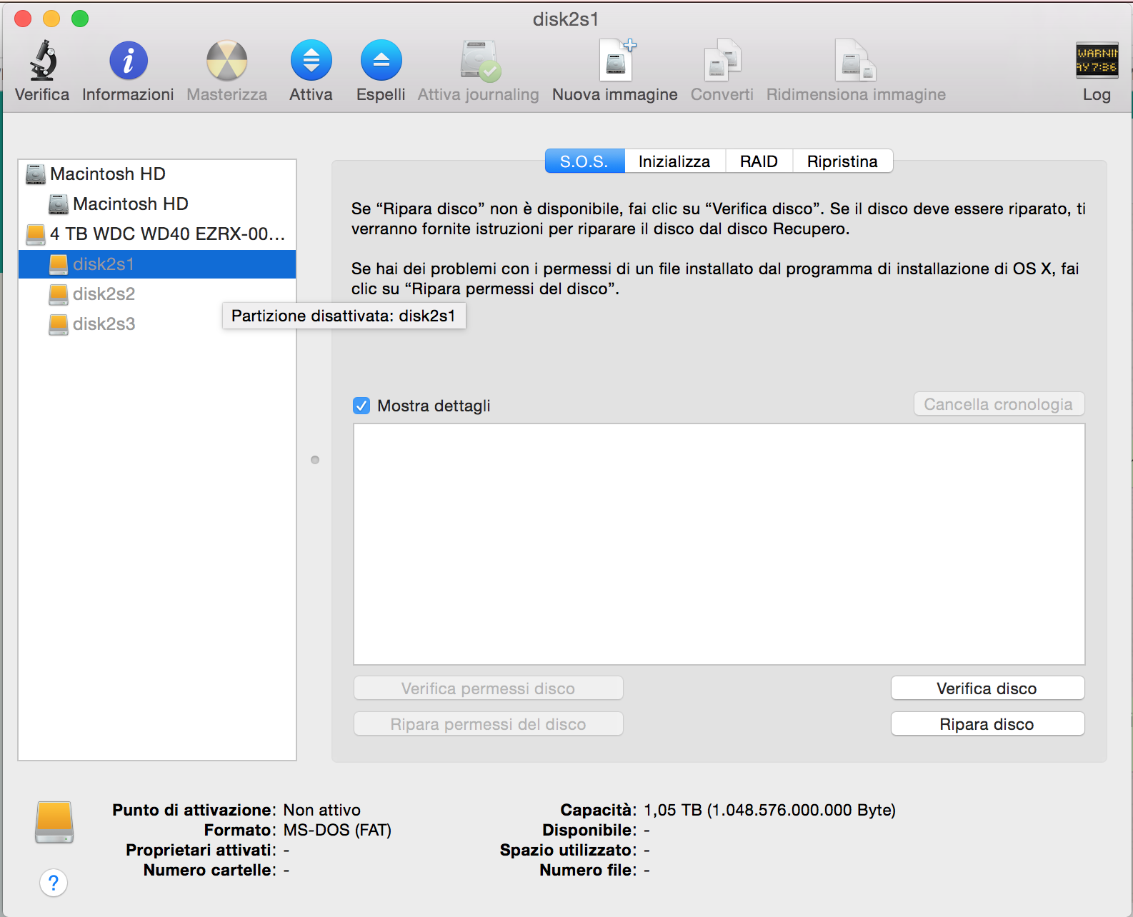

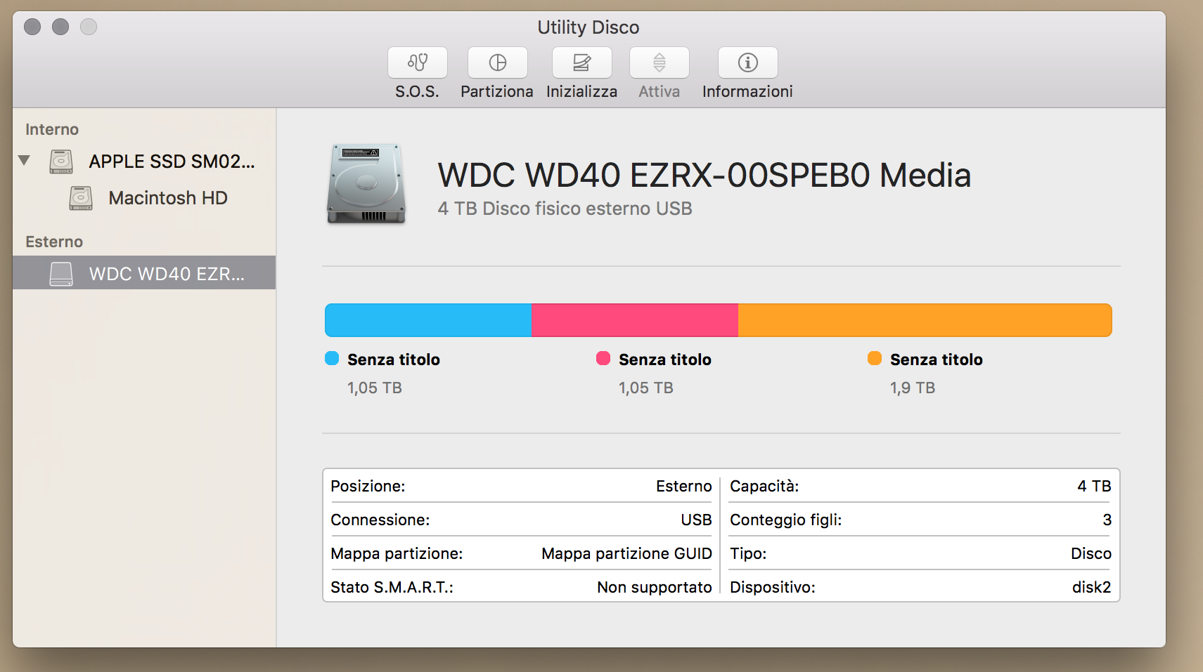

Then I ignore the message and open Disk Utility, you see what I get in attachment 2.
As you can see it is not possible to activate the disk.

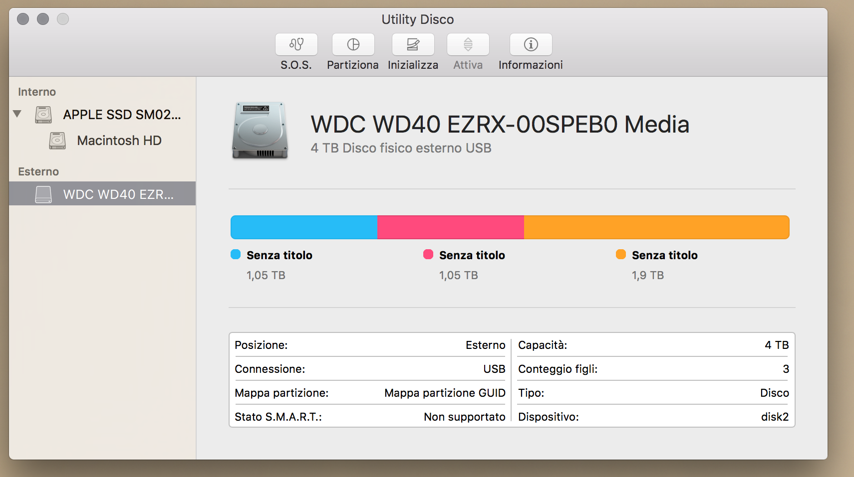

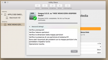

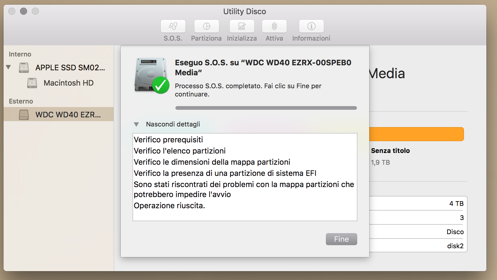

So I tried with the SOS option and this is what the final log says (attachment 3, lines 5-6):
"Some issues with the map of partitions have been identified, which might prevent the (disk) launch"

This WD disk must have originally been formatted to NTFS and not MS DOS (FAT or exFAT). Did you change the format and what did you use to partition the drive? Answer that for us. The message you're getting sounds like the drive is still formatted to NTFS but now in 3 partitions. If that drive is still formatted to NTFS you won't be able to write to it without special software.

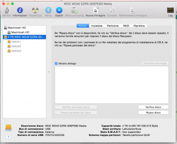

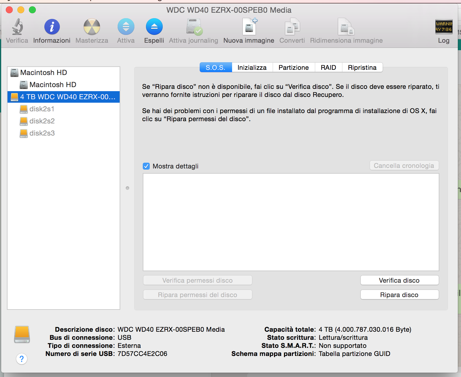

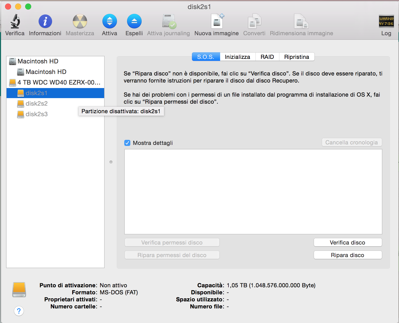

What I know is that, when I tried to mount the hard disk from Yosemite,
right bedore updating to El Capitan, Disk Utility told me the format of all the three paritions was MS-DOS (FAT),
as you can see in the attachments.

I understand that. However, the drive had to be formatted originally as NTFS because the FAT format can not exceed 2 TB. And it appears that it was partitioned and the format changed to MS DOS (FAT) which can create problems. There is something about the structure of the drive that OS X doesn't like.
