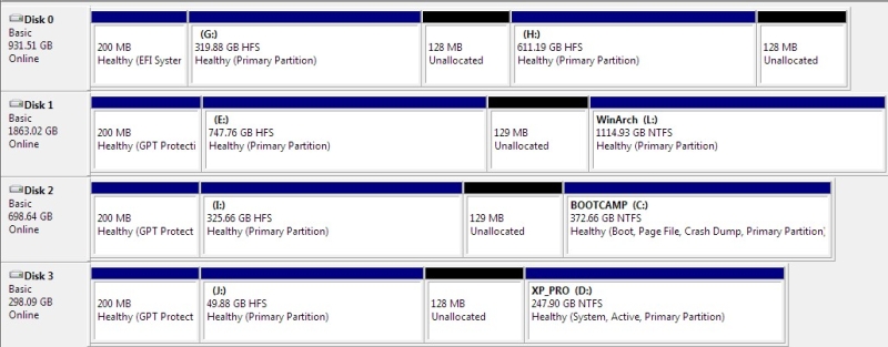

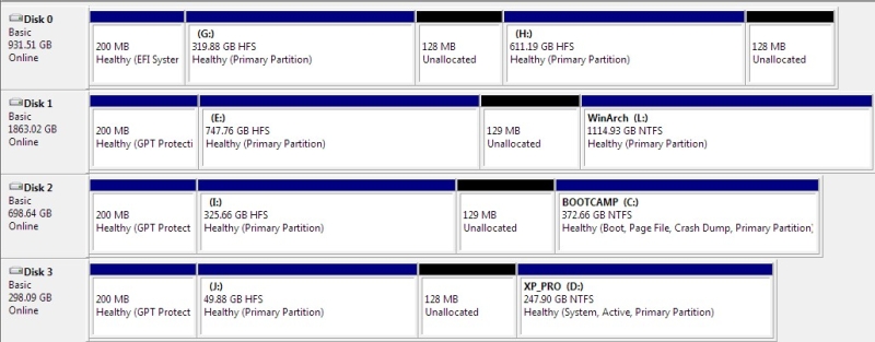

Well, I was mistaken before when I said I had removed the drive with XP before I booted from the Win7 Install disc. In fact the XP drive was there when the install disc repair function found the WIN7 ("Bootcamp") drive. When I removed the drive with XP the Install disc repair tool could no longer see the WIN7 installation. So I reinserted the XP drive and the installation disk repair tool saw the Windows 7 installation. I selected repair, but it found nothing wrong. So it's not going to create an MBR on the Windows 7 installation because it sees it in the XP installation. [See below image from Disk Management tool]
Apparently this isn't an uncommon problem. I Googled "mbr wrong disk" and got quite a few hits. Among them was this one explaining how to use bcdboot from the command line to copy the MBR from its existing location to the drive you want it to be on.
I think I understand how to enter the command to copy the MBR to my WIN7 installation. What I don't understand is where the author says:
"I ran it, and rebooted. I immediately went into the BIOS and changed the Boot Order so that my 300 GIG C: faster drive (the one I thought I was booting off of all the time) was my startup drive."
Do I need to perform this step? I think this probably not necessary for my situation, but please correct me if I'm wrong.

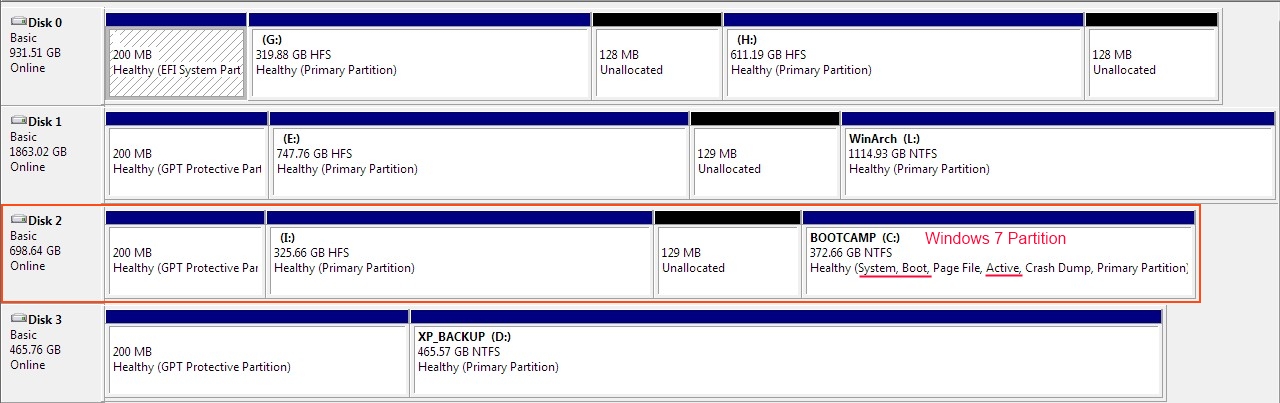

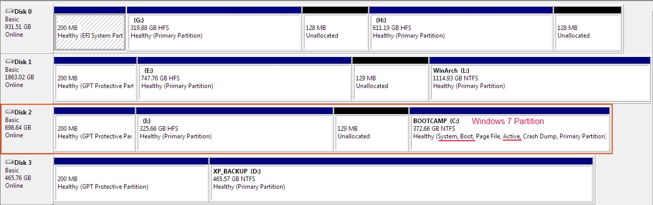

Problem solved
I tried bcdboot but couldn't get it to work. Following another user's suggestion I tried the additional step of using the Windows 7 Disk Management tool to set the partition status to Active. This didn't resolve the issue either. Running bcdboot again after this step had no result.
Someone else suggested I check out EasyBCD, and this worked! On the "BCD Backup/Repair" tab you simply select "Change boot drive," then hit the "Perform Action" button. At the pop-up menu presented you then select the partition you want to boot from. It's really that simple. The procedure creates the required files on your selected Windows installation, and assigns the "System" and "Active" flags to it.
After this I could remove the disk with XP and the "Windows" selection appeared when holding the Option key at boot. The Windows 7 installation also shows up fine when booting from the WIN7 Installation disc.
I had one small problem still with the Windows 7 partition not appearing in the Startup Disk System Preference pane. This was a nut-buster to figure out. On a hunch I disabled NTFS-3G for that volume, and everything now works as expected.
