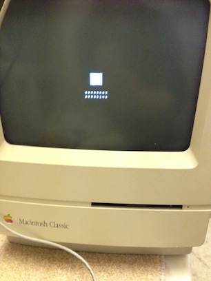

The CRT is lighting up. ;-)
That is -NOT- the problem.
It is absolutely possible to discharge a CRT and not hear anything.
As for "how long it takes?" .. you say it's been plugged in for 10 minutes? ;-)
It happened before your finger let go of the power switch. I'd say you waited long enough. 🙂
This is either a ROM or RAM issue. Since the photo is just ever so slightly blurry that making it out is just not possible .. and that the Classic has RAM onboard, makes changing out all the RAM a little challenging.. you can start by yanking the RAM card.
If it's onboard RAM/ROM, you're kind of sunk.

The error code given is 00000003, which indicates an error in ram bank b.
It came with a ram card with an additional 1mb onboard, so I might look at a transplant, but I'm not sure my soldering skills are up to the challenge.
I'm used to discharging arcade machine crt's, which is why I was expecting a bit more of a bang!

I've pulled the extra 1mb already, but it's the onboard ram that's faulty sadly.
I'm not sure exactly what got it going again, I'd just put the analog board back in, but I think the power connection wasn't right because it started after I gave it a wiggle (technical term).
