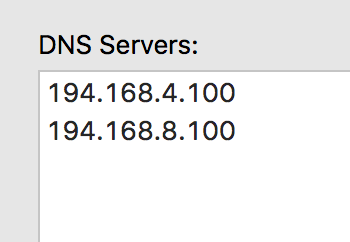

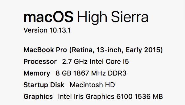

Hi yes that was a bit vague and I do apologise for that. Basically the error says the server cannot be found but it is Google etc popular websites.
With regards to DNS you will have to guide me through that. Screen Shot 2017-11-17 at 18.10.27.png

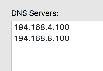

With regards to DNS you will have to guide me through that.View attachment 736490
If you think your DNS server is having problems, temporarily switch to Google's DNS. In the Preferences pane where you took that screen shot, click the "+" toward the bottom left. Type in 8.8.8.8 and click through OK and Apply. Your system will immediately switch to Google's DNS at that address.
To set things back to normal, in that pane click on the 8.8.8.8 and click the "-" to remove it. The system will automatically add back your ISP's default DNS. OK and Apply.

Okay so I have isolated the problem
[doublepost=1511101345][/doublepost]That DNS trick you told me worked 8.8.8.8 loads webpages with no problem.
However when I go back to the other DNS as I showed in the photograph the webpages do not respond and effectively timeout. What should I do?
My girlfriend has a Mac exactly the same model is connected on the same Wi-Fi but doesn't have this problem....
mikesully127, thanks for the additional info. Based on your test, it does appear that those two DNS servers aren't functioning correctly. They appear to be internet servers (i.e. not your router, because router IP addresses usually start with 10.X or 192.X).
Are you saying that your girlfriend's Mac has the same two DNS servers indicated in Network preferences, but doesn't have the problem? If you haven't checked yet, it's possible that her computer might actually have a DNS server manually filled out. If the DNS servers are the same between the two computers, though, there might be some sort of caching problem on your computer. I'm not an expert on this point, so it's only a possibility -- corrupt caches can sometimes cause strange issues. For this type of thing, I recommend downloading the OnyX utility (https://www.titanium-software.fr/en/onyx.html), which provides an easy method to delete various types of caches and manually run other system maintenance routines. You can try going to the Cleaning pane, then the Internet tab, and delete the DNS cache.

Are you saying that your girlfriend's Mac has the same two DNS servers indicated in Network preferences, but doesn't have the problem? Yes
[doublepost=1511106982][/doublepost]Should I have my IP address there instead
No, you shouldn't use the IP address of one of your computers as a DNS server for another computer, since it isn't. Give OnyX a try and see if deleting the DNS cache clears up your latency problem. If not (and perhaps even if it does), try Namebench. Let us know how things turn out.
