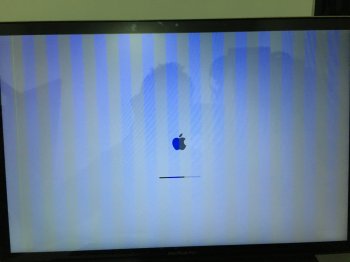

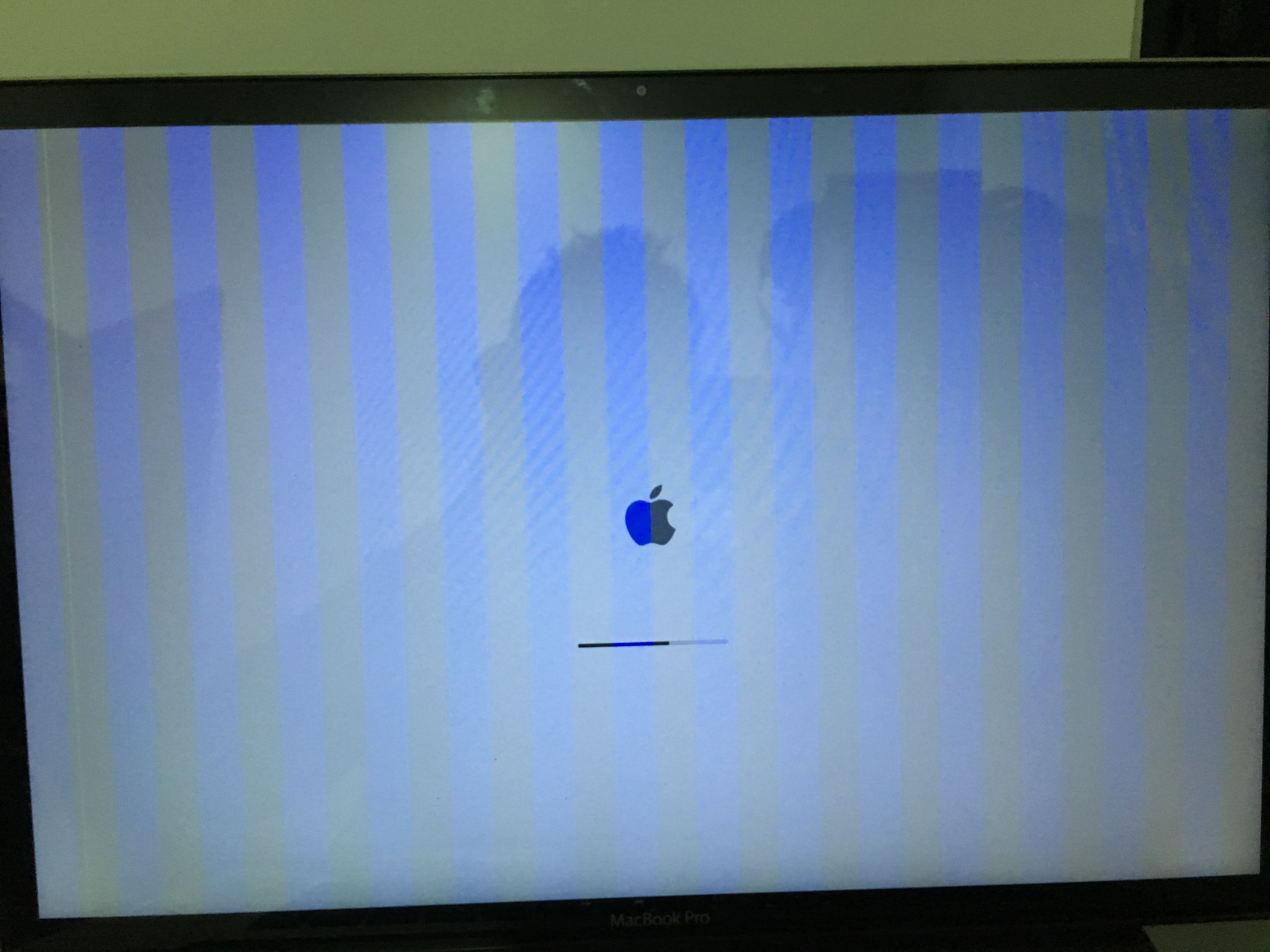

I just installed the Java update from system preferences and as soon as the installation was finished the screen went black and the Mac got stuck in a restart loop. The startup screen looks weird with horizontal purple stripes.
Could this be a malware?

It looks like you are having a video (GPU) hardware problem. You may qualify for and need the MacBook Pro Repair Extension Program for Video Issues.

Thanks for all replies. I took the MBP to the store and they said that it can be repaired for free since it is a known factory fault (graphic card issue). I bought a new iMac 5k and the people at the store helped me to get data from my MBP's HDD by putting it in an enclosure and connecting it to the iMac.
