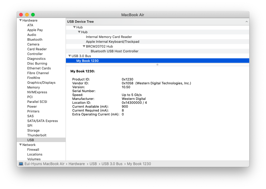

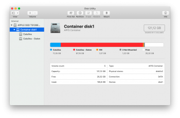

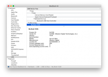

I have the problem that my external hard disk doesn't show up on my laptop neither in Finder nor Disk Utility. It shows up in System Information though. When I plug in the hdd it drives up but goes to sleep right after as far as I can hear.
I tried using a different USB port and cable, resetting SMC and NVRAM and Solution 3 (this comes closest to my issue but I don't have any process similar to fsck_xxx running) but none helped.
My laptop is a MacBook Air mid '12 running 10.15.7 Catalina and the hdd is a WD MyBook 4TB if it's of any concern. I appreciate any help, thanks!

Does the drive work connected to other machines? Assuming it doesn't sounds like the motherboard of the drive is working but the platter itself is either dead or not communicating with the board...
I tried to connect it to a Windows laptop but it's about the same. The disk starts spinning when plugged in but soon goes to standby or stops spinning. Does that mean that my hard drive is done and gone? That would be a shame since I need the data from there.
