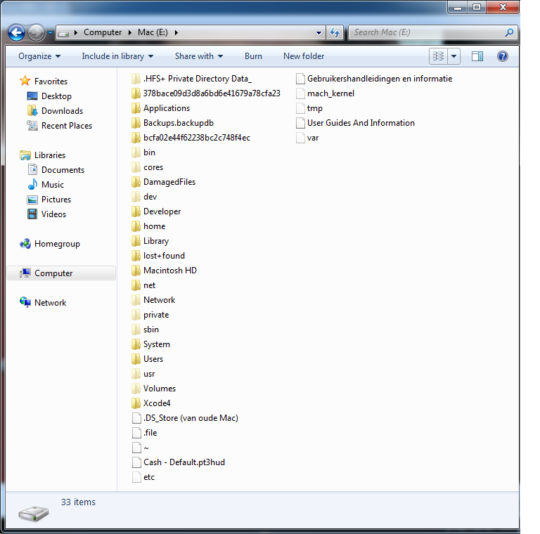

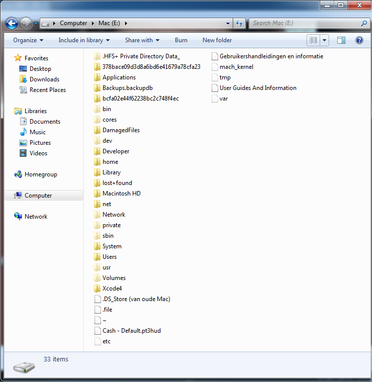

I've got a big problem, a week ago, I installed windows through bootcamp, everything worked fine, until today. I tried starting up in mac, but in the bootloader, starting up in windows was the only option showing up...
Yesterday however, I was still able to start up in windows... The only thing that changed was me installing macdrive on my windows partition...
And I can still access my mac partition in windows (with macdrive)
Just the root from the mac volume?
I attached it...

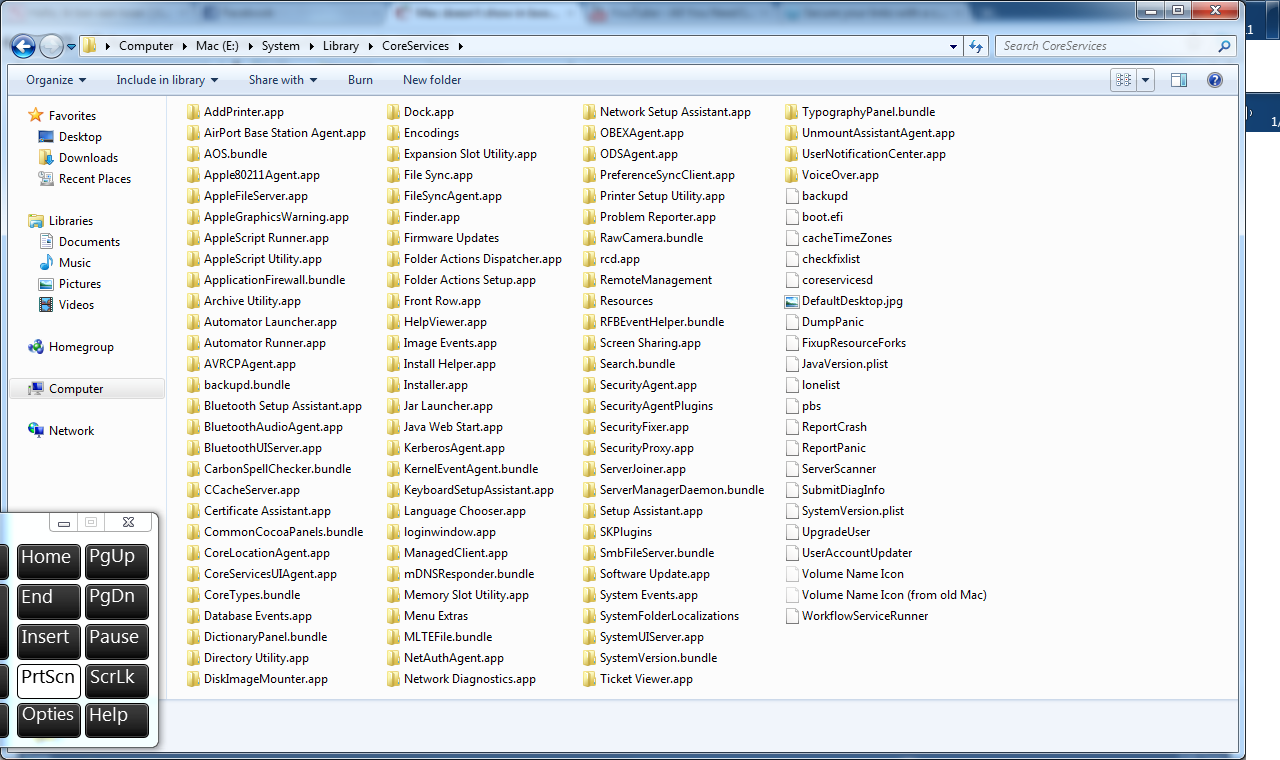

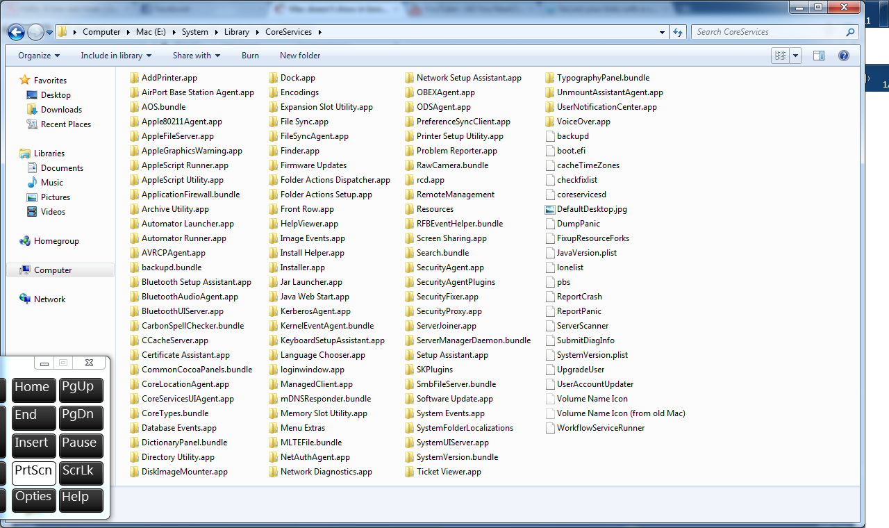

Yep. looks like it's fine. Now can you browse to system / library / Coreservices?
edit: those hex named folders look like they came from windows updates can you check them out?
Them those hex named folders are temporary folders used by some installer. Looks like your boot.efi file is still there. Looks like it needs to be blessed (bless command).
edit:
Looks like you need to use your mac os x install disk to run this command
sudo bless --folder "/Volumes/Mac SSD/System/Library/CoreServices" --bootefi "/Volumes/Mac SSD/usr/standalone/i386/boot.efi"
Replace Mac SSD with your boot volume name.
Your welcome😀 but looks like it's better to use this command instead:
sudo bless --folder "/Volumes/Mac SSD/System/Library/CoreServices" --bootefi "/Volumes/Mac SSD/System/Library/CoreServices/boot.efi"
edit:tried and it works on my macbook😛
