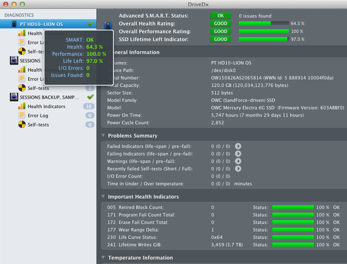

Run a demo of DriveDX and see if it has errors. CRC errors could be a bad mounting adapter.
Had such. How is the drive attached?

Downloading DriveDX and see if that will yield something and perhaps correct the occasional no boot as I described in the first boot.

UPDATE FOLKS
Ran the DriveDX app and everything seems fine.
I meant the drive report says the drive is fine but still baffled the driver has the question mark. Thank you if anyone can shed some light on that anomaly.
