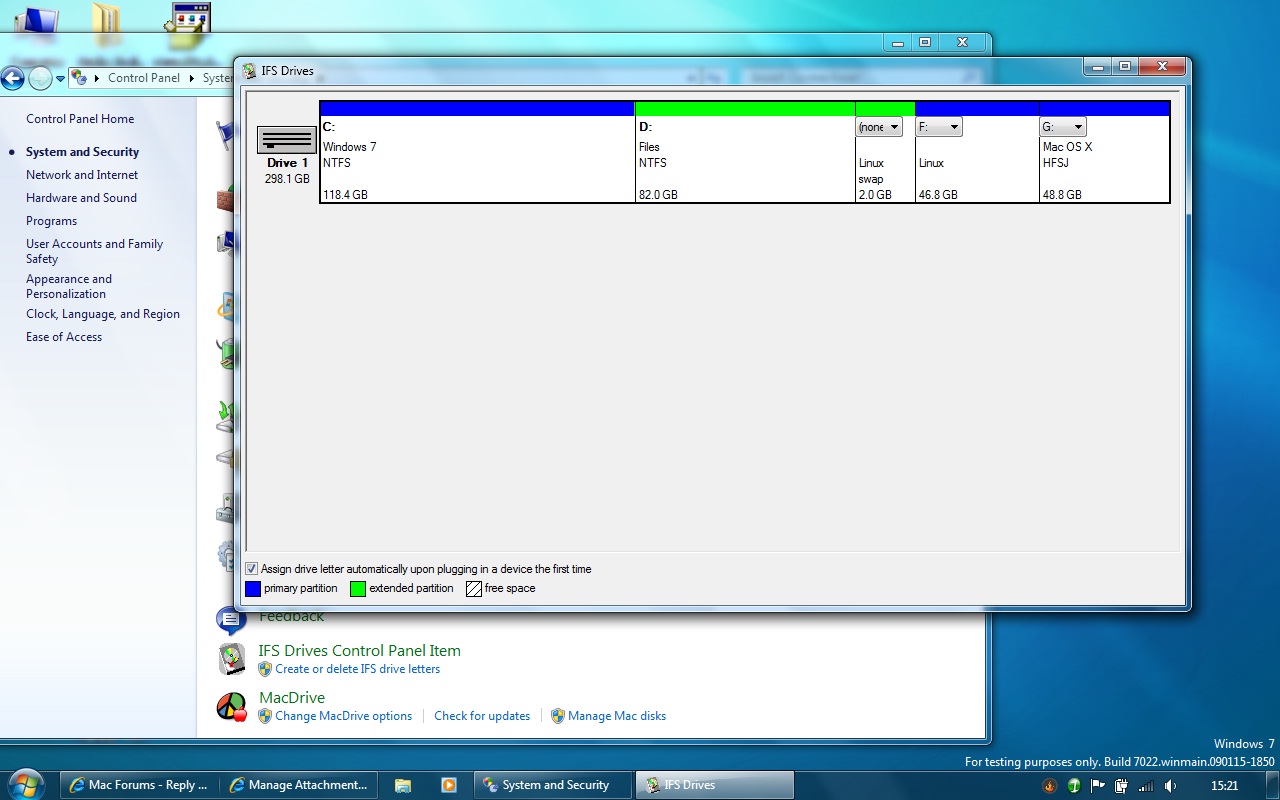

Just had some success with Macdrive 7.2.5.
Installed using the MSI edit mentioned above, but when I rebooted, my drive was still not visible.
However, when I installed Ext2IFS 1.11a (in order to view my Linux partition), and rebooted, I was able to use the IFS control panel utility to assign a drive letter to both Mac and Linux partitions.
The only bug seems to be that I have to run the control panel utility after each reboot to reassign letters.
Update to 7.2.6 resulted in failure to load Macdrive on boot however.
Regards,
Pete

Thanks your for tip my macdrive now works flawless.
I read through the website of Ext2IFS and it mentioned about a command line access. So i created a batch file and stuck in it my startup folder. Now I don't have to assign a letter at every start up🙂. Here are the steps:
1) Assign a Drive Letter using EXT2IFS
2) Run cmd.exe and type "mountvol X:\ /L" (without the quotation marks; and replace X: with the current letter the drive is assigned to)
3) Now mountvol will report the persistent volume name (example):
\\?\Volume{241c8cc6-c4e4-11db-8168-c5932447ec37}
4) Copy that
5) Open Notepad
6) Type: "mountvol X:\ \\?\Volume{241c8cc6-c4e4-11db-8168-c5932447ec37}" (again without the quotation marks; replace X: with whatever letter you want to assign it too; replace the last part with what you got from cmd)
7) Save it as a .bat file (you can name it whatever as long as it ends with .bat)
8) stick it in your startup folder
Thats what I did ..
Thanks again 🙂
