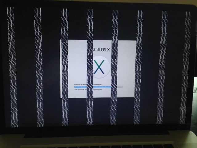

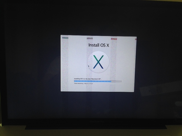

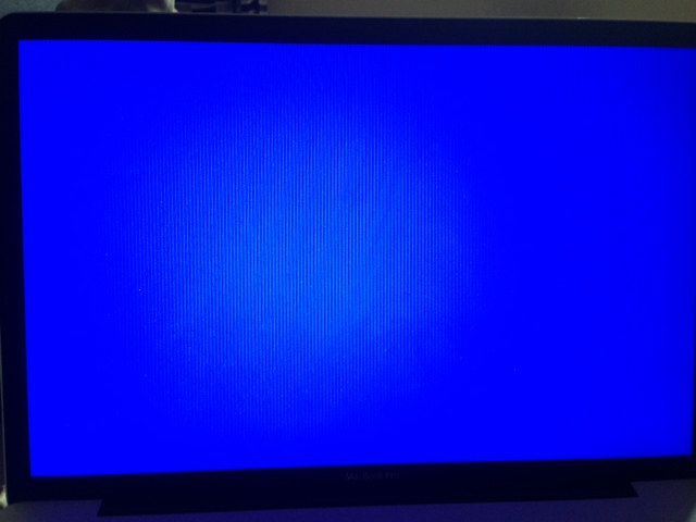

I have a macbook pro 17 inches with 8 Go RAM, bought a bit less than 2 years ago, and since yesterday, my mac freezes randomly, and weird stripes of different colours appear. Here are some examples :
it happens randomly (after 10 min, or sometimes after 2 hours), the stripes also appear sometimes when i restart.
it's not a problem of hard disk, cuz i still can restart, it seems to work better in safe mode, and i even installed mavericks, but the crash still happens.
I tried to reset NVRAM/ PRAM, nothing.
i tried to purge the memory, nothing.
is it a hardware problem ? RAM, video card ? = SAV
Shall i open my macbook (warranty off) ?
Let me know, thanks !

I put it in repair, it was from the graphic card, so they replaced it. It cost me 280$ (around 220 usd) in a cheap repair centre.
Hope it wont happen again..

If it's the early/late-2011 15" or 17" MBPs, good luck.
It turns out that these MBPs have their Radeon GPUs failing left and right everywhere.
Apple somehow still point-blank refuses to issue a replacement/repair for free for machines out of warranty, even though this problem is appearing everywhere.
You can do a Google search for them.
I'm also pretty worried over my 15" 2011 MBP now, knowing that it's a ticking time bomb. I just hope it doesn't break until Apple officially declares a repair extension program for it, because if it did, I've to shell out US$300 for a logic board replacement.
As of now, I'm forcing my MBP into Intel only via GFXcardstatus and use the Radeon less often.

In the United States and Japan (and maybe Canada?), you can get a flat rate repair for $310 that will cover any hardware failure not caused by accidental damage. The flat rate is a tier based pricing system. $310 is tier one your machine must be in near perfect physical condition to qualify.
As noted, for this particular problem, it might not be the best option. Apple's approach, thus far, has been to replace the entire logic board and these replacement boards often fail quickly. They're often not even new boards. You do get a 90 day warranty with this type of repair, though.
Other options would be a reball or new GPU installed by a professional shop that does board level work. That's probably the repair referred to upthread. Yes, you can have new GPU installed for under $300, just not by Apple.
I would advise against home-brew remedies of the oven baking nature. I think that would make sense for a 7 year old X-Box that you just want a few more weeks out of because you know you're getting the new one for X-Mas. But the value of these quad core 2011 MBPs easily justifies the price of a legitimate repair.
