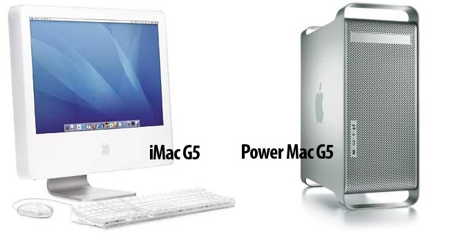

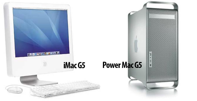

Just one question- are we talking about an iMac G5 or a Power Mac G5? If it is an iMac as I assume, then I really think it would be a better idea to take it in to see what they could do with them, as it would be better for them to be responsible for the tiny metal chips that will result from normal methods of screw extraction if no other methods will work.
OK I lied- one more question comes to mind- when you say stripped, do you actually mean that they turn in the hole without tightening or loosening (the usual definition of stripped) or do you mean that the heads are screwed up from trying to remove them with the wrong tool? If the heads are screwed up there is an alternate (non-drilling) way to try to get them out that involves epoxying a small machine screw to the head to aid getting it out, but I really can't recommend that here unless you have had experience elsewhere since you can wind up making it worse! 🙁
It's just a plain ol' run of the mill Mac G5 : )
<clip>
Ok well the reason I asked to make sure is that there is no "run of the mill Mac G5"- but in re-reading your problem description it is now clear that it is an iMac G5 (see below). 😉
Apparently not many people have damaged their screws enough to require replacement (fortunately for them, no so fortunately for you)- but I can see where the careful use of a small extractor could take care of business pretty easily having taken more of that model apart than I care to think about!😉 I originally thought you were talking about the screws that secure the drive in place internally so that is why I advised letting Apple do it.
Yeah, it's totally the iMac G5 (sorry for any confusion I may have caused). And yeah, it's one of the screws at the bottom that holds the backside of the iMac in place.
