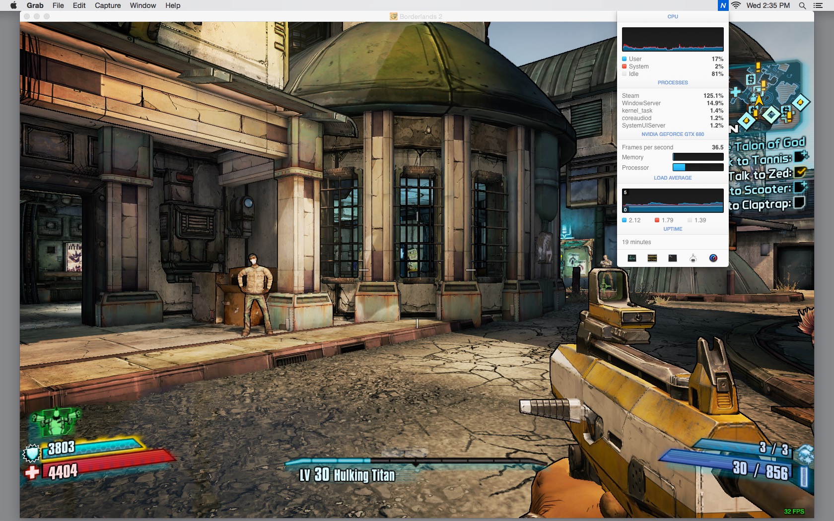

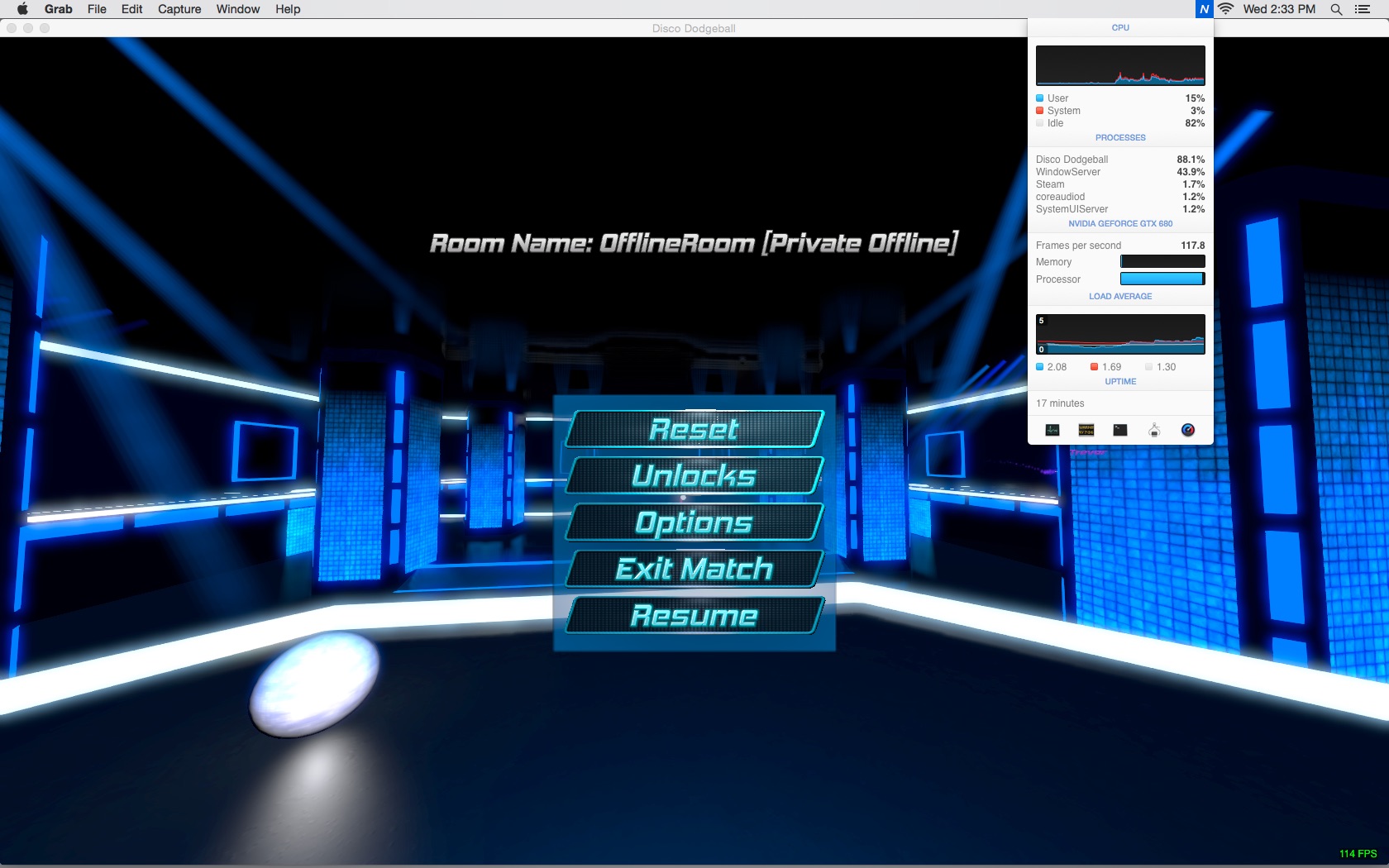

As you can see, it's not a matter of the GPU or game being incompatible or unoptimized necessarily, it's that every other game besides Robo Dodgeball just doesn't use more than ~30% GPU usage.

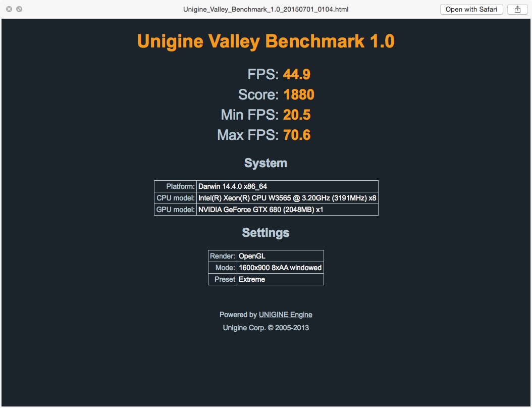

Note that the Valley benchmark matches Barefeats nearly PERFECTLY using the same settings that they did -

Turns out only the Robo Dodgeball games works properly - Guns of Icarus, which also runs on Unity, does not. Worse than 5770.
As you can see from the screen caps that I posted above, the GPU just isn't being pushed passed ~30%

Note the FPS in the bottom right in both screen caps.

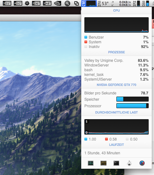

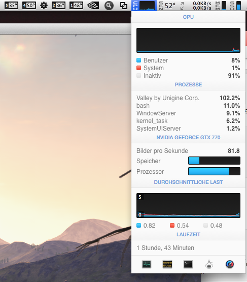

I don't have any of your games. But can you start Unigine Valley (Preset Extreme) for comparison?

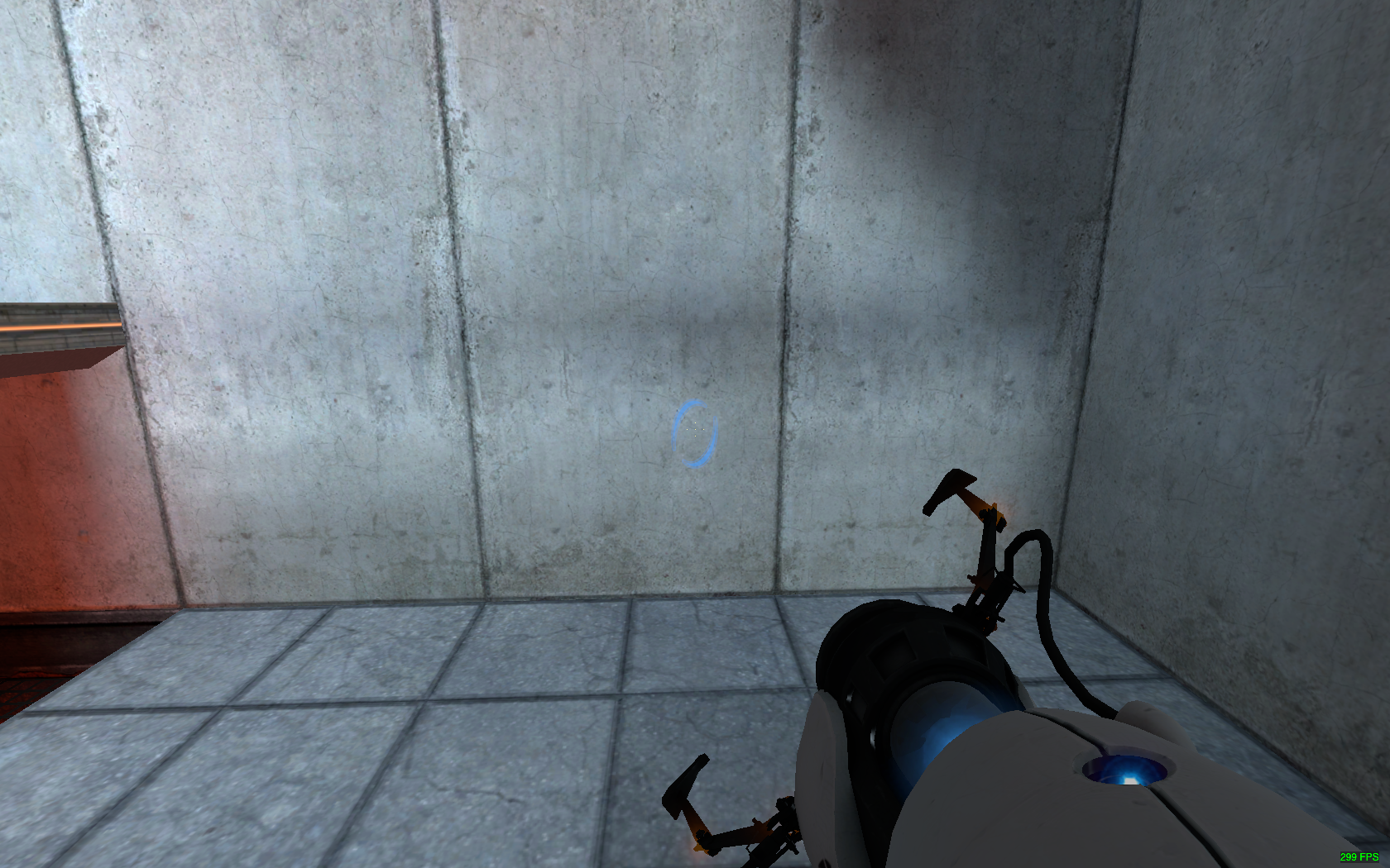

UPDATE - So apparently not ALL of the Source Engine games are performing poorly; I just ran Portal 1 *MAXED* out and it never dipped below 295 FPS -
Note yes I'm staring at a wall, but this FPS was indicative a large room with tons of reflections and real time lighting. Particle effects happening and all and it screams on this 680 -

Also check out my Portal 1 performance - 100% inline with a 680 - never dipped below 295 on max settings even when NOT staring at wall lol.
See bellow my GTX 770 (which has the same GK 104 chip as GTX 680)View attachment 565578View attachment 565579
I could, but I already ran it at the same settings Barefeats did to test their 680, and I got nearly identical results. It was super impressive, and my 680 appears to function normally there.

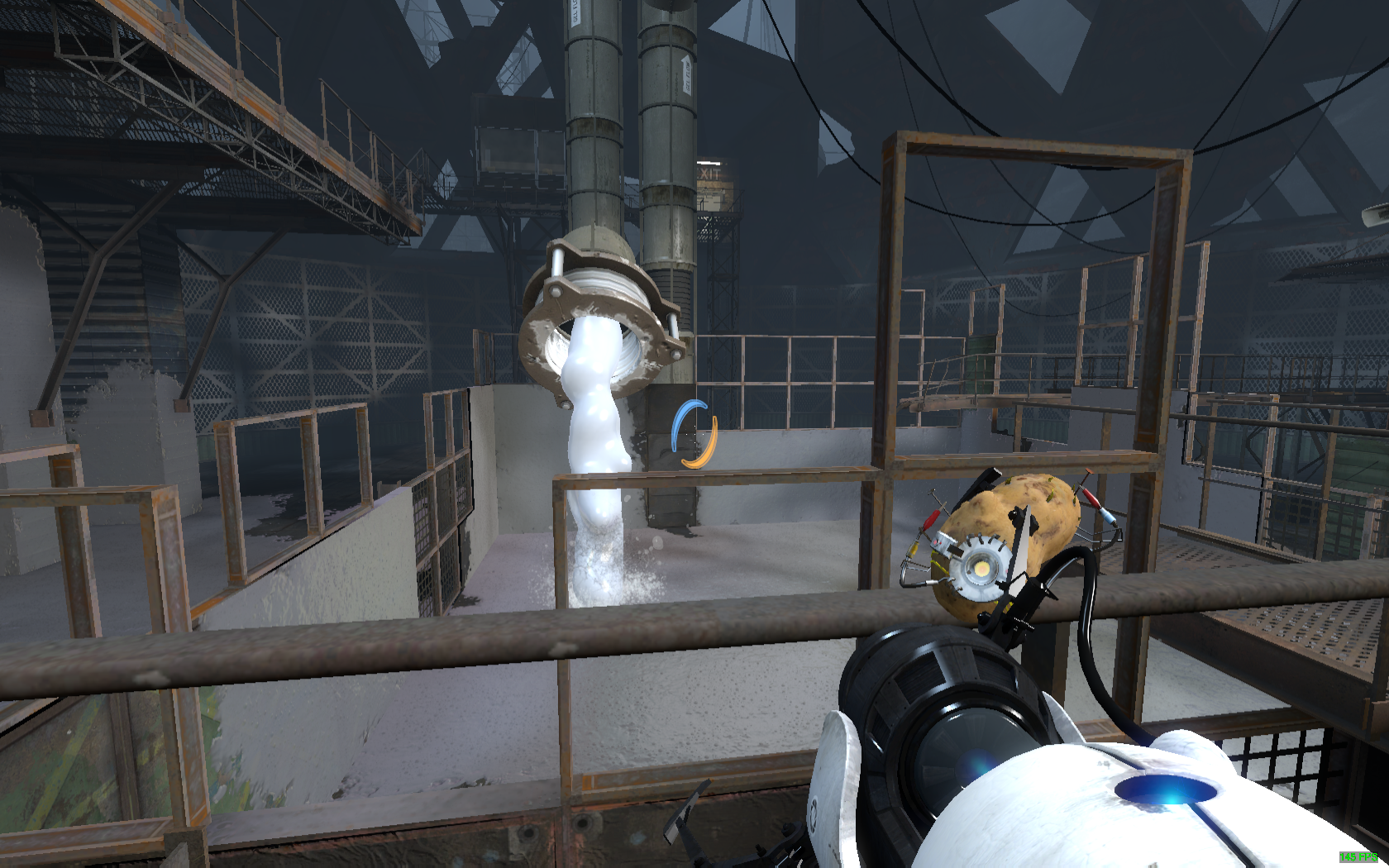

WOOOO! Another game running at FULL PROPER SPEED!
Portal 2 runs beautifully - all settings maxed (with AA turned off, hate AA), but everything else 100% cranked

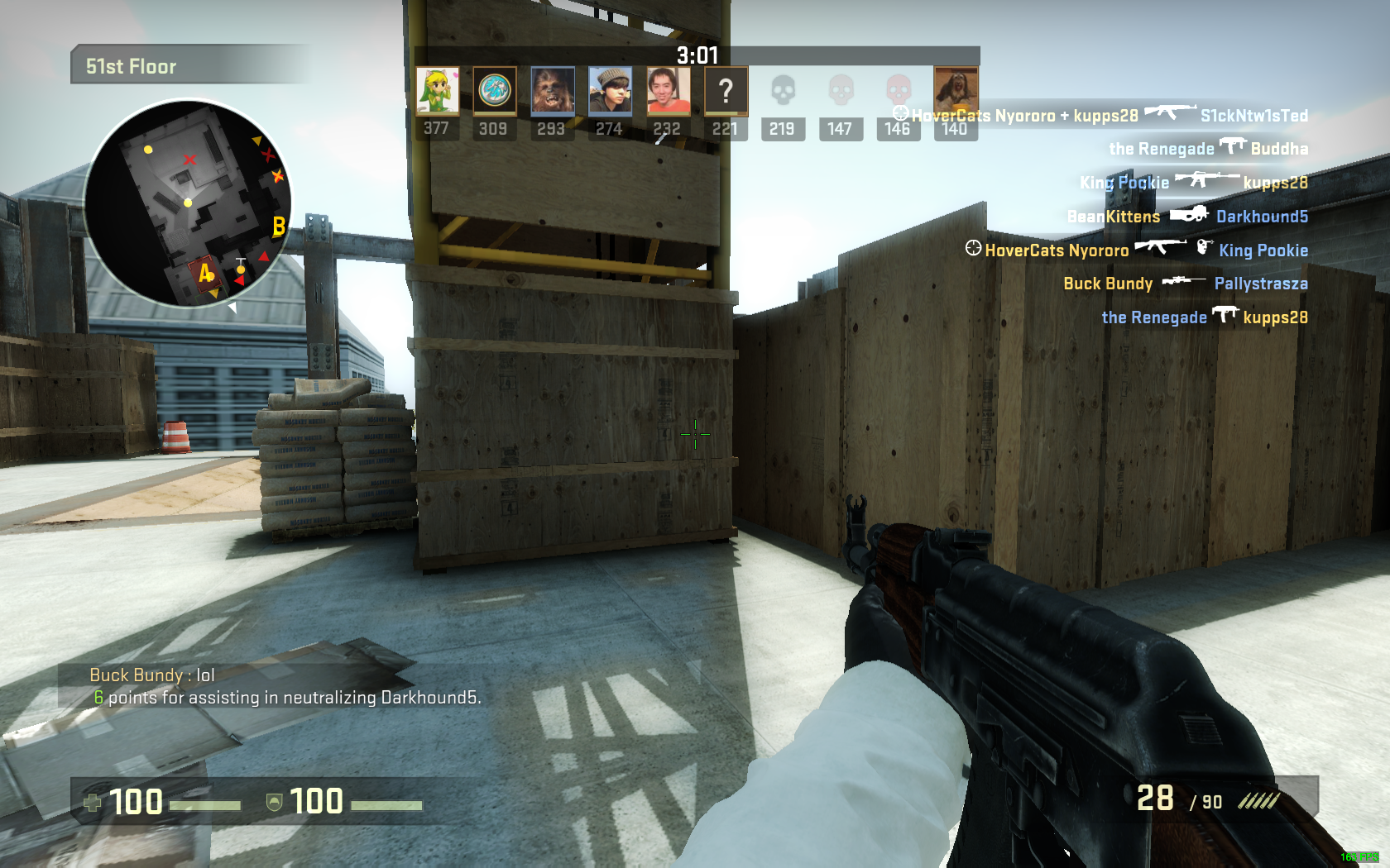

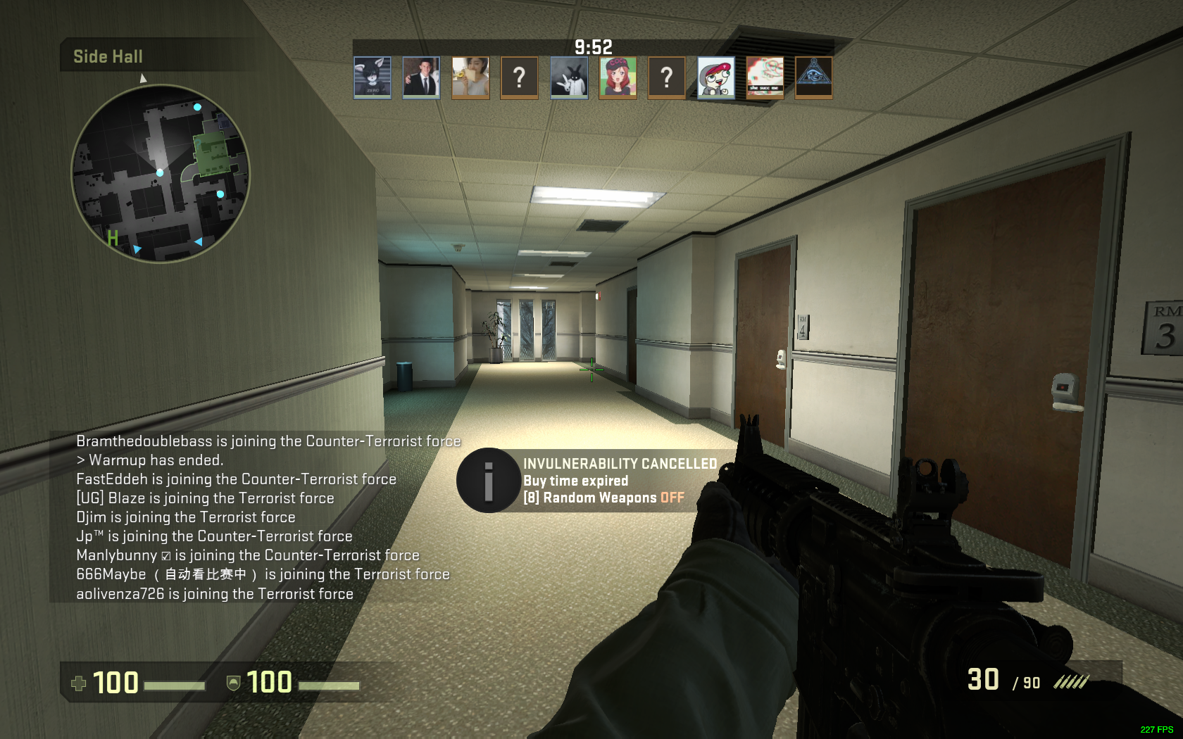

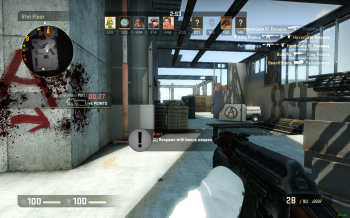

Another update -
Turns out CS GO runs WAY better on the 680 now that I've figured out why I was having issues with it - I'm getting I think at least twice the performance of the 5770 - EXCEPT on the Operation Bloodhound maps - and it's super odd as the FPS dips IN DOORS, but outside? It's higher.
I haven't tried Season which is one of my favorite maps.
The GPU still isn't being pushed or stressed under CS GO - the fan doesn't ramp up or anything, but hey, it runs great on all the good maps that matter.
So now it's just a matter of figuring out the mystery of the Aspyr Media and Feral's ports.
Attached screen caps of great CS GO frame rates

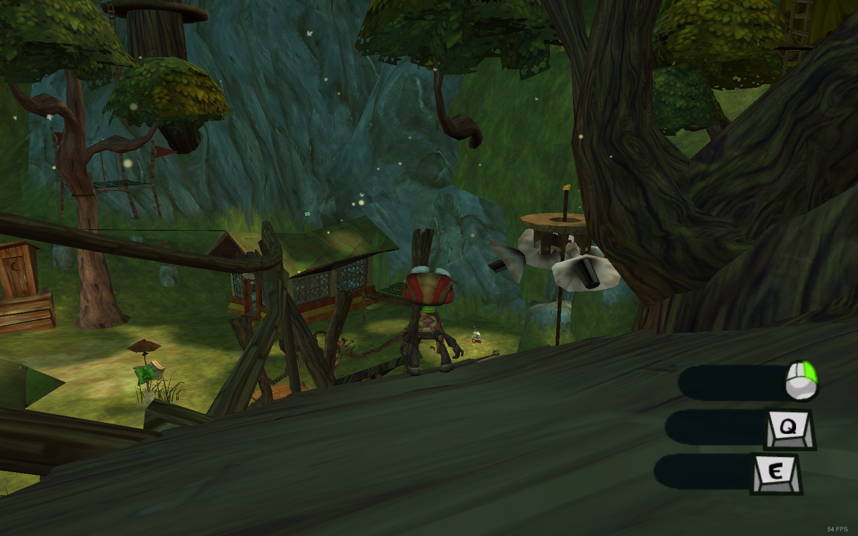

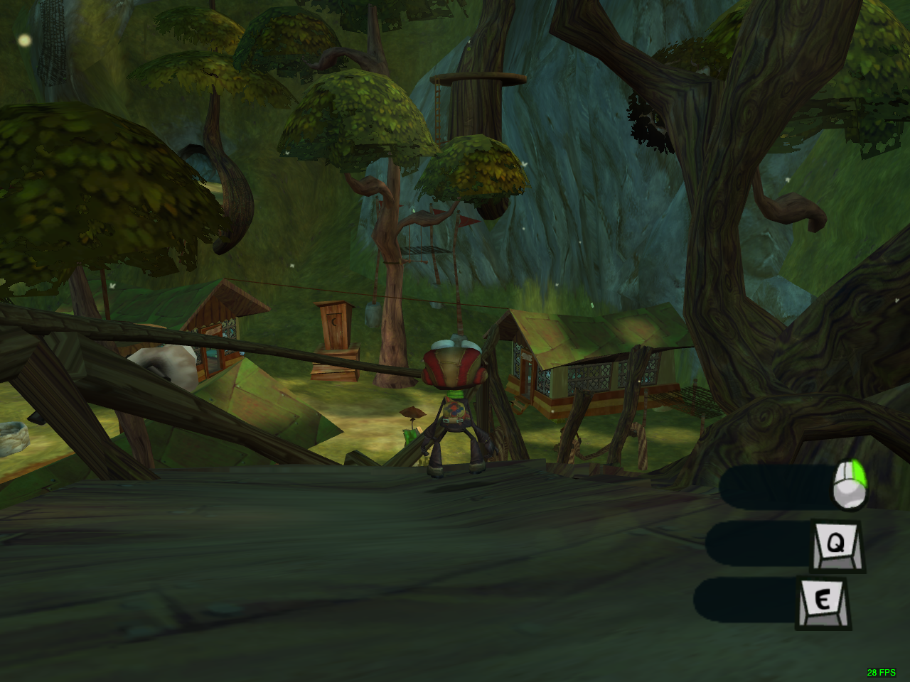

Psychonauts - a game that run wonderfully on the 5770 - is having the same performance issues as BL2 etc.

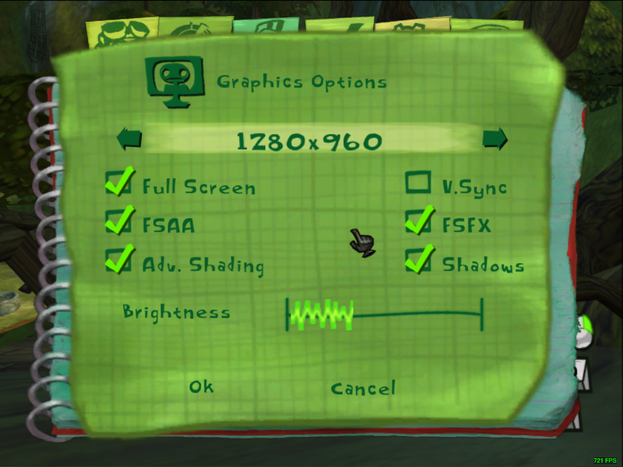

What's odd though is that during the menu the FPS goes to 700+
Well, if anyone's still curious, the 680's going back. Here's a screenshot showing twice the FPS in Psychonauts on the 5770
