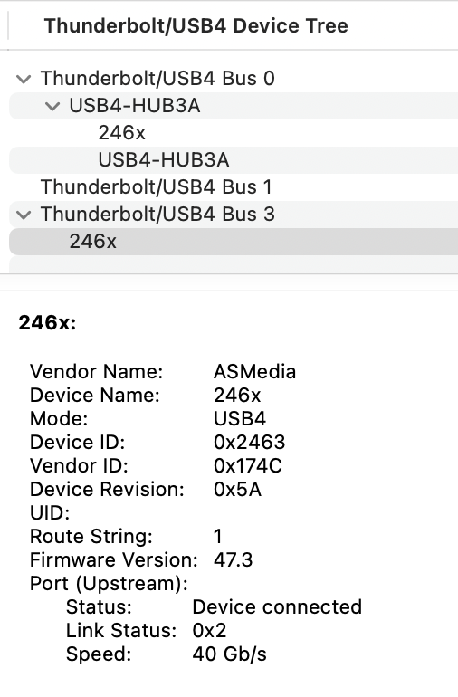

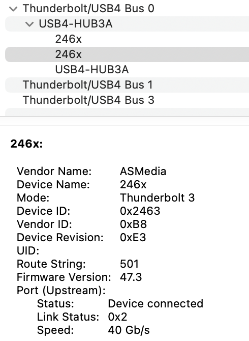

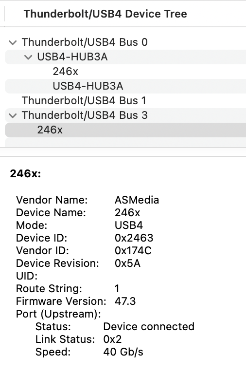

As mentioned, I was running the Samsung 990 Pro directly connected to the Mac mini initially, in a Qwiizlab USB4/TB enclosure. It was connected like this for about 6 weeks before I decided to run it through the TB 4 hub instead. See below.
This is connected directly to Mac mini. The drive is detected as USB 4. No random disconnects.
This is connected through a Thunderbolt 4 hub. The drive is detected as TB 3 and idles at lower power this way.
