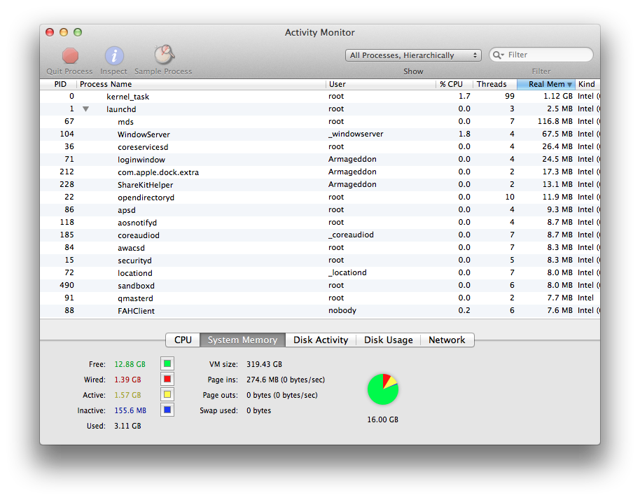

Check Activity Monitor, post screenshot of your RAM usage. If OS X is writing to the hard-drive then that'll really slow down your computer. Look for the bit that says 'Swap used'.
If it is writing to the hard-drive, shut down your Mac, and disable the option that says: 'Reopen windows when logging back in'.

By "running out of RAM", do you mean you have page outs? To determine if you can benefit from more RAM, launch Activity Monitor and click the System Memory tab at the bottom to check your page outs. Page outs are cumulative since your last restart, so the best way to check is to restart your computer and track page outs under your normal workload (the apps, browser pages and documents you normally would have open). If your page outs are significant (say 1GB or more) under normal use, you may benefit from more RAM. If your page outs are zero or very low during normal use, you probably won't see any performance improvement from adding RAM.

Alright, thanks. I'm running Mavericks now and I'm still having the slow performance. I'm certain the problem is with the Mac Mini's HDD as I can hear it clicking away intensely.
I tried looking for 'page outs' under Activity Monitor and then 'Memory' but I didn't see 'page outs' anywhere.
Follow every step of the following instructions precisely. Do not skip any steps.
  1. Launch Activity Monitor
  2. Change "My Processes" at the top to "All Processes"
  3. Click on the "% CPU" column heading once or twice, so the arrow points downward (highest values on top). (If that column isn't visible, right-click on the column headings and check it, NOT "CPU Time")
  4. Click on the System Memory tab at the bottom.
  5. Take a screen shot of the entire Activity Monitor window, then scroll down to see the rest of the list, take another screen shot
  6. Post your screenshots.

One note: You can change from "my processes" to "all process" under the view menu on the menu bar.
