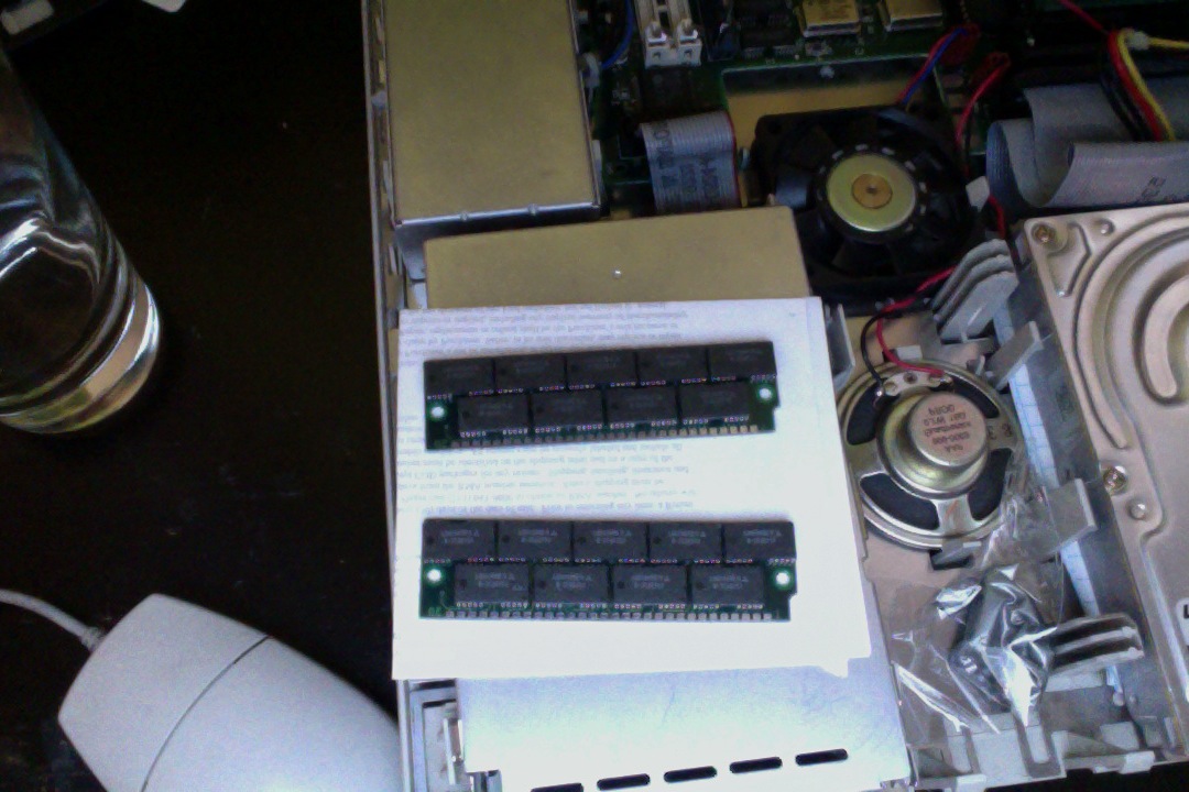

Added a picture of the RAM, It's a bit bad quality but I think you can see them pretty ok. The chips read M5M44100J 121SG7C-8, and they have the Mitsubishi logo on them.

Well, they appear to be 5V FPM which is a good start. Speed is more than adequate.

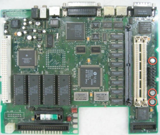

However, without other similar sized memory to test, I may have to agree with havokalien's comment about leaking SMD caps. The problem may even be etched tracks (though it shouldn't pass POST).
It's possible that the ones circled below are the culprits.

Ok, so I've looked into the capacitors and I think all of them are fine. I can't test them with a voltmeter now but none of them are leaking and I don't see any corrosion on the logic board. But I have to ask, what changed between System 6 and System 7, because the earlier one works while the newer one gets stuck on the start-up screen?
