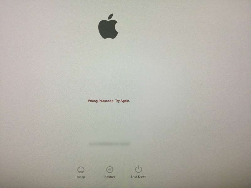

I recovered a Mac Mini that I had stolen from me in September. I had used Find My iPhone to lock it and display my phone number. Now that I have it back I can't figure out how to unlock it. I turn it on and right away it says "your password was entered incorrectly". I restart it and it says "Your Mac has been locked, try again in 60 minutes". Something to that extent anyway.
Find my iPhone just says "locating". I don't see how I'm supposed to unlock it. Anyone know what I need to do?
I've tried Internet Recovery and PRAM Reset. I can't even get to those. I only have a BT keyboard, but I think I've used them before for it. When the computer first hoots up it gives me a black screen with the Apple logo and a progress bar that takes much longer than normal.

Thanks. I was on that page. The issue is it doesn't ask me to enter a pwd, I just get a screen saying it's locked.

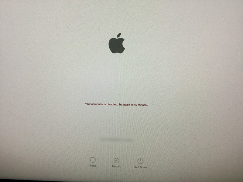

If you have made several attempts, then it will be some delay before you can even try again.
Maybe the find my mac does not show a password block when the number attempts have forced it to block you.

Thanks again. I did find that thread also. Right now I just have this. After the time is up, then it just says something about too many attempts. I'll get a pic of that too.
When the 60 minutes is up I get this screen, I can't get to any screen that allows me to enter anything.

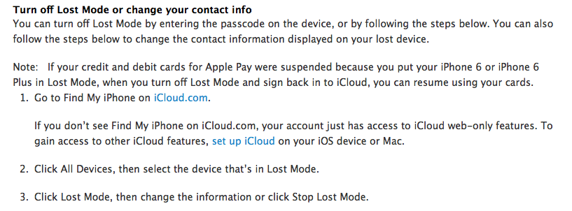

Did you try logging into icloud.com on any other Mac or PC with your Apple ID and tried this:

Did you try this?:

Maybe all you need to do is "Remove from Account"
