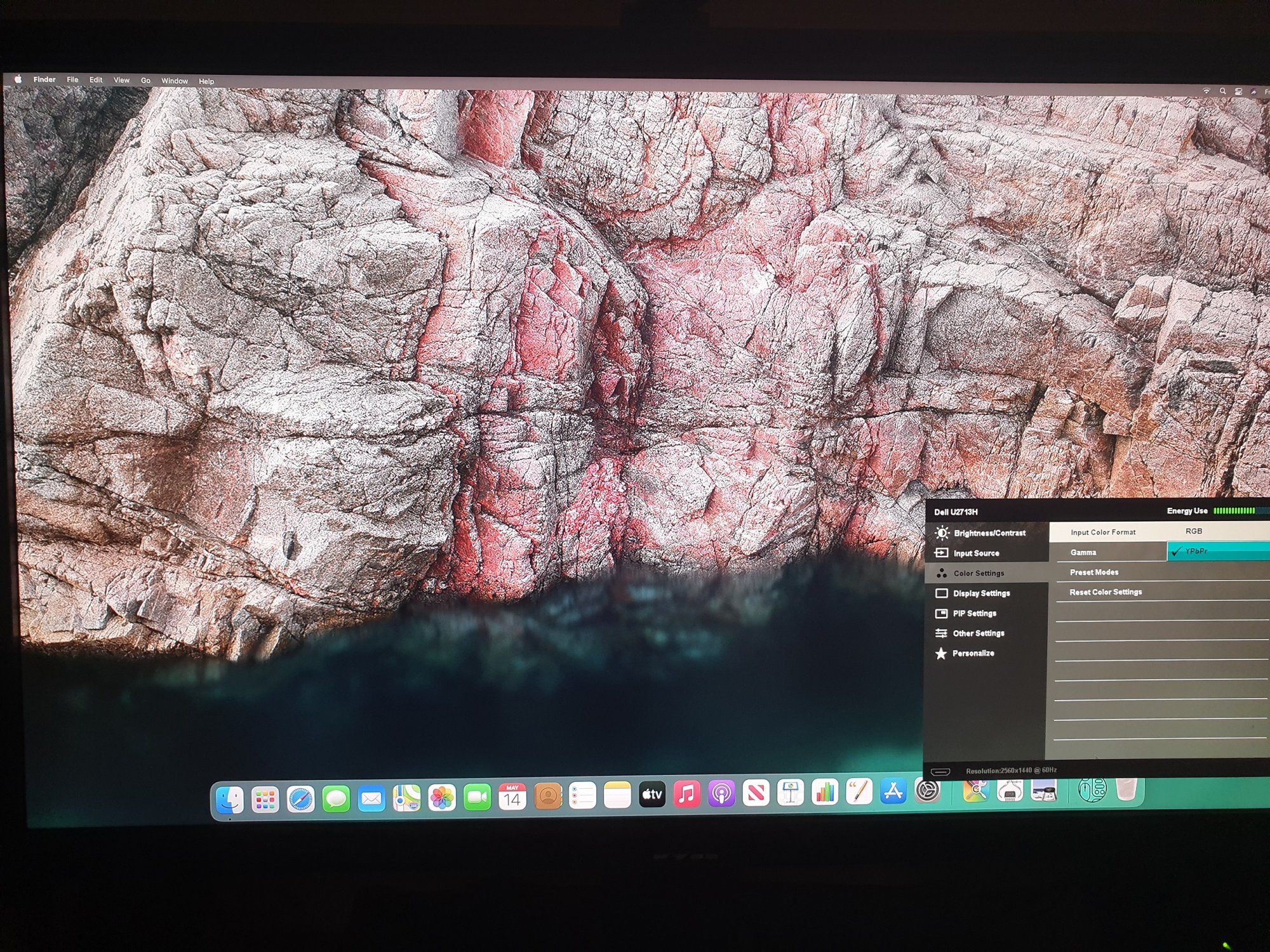

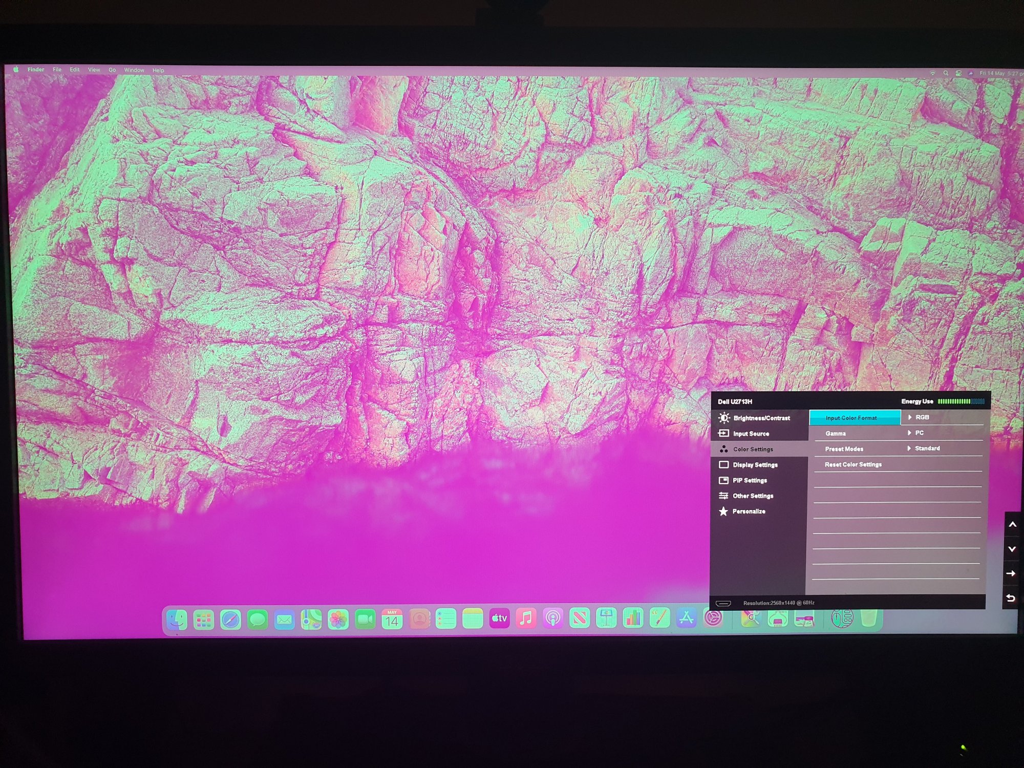

Hi everyone. I purchased a Mac Mini M1. I attached my Dell U2713H into it via HDMI. It defaults to the YPbPr color mode. In this mode, all images are grainy and the text is pixelated (Not easily visible in my screenshot, but at least it shows that the colors are fine - trust me on the font and image pixelation). I found out that RGB mode is what you want, and indeed in RGB mode, the images and text are crisp. However, the colors are all messed up. Refer to attachments for what I'm looking at. I haven't seen anyone with this issue. Anyone have any ideas on how to fixe this or if Apple is working on a solution?
I found the issue. MacOS sees the Dell display as a TV and not as an LCD monitor. The problem is that the following fix no longer works on M1 architecture:

Using a DVI display connection is a simple way to force RGB output from M1 and Intel Macs. DVI only supports RGB and does not support the use of YUV (YPbPr/YCbCr) signal types.
The Dell U2713H has a DVI Dual Link input.
A USB-C to DVI DL (dual link) adapter should work making the M1 Mac output an RGB colour signal (with full dynamic range 0-255).
Just make sure to get everything supporting Dual Link DVI in your case as it is needed for the 2560 x 1440 resolution of your monitor. The DVI cable also needs to be dual link compatible. Downside is that it may be expensive. Try to find a USB-C adapter with Mac compatibility.

The advantage of using RGB is that usually avoids the limited dynamic range (16-235) output with YPbPr/YCbCr signal types on macOS. A limited dynamic range is meant for TVs. That can cause issues like a washed out image, gradient banding etc and should not be used on most monitors.
