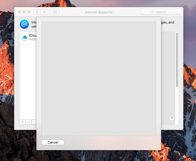

OK got issues now! I deleted the account as suggested following those instructions, but now I can't re-add my Google account. The little pop up box just goes grey after I enter my password and nothing happens.
Any help??

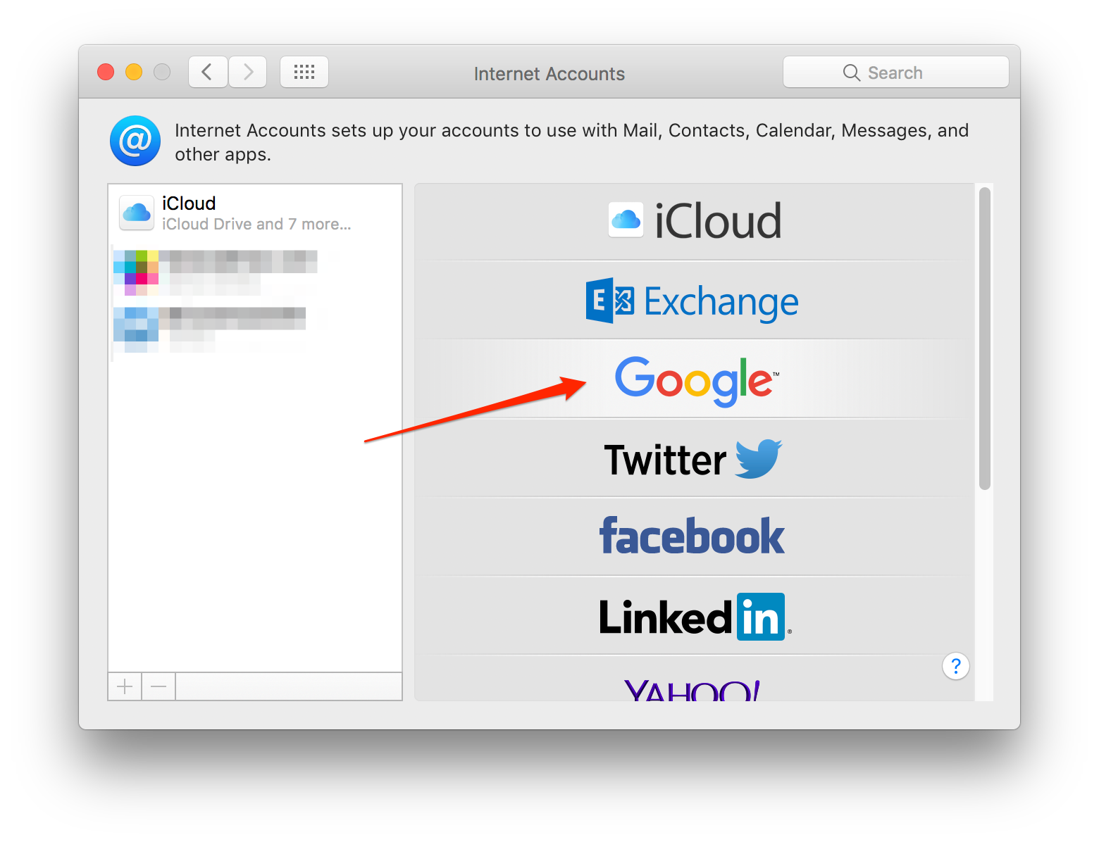

Is this where you are trying to add the account?
Reactions: CoastalOR

Yeah that's where I'm trying to attach it, and then after I enter my password I just get this screen. I do indeed have IMAP enabled, but will have a check ref the multiple tag thing. Any other suggestions? Help is much appreciated.
