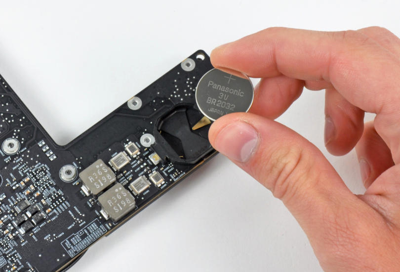

How did your 2010 turn out jdryyz? I wonder what the symptoms are for a PRAM battery failure on a 2010 mini?

I was curious about the battery...since it has now been six years since the model was released. 🙂
But would a battery failure result in NO video output whatsoever? I suppose it could be stuck trying to decide where the boot drive is...but, if I hold down the option key on boot, I should be able to override and regain control. That does not work.

The battery is still a possibility. If you have tried other RAM sticks, and have tried both video out, but you DO get the boot chime, just no video..... Then I would troubleshoot that as No Power, and Apple's service manual has a step to try a logic board reset, which is disassembling to remove the battery.
So, if nothing else has helped, try removing the battery from the logic board, leave it out for at least one minute, then reinsert, reassemble your mini, and try the boot again.
Test the battery. If it is 2.7 volts or LESS, then replace the battery with new. Or, you might just replace the battery with new, regardless of how it tests, when you already have your mini opened up. 😀
The important step is to leave the battery out for at least a minute before reassembling.

Yeah, if I going to be disassembling this much to get to the battery, I will just replace it. 🙂
I may have to invest in one of those lighted magnifying lenses because working on a Unibody mini can be a pain with all the connections that can break. I have worked on all minis before the Unibody model without trouble.

I successfully performed surgery on this delicate Mac and replaced the battery. The existing one measured 2.7v so it was possible that the battery was causing trouble, but still no video and keyboard response with a fresh battery installed. I made sure to pull my drive and got to the data I needed. No problem accessing the drive, by the way.
Guess I can sell it for parts. 🙁
