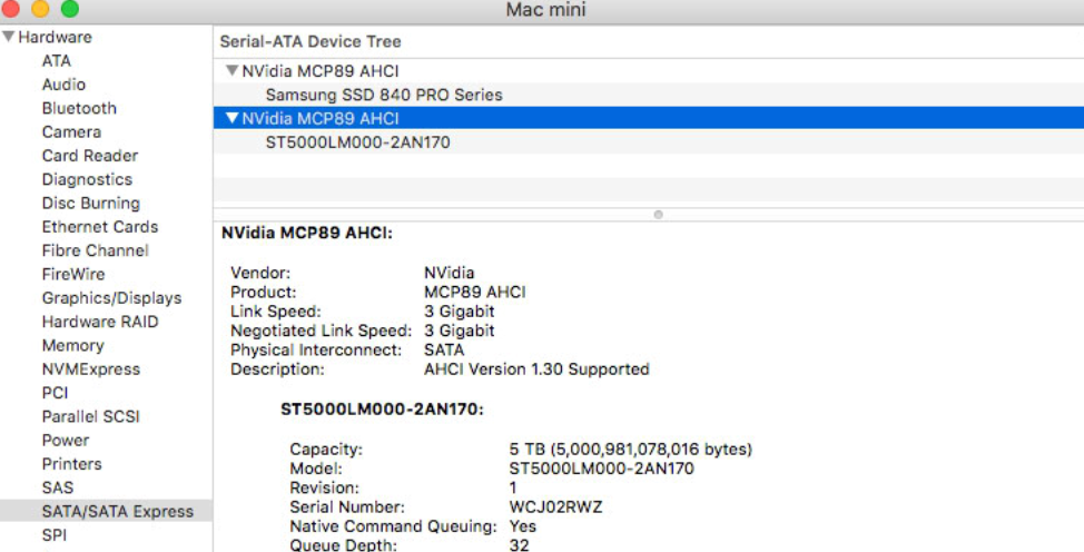

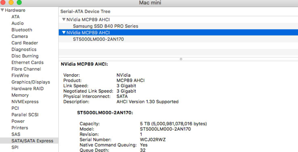

So i more or less did a heat test on the Mini wenn i transferred 1,85TB of media files from my old Mini to the new one. It was done by Thunderbolt cable. As the HDD sits in the upper slot the heat will move on to the Mini's alu case and it did just that. It got hot but not more then i still could lay my hand on it with out burning it. My old Mini also got hot too and felt much the same on both wenn i touched the top of the case. The fan was not as loud on the 2012 Mini as it can be on my old 2011 i5 Mini wenn playing movies on it.
I would say it passed the test. I for one will not transfer that big of a data load on a regular basics so i am very pleased with it.
I placed the HDD in the top spot and the SSD in the lower. I wanted the HDD to transfer the heat, if any to the alu case. I had to bend the cables sometimes to get it to the right length and fit. But I managede to get it right.
I will post pic's later 🙂 :apple:

My i7 is not the server model. As i understand it the only things that are different between the non server and the server model is that the server model comes with the extra sata cable and HDD. Besiddes the 2.3GHz vs. 2.6GHz.
I did not modifi anything on my i7. Just added the sata cable and the 15mm HDD. I did not screw the HDD in place just placed it in the HDD caddy. It can move if i shake my i7, so no tape either. There is not much room fore the two drives to move around.
Yes i reused the upper cable and got the lower cable from iFixit.

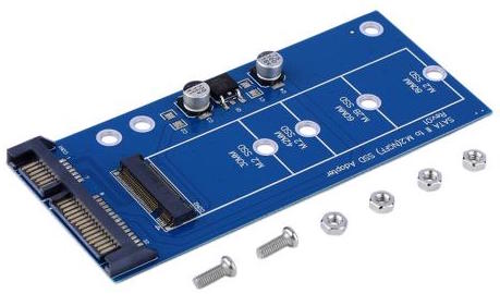

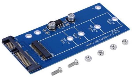

I wonder if it might be easier to buy an m.2 SSD and an m.2 to SATA adapter like this one. That should be less than 7.5 mm and free up space for 15mm hard drives.
As i see it You dont want more space between the drives as You cant screw the drives in, so the more space the drives can move around in the mini.
The combo of a 7mm ssd and 15mm HDD fits snug and can not move that much around in the mini.

I found this thread a week ago. Today I have a 2011 Mini (non-server, i7) I bought from eBay now running with a 5TB hybrid drive 🙂
Thanks to everyone on the thread.
I made one modification to the plan above. I found that with my 7mm SSD and 15mm 5TB drives, there was still a bit too much "play." So I used a "Silicon Laptop Hard Drive Protector Sleeve" that I cut in half, sandwiched in between the two drives. This soft/pliable spacer should reduce shock/vibration and it takes up the extraneous space.
I ordered a cable from owc for the 5TB drive in the lower bay, it worked fine.
The machine has been running great for four days.

I misspoke - it was the "lower" bay when I had it upside down, but it is actually the "upper" bay according to the official definition. It is in direct contact with the aluminum case, so it has a good heat sink.
