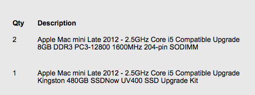

I have a similar issue:
I will attach the files of what I am running:
I bought this almost two years ago:
I installed the SSD and no issue yet (that I know of) etc
However this morning my machine froze, the screen essentially "glitched" (for want of a better term) and then started to Beep 3 times.
As you can imagine, my underwear turned a different colour....
So after a quick google search I luckily had the original Ram, reinstalled it and it's working again (for now).
