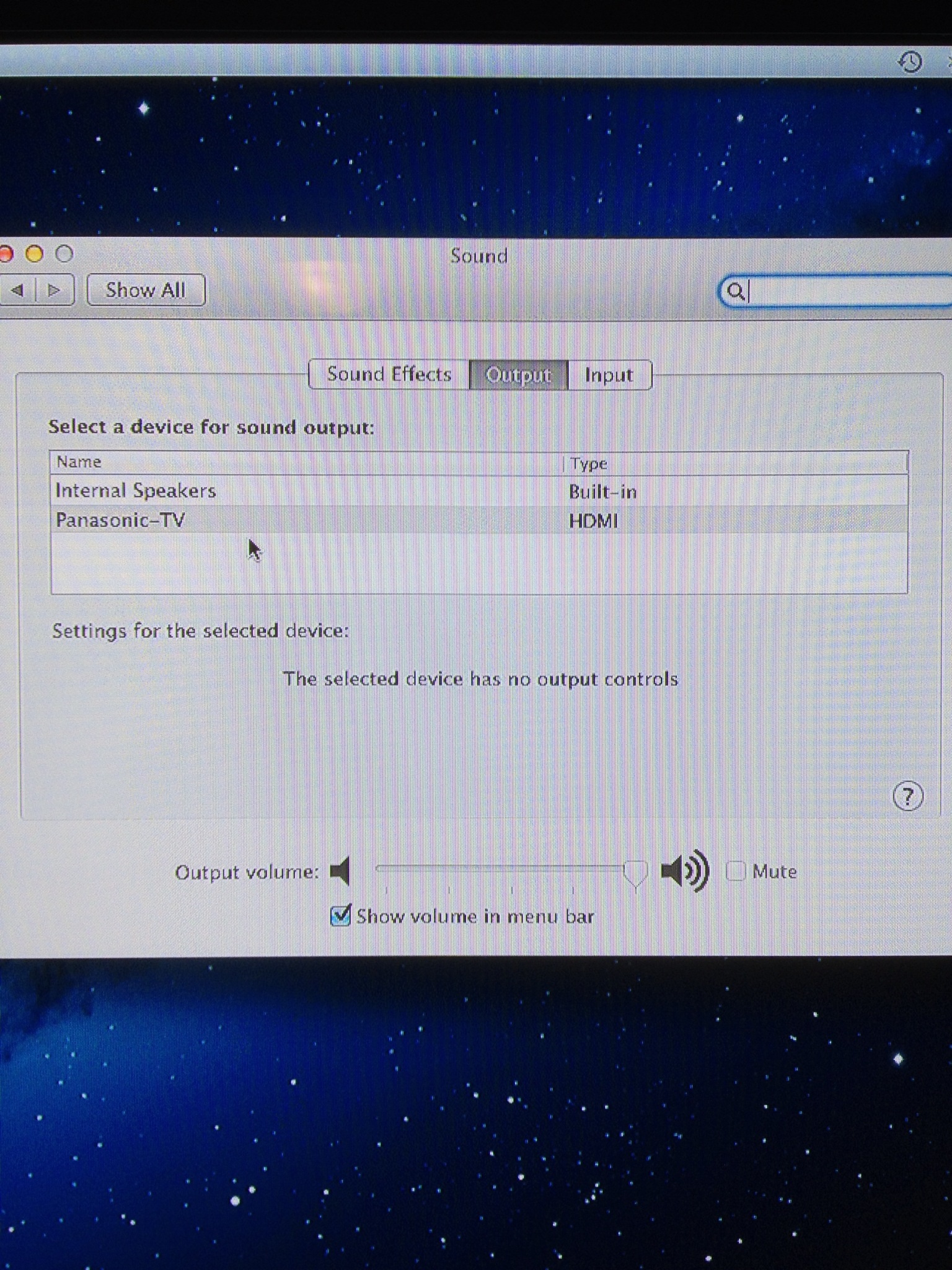

I have read many forums and searched the internet, but I can't find someone with the same issue. I have a 2011 mac mini 2.3ghz 8gb ram connected to my yamaha rx-v373 via hdmi. Then yamaha receiver to 65 panasonic viera plasma tv via hdmi. In system preferences and midi audio it only shows the panasonic tv as the sound output option. The sound still goes through my receiver as pcm not dolby didgital or dts. When I use PLEX or VLC I can get DTS because of the audio setting in these media players.

The HDMI is an Audio OUT on the Mac Mini. This means you have to connect the HDMI to Receiver's HDMI IN. The use one the HDMI OUTS to you TV. Then in system Preferences->Sound, OUTPUT mini-tab select the HDMI sound out.
Is This the way your are setup?
I have it set up as you described but the tv shows as the hdmi option

Is the receiver turn on and the correct HDMI port you connected the Macs output to? A lot of receivers don't passthrough HDMI when off.
