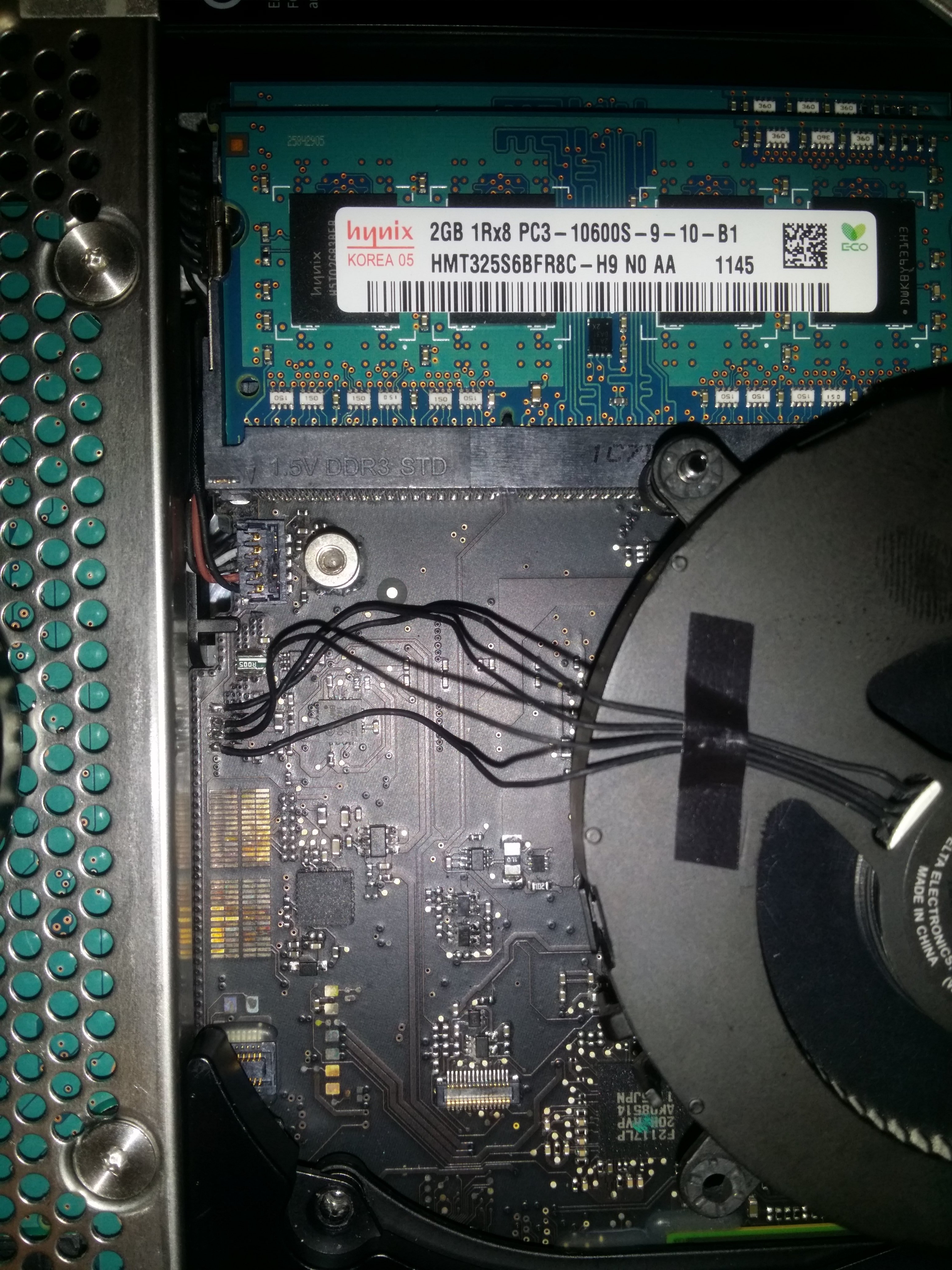

Now my FAN is running at 6500 RPM at alltime. I tried to download a ton of fan controlling programs to set the speed manually, but they have no impact on the fan speed. The Person who soldered it for me did it under microscope and guaranteed that there is no connection between the wires (He Checked twice).

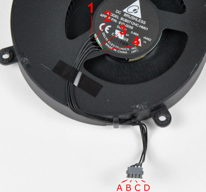

One of the Pictures I have attached is showing where I had the wires soldered. Is that the right order?
And the other picture shows my Mac mini after its soldered.

it seems that you have the 1234 and abcd wrong, 1 should be going to the bottom instead of the top. hope this pic will help.
