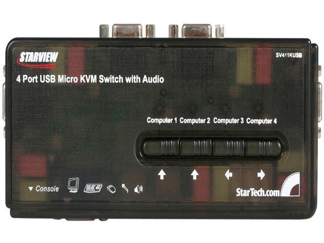

Assuming if you want to share a single audio source as well. StarTech offers multiple models with different display connections.
