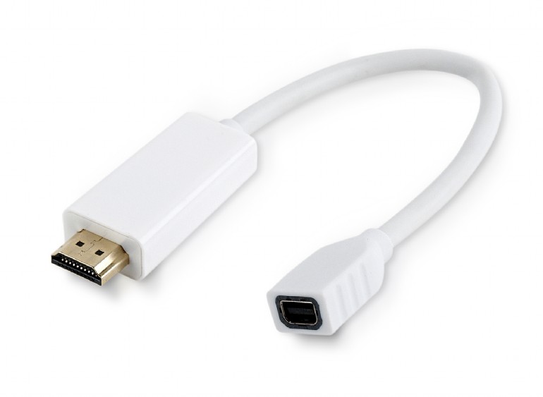

Here is a picture of that adapter I bought.

HDMI <-> Displayport (or MiniDisplayport) adapters are not bi-directional. So you need to find one that goes from HDMI to Displayport. Those that I see have a separate USB-A connector that the adapter requires for power. A couple that I see on Amazon are from Cable Matters and gofanco and go for about $38. Read the specs to make sure it works for your situation.
Hmmm.. Ok. What can I do with that adapter I already bought? Is that even supposed to work in any situation?

The Cable Matters adapter is the other adapter.
https://www.amazon.com/Cable-Matters-DisplayPort-Adapter-Supporting/dp/B00JQORLCG
This one has better reviews but you can compare the two and make a choice. In searching the reviews for "Mac", one review of the Cable Matters adapter said it worked on two Mini's one review for the gofanco said it didn't work past 30Hz but they were short on specifics so it's hard to say what's going on in either case.
I would say to avoid adding adapters but you probably already have the MDP-MDP cable but not a DP-MDP cable so try the MDP-DP adapter in your link and see if it works. There's nothing special about such an adapter but you are pushing a lot of data to the monitor so if the quality of the adapter isn't good, there could be some problems.
As for the adapter you have, I would guess that it's meant to be a HDMI-to-MiniDisplayport adapter with the adapter connected to the monitor, rather than the computer.

It is so hard to find anything that has female mini-DisplayPort in it. I found just one seller who had that mDP-HDMI adapter and it was pretty expensive. Like $40.
I do have few DP-MDP cables and DP-DP cables but the problem is that Cinema Display has built-in mini-DisPlayPort cable in it and that is the only port it has. If I could just use HDMI cable with that screen, there would not be any kind of problem.
In looking at the specs for the Cinema Display, I missed that it comes with the cable attached directly to the monitor in which case, definitely, try the adapter and see if it works together with the other adapter.
I haven't been able tp find an adapter like that (HDMI male to mini-DP female) anywhere, and believe me I've tried. Do you a have a brand name, description of the name, website link, webpage of the store where you bought it?
I bought it from eBay. I checked but couldn't find the seller or similar products anymore. When I press 'Find similar' in eBay the search term is 'Gembird Kabel/adapter mini DisplayPort (F) na HDMI (M)'
So the brand name is most likely Gembird. Iirc the seller was from Poland and if you do Google search with that search term you'll find this site which is also Polish. Could be the same seller. I don't speak polish so I have no idea if they still have those or if you even can buy anything from that site.
EDIT: I managed to find the seller from eBay.
Thank you. Much appreciated. I should be able to take it from here.
