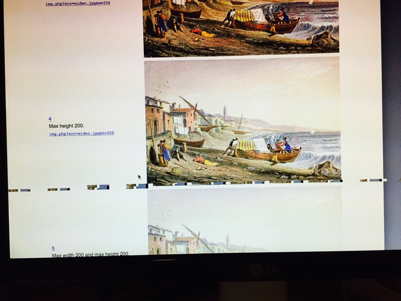

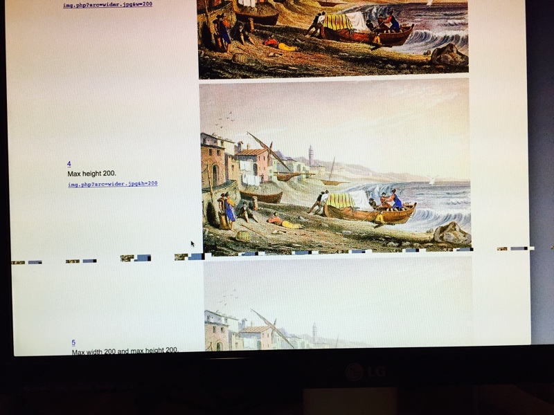

since latest upgrade to 10.10.3 + update fix i get on both monitor some sort of random square pixel row, like when you see digital tv with bad signal
i never noticed before 10.10.3 upgrade but even after latest fix i still have the issue
could it be a video card hardware problem?

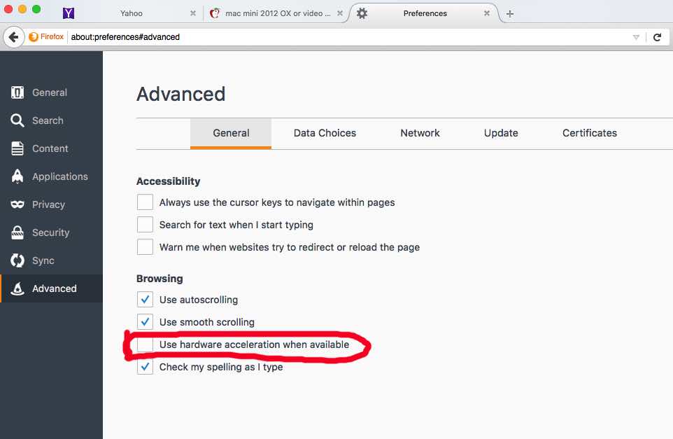

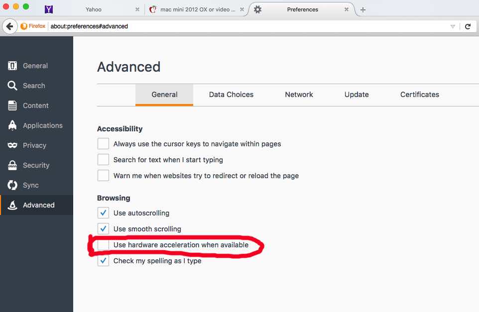

I found something that 100% fixed it... In firefox just turn off hardware acceleration. Ever since I did that the glitches want away completely.
For me, in watching about 45 minutes of YouTube videos without hardware acceleration, the problem does not occur. With it on, it started about 13 minutes in. Good find, Jig3n.

So, to summarize, you can fix these problems in Firefox by:
1. Disabling Flash (Tools -> Add-ons -> Plugins -> Set "Shockwave Flash" to "Never Activate")
and/or
2. Turning Off Hardware Acceleration (Firefox -> Preferences - > Advanced -> General -> Deselect "Use hardware acceleration when available")
in my case i just get the annoying thing that you can see on post #2
no slow down, no reboot or other issue
did you get the same stripes on your monitor?
how many monitor do you have?
