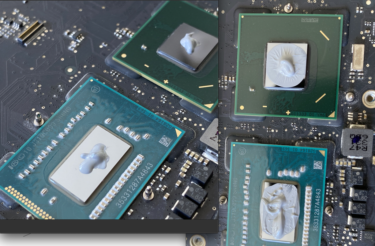

About the thermal paste.
I have done a couple of Mac Mini 2012 repastes too, and I assume that the gap between the processor and GPU is determined by the attaching screws, then they reach the bottom of the thread. It's hard to measure the gap, but it seems it's not exactly leveled between the two contact surfaces either. If system/OS reinstall does not help, I'd go and check the paste once more. I would put "enough" of it, and I would use liquid enough paste so that it spreads through the contact surface evenly and every sqm of it. I don't think it's harmfull if it reaches over the edge a little bit.
I did a test fit with some paste, and reacted to that (see picture) with a little bit more paste with my actual install. It seems the gap would be a little bit higher than what I have been used to see with Mac Pro 2009-2010 CPUs. That's why a little bit more paste is needed.
Left pic, first time paste. Right pic, first time + then some additional to reach the edges of the chips too.
