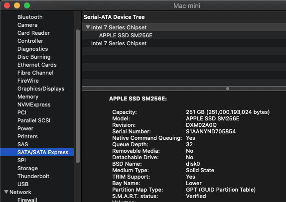

FWIW, this is the original Apple 256gb SSD in my 2012 Mini (as per System Information)
Reactions: adamcarvell

Does that System Information window show ANYTHING about the volumes on that SSD. Can't scroll down through the screenshot!
