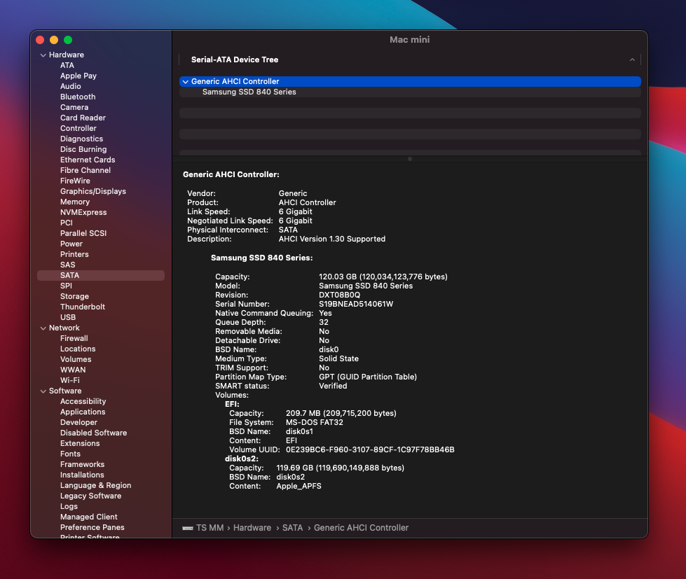

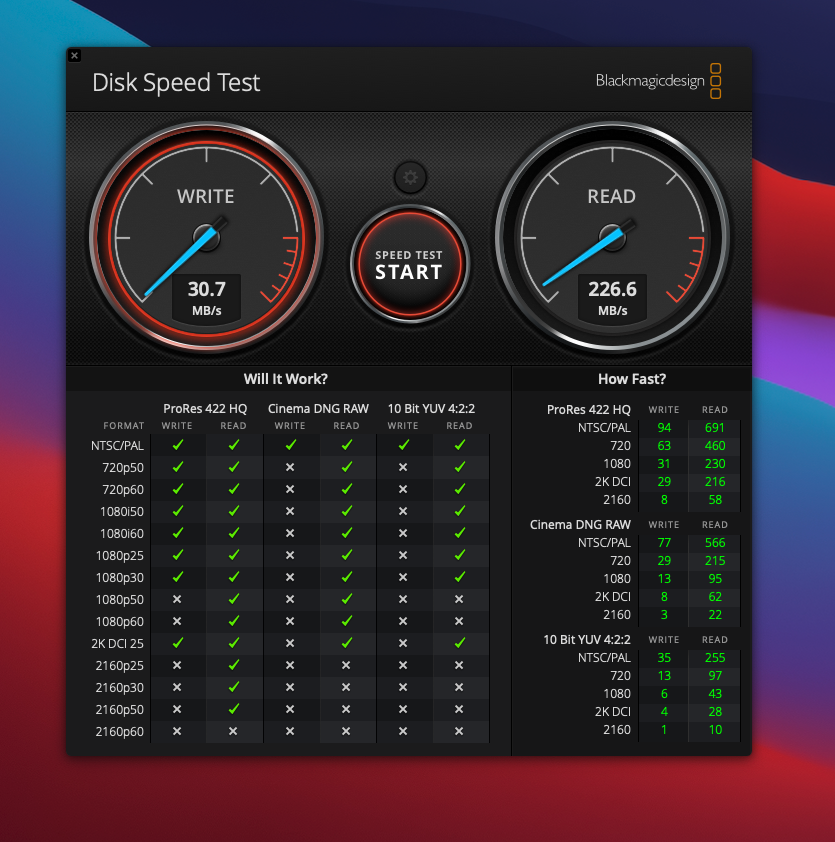

I just replaced my internal 1TB HD with a cheap Samsung 120GB 840. It's got a clean install of Big Sur on it. To be honest I was expecting better speeds. I'm getting around "30MB/s" for write speeds and maximum "300MB/s" for read. It's not nvme, but I was expecting better than that.
Am I missing something?

Was the 840 used?
Also, you need to enable TRIM:
You do it with terminal, but it is crazy easy to do so.
Enable TRIM and run the tests again. There could be an improvement.

I bet TRIM is your issue.
While you would think that TRIM would impact only when writing, I have seen people have issues with both reads and writes and used my suggestion of enabling TRIM, and it fixed both reads and writes.

It's APFS formatted. Thanks I enabled TRIM and the speeds have gone way up. But I'm still only getting max write speeds of 130MB/s. Read speeds hover around 500MB/s which is what I'd expect. Shouldn't I be getting higher than 130MB/s for write speeds though?
This is the high end of what I would expect from a brand new SATA SSD.
500MBps is a great speed for a used SSD.
This is still a little low, but it could be due to the age of the SSD.
Also, if the SSD was used as a USB drive for MacOS, or just used without TRIM enabled on any OS, this speeds up the aging of the SSD.
Another issue that could be affecting speed would be indexing. If you just installed the OS, this might last a day or two.
You could check the SMART status of the drive to see if it is having any issues.
Terminal could be used to check out the number of writes on the drive.
There are a few apps out there that will give you more information than Terminal, and also give you an estimated level of wear on the SSD.

Hey thanks. SMART is all good, but I'll check on the write count in Terminal later. I'll be honest I didn't even consider the wear and slowing down of the disk from use, but I think you're probably right. It's a good lesson for me in sourcing future disks.
I am not sure if you are coming from a HDD, but the majority of the SSD experience comes from the reads and the faster response time, so unless you are doing something that you need that faster write speed, you would probably not really notice the slower write speed.
