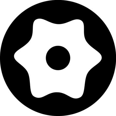

My only worry is that since these are security screws there is a centre piece.
oh boy this will be hard.
and again nowhere to get replacements 🙁

the issue is that its the smallest torx screw (T6)
Three 4.1 mm screws - these have a special head that holds the bottom plate, not worried that these are stripped, since they are sticking out i can use a pliers
Three 1.9 mm screws these are tiny! and are flush on the surface. and of course stripped 🙁

I don't have access to a Mini, so I don't know what the screws look like, if you could post a pic it would help, if they look like this ..
https://9to5mac.files.wordpress.com/2014/10/tr6.jpg?w=704&h=397
Then ..
If you feel like you can grap the screw head with a pair of pliers then that is the easiest. Small channel lock types would work well, grap and turn .. easy.
Second method would be to cut a notch in the screw head (I have used a dremel tool) and then use a flathead screwdriver to remove the screw.
Depending on how much they are stripped you could try the next biggest tool, sometimes this works good as well.
If your worried about dust, debris from the second method, you can use some masking tape to cover the exposed ports of the machine to prevent anything getting inside.
Next, I would get some normal replacement screws - probably socket/hex screws. I would stop by a hobby shop rather than a hardware store, as hobby shops have a better variety of small screws.
Something like this - http://www.amain.com/rc-cars/protek...-socket-head-cap-screws-10-ptk-h-1202/p141675
The depth of those screws on the metal cover are less than 2mm, and as posted the 3 screws that extend for plastic cover will turn out easily with a decent set of pliers (mini channel locks or vise-grips, etc). The other 3 screws may be approached as posted. These screws turn out easily so not much of a bite on them is needed to do so.
