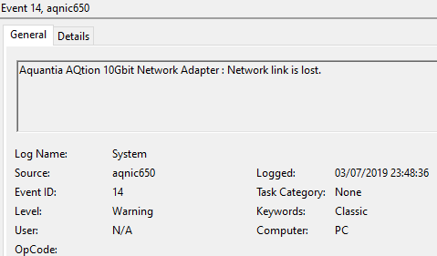

The 10GbE NIC in my mini 2018 keeps dropping the connection and stating that the cable is no longer connected when run in Windows 10 1903.
The only way to restore the connection is to power off and then power on again. A reboot does not restore the connection. I've tried the older iMac Pro driver as well as the newer Aquantia driver. All 3 drivers fail.

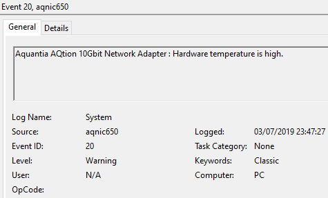

It appears as though this is due to overheating when using the NIC in BootCamp. I don't have the issue in either Mojave or Catalina DP3.
Anyone else experiencing this and does anyone have any suggestions as to how to fix?

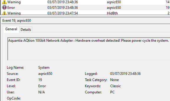

Looks like mine is overheating in boot camp too after looking at my event log - glad you pointed this out. I can’t say for sure but I don’t think this is new to 1903 so I had link losses in windows for a while now, just never realized why

Also, show them the event viewer screenshots from Windows. It's conclusive what is happening.
