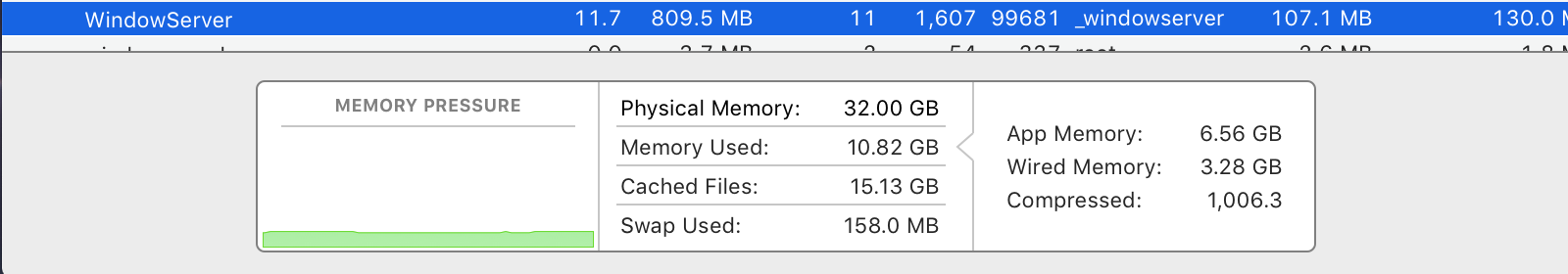

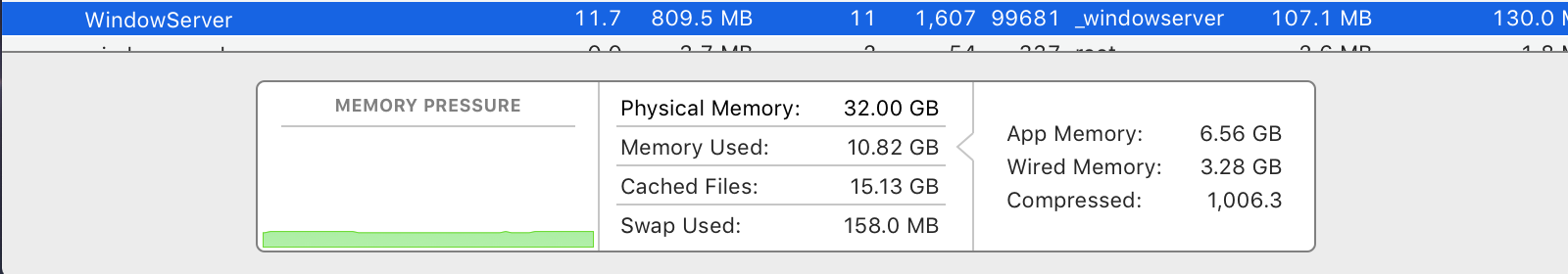

Here is RAM usage and WindowServer when idle with a 5K+4K desktop: <0.8GB for Windowserver.

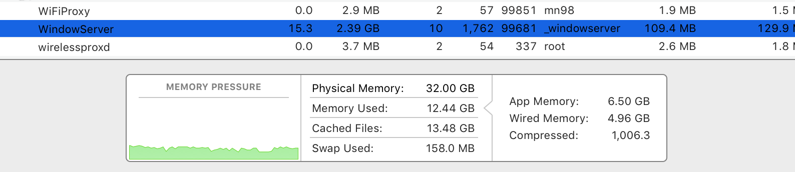

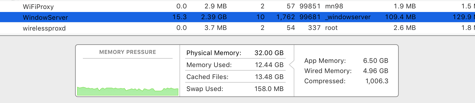

Now trigger Launchpad animation (with a nested folder): Windowserver hits 2.5GB, with wired RAM jumping ~1.7GB

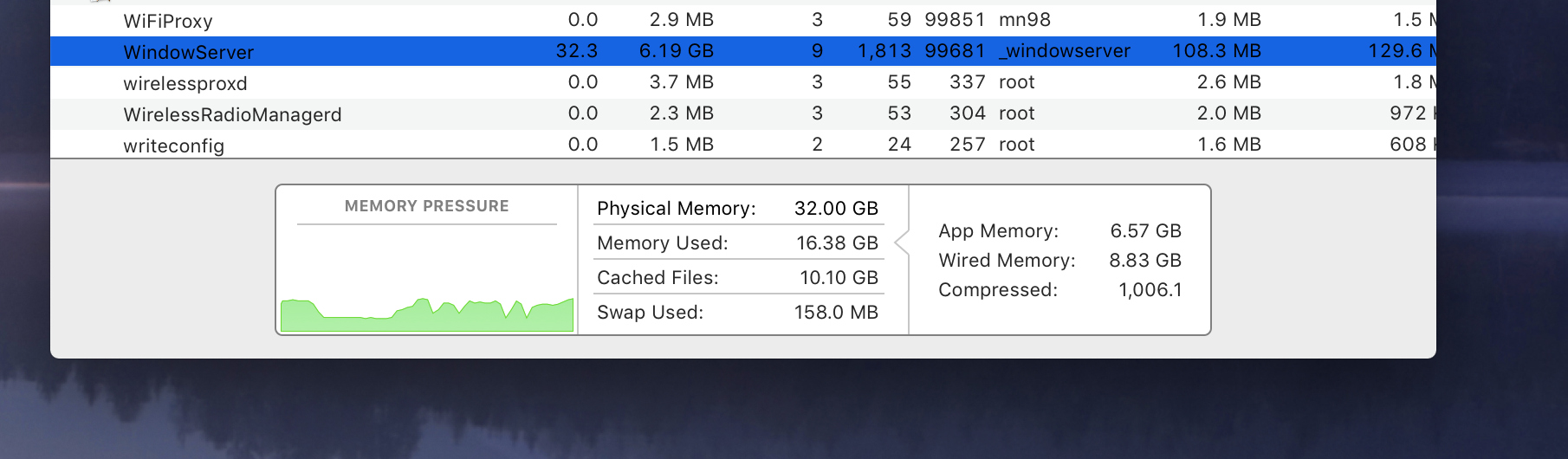

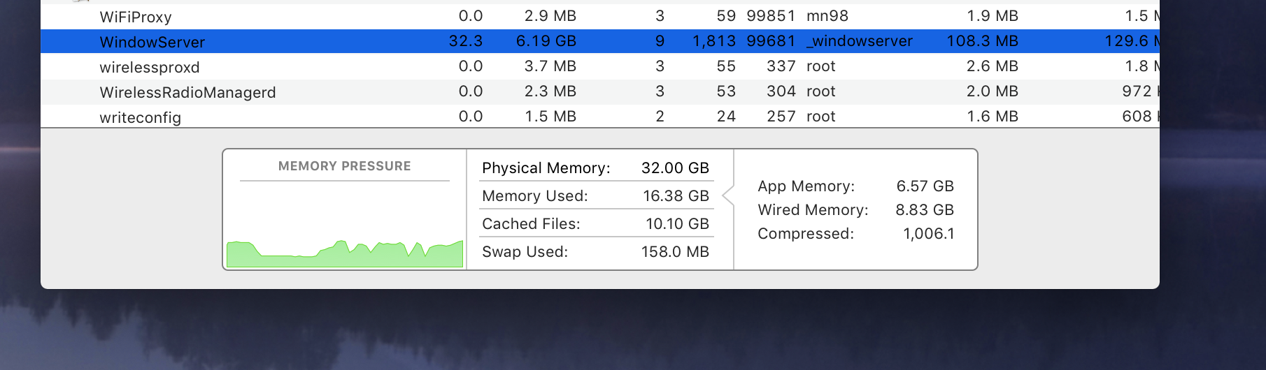

Now trigger launchpad animation (F4) in quick succession: Windowserver hits >6GB of RAM, with wired RAM peaking 5.5GB over idle.
