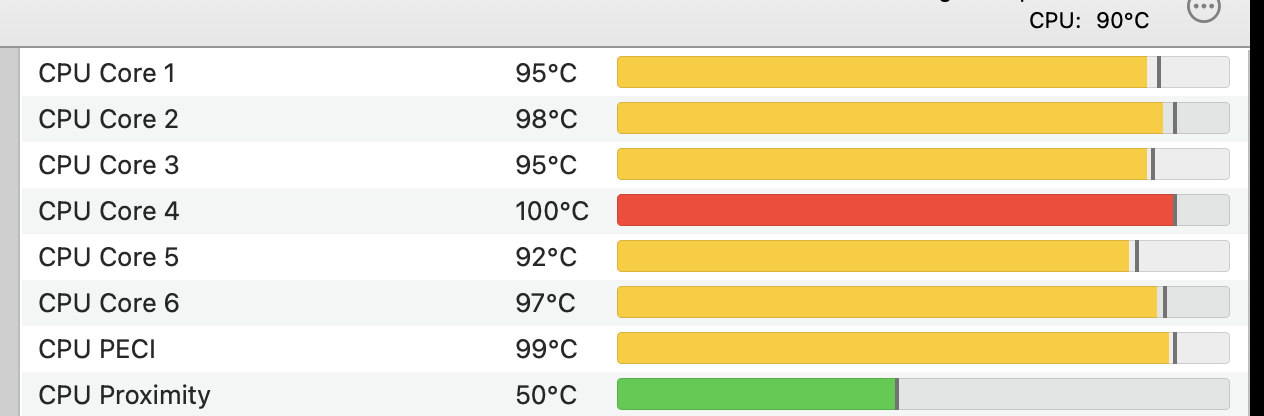

If I max out all cores on the Mini then the temps across cores aren't necessarily even. This Mini hasn't taken a fall.

Thanks, this was exactly what I was hoping for!
In my case, the difference can be larger (like about 80c in most cores, then core 4 or 6 jumps up to 100C). But the large difference only happens during heavy load. I've read about Intel CPUs a few places, and I think this is expected behaviour. I see your core 4 and 6 are also the hottest. Probably because of their placement, maybe close to the iGPU, which runs very hot (from being underpowered).
Mac Mini i7 still has plenty of power for Logic Pro, and no worries about compatibility issues, which is great. However, it can be quite noisy, if you put it on your desk by your monitor. I'm certainly in no rush to get a Mac Studio yet.
