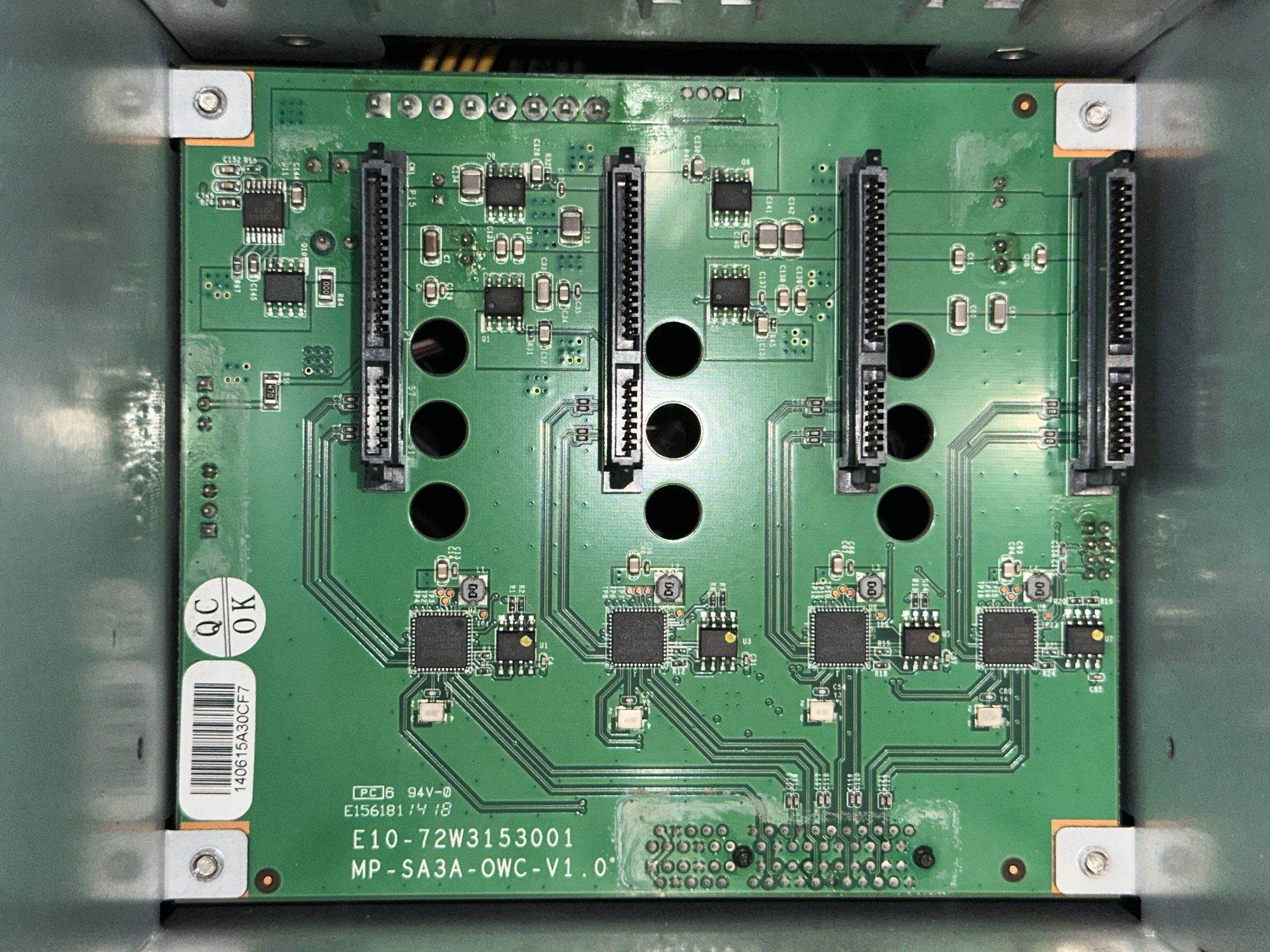

I routinely use a XPOWER Airrow Pro electric duster on the unit to keep it cooling properly. Today when I dusted I looked inside with a flashlight and I was disappointed when I opened it to see so much flux residue left over from the manufacturing process - not sure if that can be a source of problems. At the bottom of the board you can see a lot of flux residue around where the two thunderbolt connectors are on the back of the unit, but there is dried flux residue around any through-hole components.
