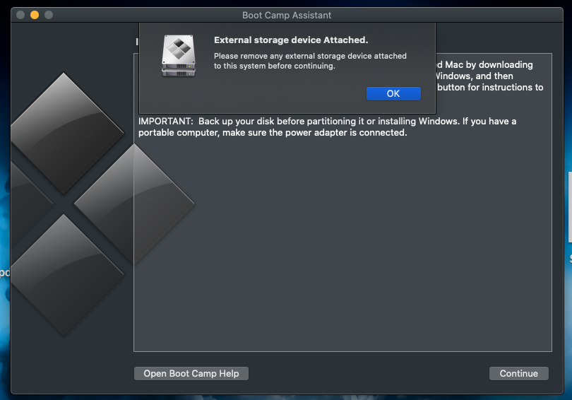

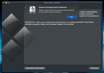

FYI... if you are like me... and intend to use your internal storage for Bootcamp, setup Bootcamp before you get rid of MacOS on the internal drive. Bootcamp Assistant won't run when you have external storage plugged into the machine... even if your boot drive is the external drive. So I used the internal MacOS installation to partition the internal drive and install Windows (I gave Windows as much as Bootcamp Assistant would allow). Then when I had Windows installed, I used a Windows based partition manager to delete the MacOS volume on the internal drive and resize the Windows partition to use up the entire 128 GB internal storage. Then, I plugged in my TB drive and was able to boot Catalina from it again using the Mac bootloader.
